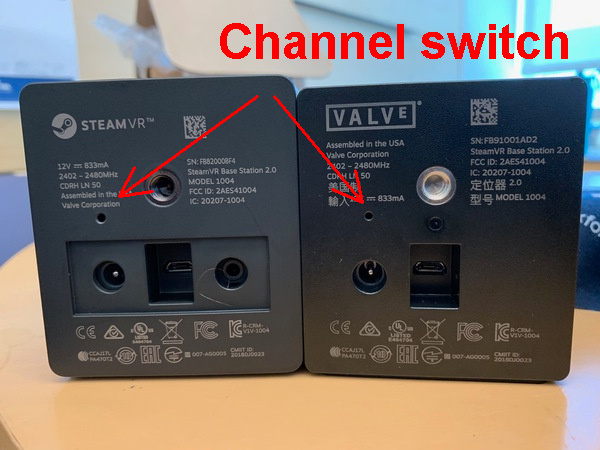

Because it has to work with all versions of the Valve 2.0 Basestations, but I know what you mean :wink:

I got my Index shortly after release (fall of last year) and my base stations say Valve on the back. I recently got a 3rd one from them last week and it also says Valve on it.
The Valve labeled ones are the most current version of of the Basestation V2’s. The fact that there is an issue with their tracking is a significant problem and needs to be addressed. We cant let this be swept under the rug.
As there isnt a big difference between how the ver 1.0 (SteamVR label) and ver 2.0 (Valve Label) of the Basestation V2’s work. So I think it should be possible to mitigate this issue via a firmware/software fix.

How can I check my base station channel?
Run SteamVR, wait for the basestation icons to light up, then hover your mouse over them one by one. The popup will tell you.
You can change channels by pressing the small button which is embedded in the back of the basestations (kind of like a reset button on a router).

Could all of you with BS2.0’s check your lighthouses.json file for the firware version.
Mine are FW 3002

Firmware 3002 for me. I also asked Steam support if there are any hardware differences between the 2 variants.
