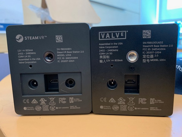

There are 2 releases of the v2.0 LHes.
Original v2 say SteamVR 2.0 have old housing with I believe unused Link cable port on back(pimax has these)
Then the Revised Ones that say Valve V2.
Led codes are a bit different ie color of led states.
yes I belive there are 2 as well.image

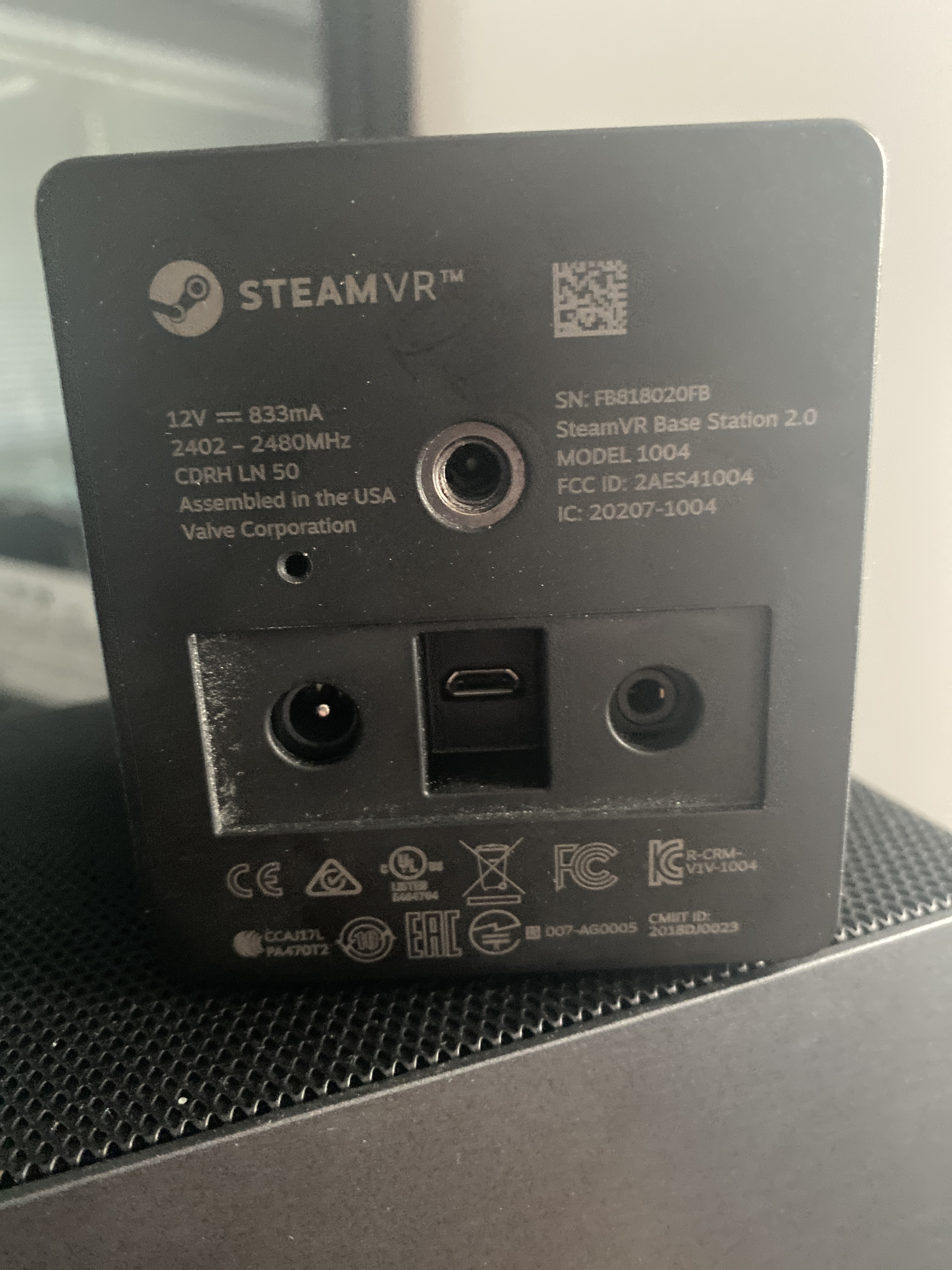

Mine is Valve “branded” like the one on the right.
Which is yours @Fomatter ?
Mine say SteamVR…
The Valve revision has some form factor improvements removal of the likely unused port. And I believe the Valve branded has slightly better fov vs og Steamvr release model.

Which BS2.0’s do you have the one on the left or the right ?

I attached that photo and raised this potential explanation of our jitter problem on my support ticket…
