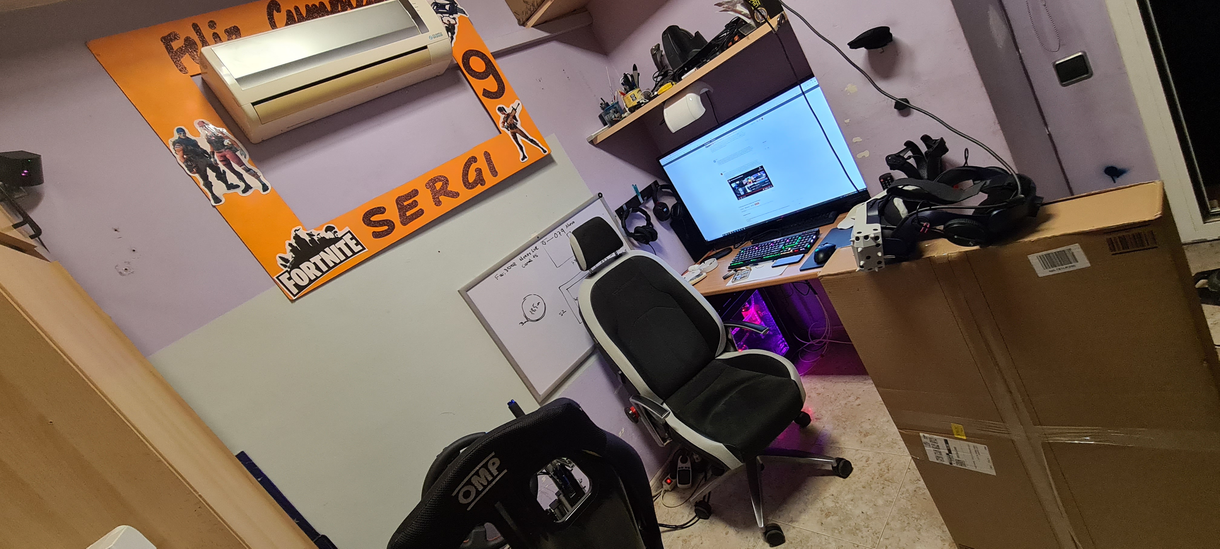

In the 2nd I have mediocre Average Rotational Deviation values, even worse than @festr, but I can assure you that I do not detect any jitter while I am playing, either Hlaf Life Alyx or Dirt Rally 2.0, that is, both in room scale games as sitting in driving simulators, I have no visible jitter. I think @festr you have good jitter values, more like NO jitter, and it can all depend on the position of both LH 2.0 in your game room or other factors as Risa2000 comments.

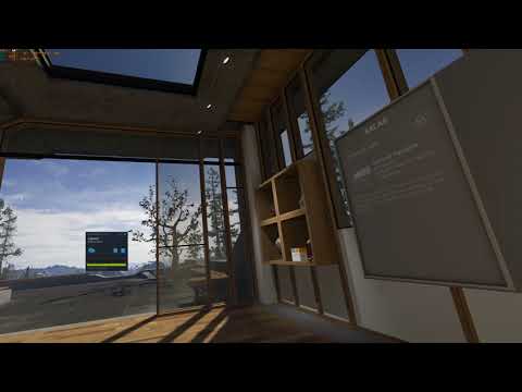

can you please make one more test - simply put your headset on some steady surface and enable screen on your monitor so you can see on PC monitor what you see - do you see any jittering move ? (the jitter is more visilble on the edges of the screen) I’m super sensitive to this jitter and I cannot stand it. If I turn off the positioning having only 9axes (builtin gyros in the HMD) its super steady obviously.
I just recorded a video with what you ask, the first impression is that there is no jitter but if you look at the upper right corner of the SteamVR status window for reference, which almost touches the tree branch, you will see a small tremor, but that when you have the HMD is not noticeable. When I know that the tracking is stable without jitter is when it goes into standby mode, in this case it was 30 seconds and it has done it perfectly.

This is my game room, as you can see it is small and complex, susceptible to interference of all kinds with so many things involved:
Ahh, it could be, although depending on the more or less stable follow-up it does not go into standby mode. But I couldn’t be sure.
Then the IMU was well calibrated, do you remember that we also gave a lot of thought to the subject to do a calibration of the IMU.
EDIT: Confirmed, it is the IMU that is in charge of entering standby mode, in the same position as before, I have covered the HMD medium to cause jitter and even an LH2.0 has disappeared for not detecting any sensor, the image showed jitter but still at 30 sec. It has entered standby mode, although it must be said that the IMU (gyroscope) is super sensitive, the slightest touch already activates the HMD again.
