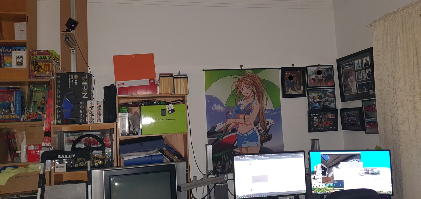

I’m thinking of buying BS 1.0 and trying that out to mitigate jitter. I sim race and my rig is very close to the wall. No controllers and don’t playing standing games atm.
How many BS 1.0s should I get? I use One Valve BS 2.0 atm but it has the jitters.
How far is your headset from the bases?
@risa2000 Here’s a couple of pics to show where the 2.0 is currently marked by the ā€œxā€ and shown in the first pic. Driver sits around 120cm from the wall.
So my rough estimate is that the headset is ~ 2,5 m from the base (sqrt(125**2 + 180**2 + 120**2)). This should not be a problem. Being too close can make the position solving difficult especially if the sensors are not correctly placed (or their position calibrated).
