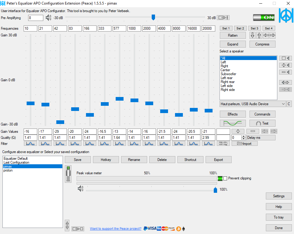

I have had the best result with Scream and Shout, this is the only song that made me dance on my chair after finding an equalization working well for me (this is the one in the picture at the top).

This is one of the strengths of this equalizer: you can manually set the frequencies of the bands you want to adjust. This is why the Tone generator and android app could still help to precisely identify an issue at a given frequency. The final equalization must still be done by ears, the generator is more about speeding up the process.
