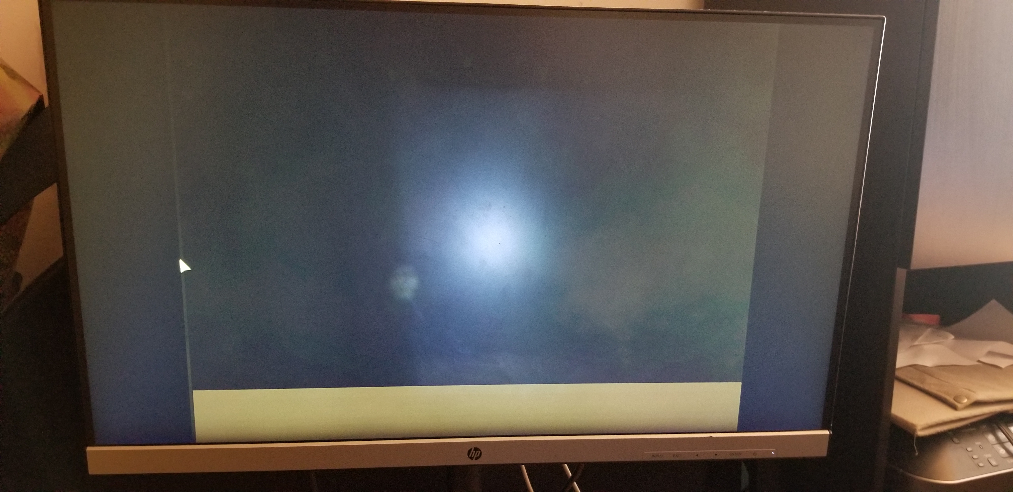

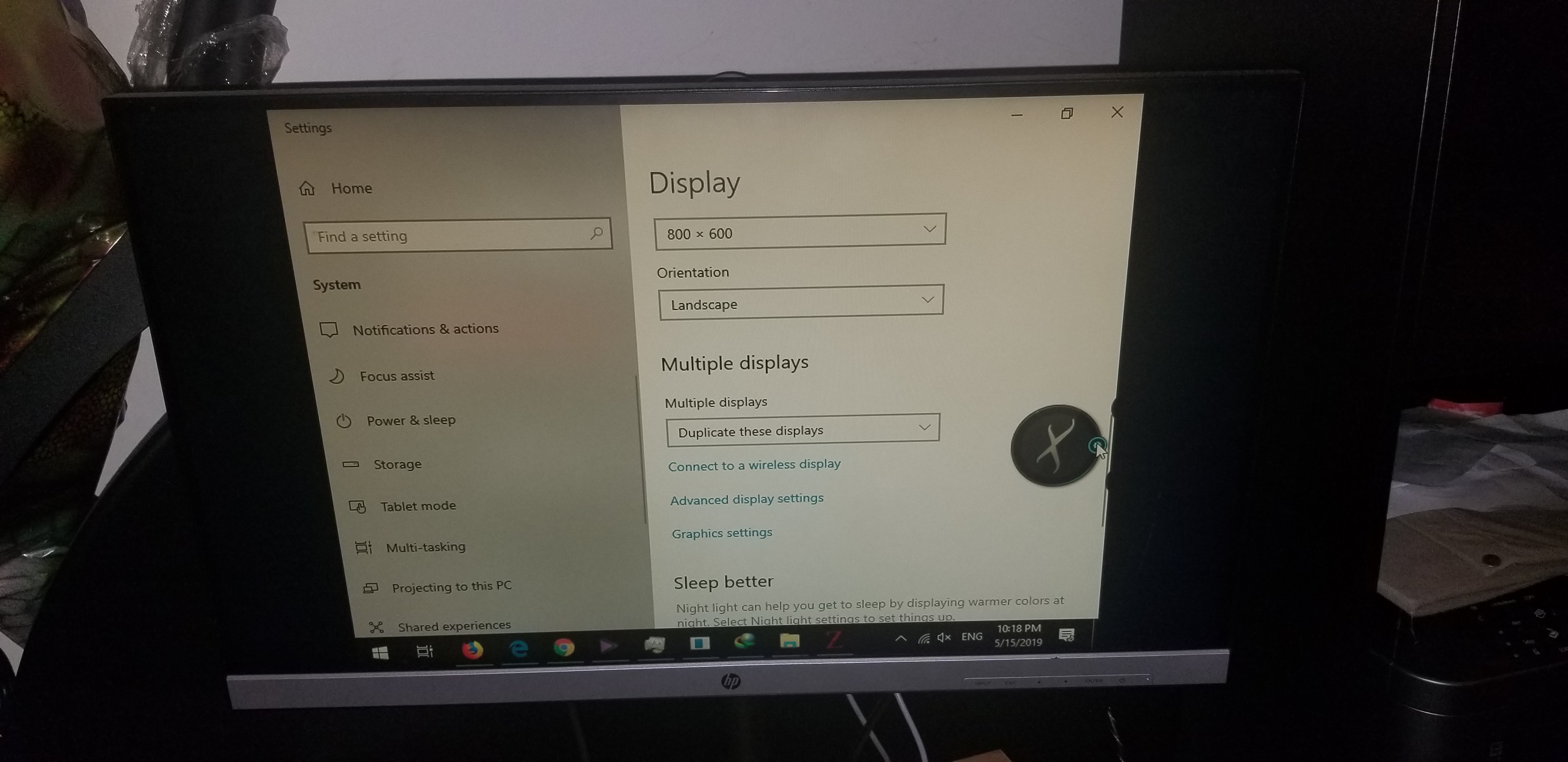

- when I set the pc video setting to “duplicate this display” to have the pc screen duplicated in the projector 's screen, the image is all shrink both on my pc and on the procetor screen
Do u have any idea how to fix that?

You may need to adjust display scaling. If you have done what we did with pimax. We turned off display scaling in Nvidia control panel. The projector likely has a feature to stretch image to fit as well.

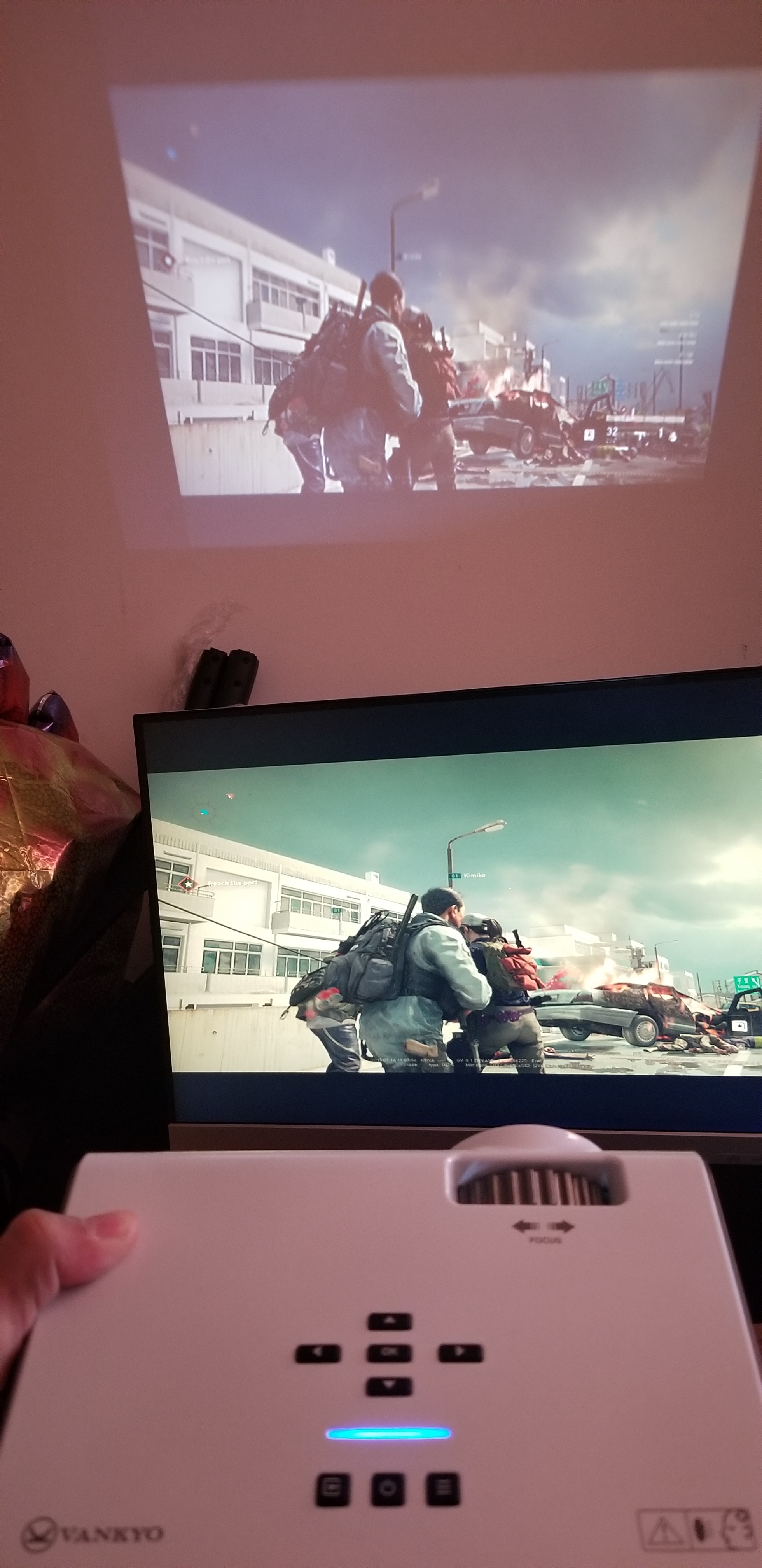

It seems your suggestion worked but the quality is horrible on the pc screen.
The moment i click on duplicate , the resolution is lowered to point that everything looks horrible on my pc screen
If it’s mirroring the projector & the projector’s native res is lower than your pc monitor. Would likely not look as good.
Oh. So what I see on my pc screen is due to the lower video quality of the projector .
Hence even the quality projected on the wall is bad because of the low quality of the projector ?
If the quality of the projector would be better the quality on my screen would be better too?
