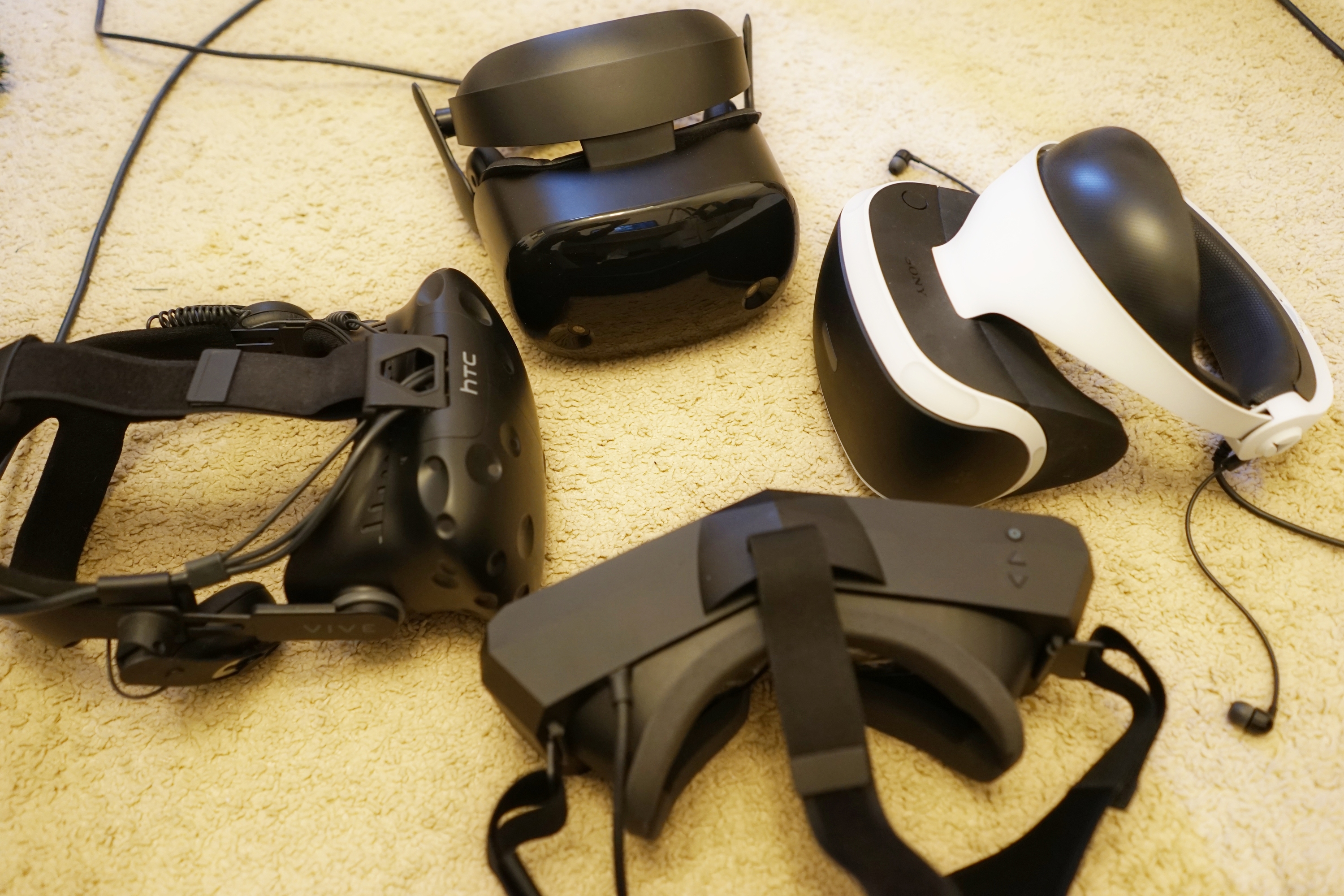

At the time of receiving the Pimax 5k+ in January 2019, I only had 3 headsets available to compare Pimax 5k+: HTC Vive, Samsung Odyssey+ and PSVR.

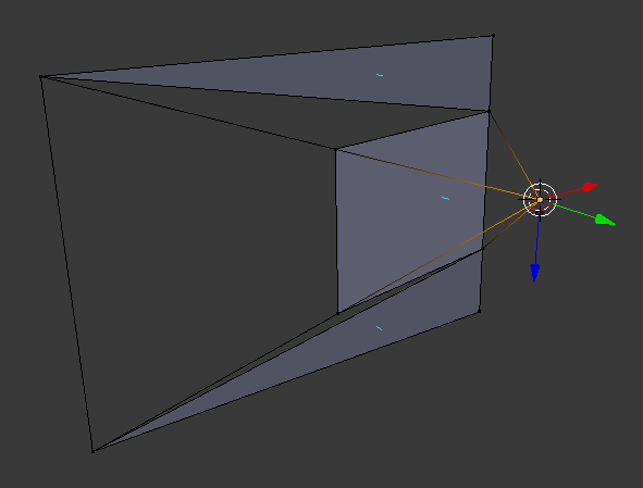

Real FOV (in-game) measurement:
I used several different applications (one of the best FOV Measuring Tool by Miami Mike) and measured the edges of the matrixes through lenses.
The total horizontal FOV consists of 3 sectors:
FOV=FOV_L+FOV_LR+FOV_R
FOV_L - part of the image visible only with the left eye
FOV_LR - part of the image visible to both eyes (stereo image)
FOV_R - part of the image visible only with the right eye
Pimax 5k+ Large Mode FOV=37+86+37= 160 deg
Pimax 5k+ Normal Mode FOV=27+86+27=140 deg
Pimax 5k+ Small Mode FOV=17+86+17=120 deg
HTC Vive FOV=9+90+9=108 deg
Oculus CV1 FOV=10+70+10=90 deg
