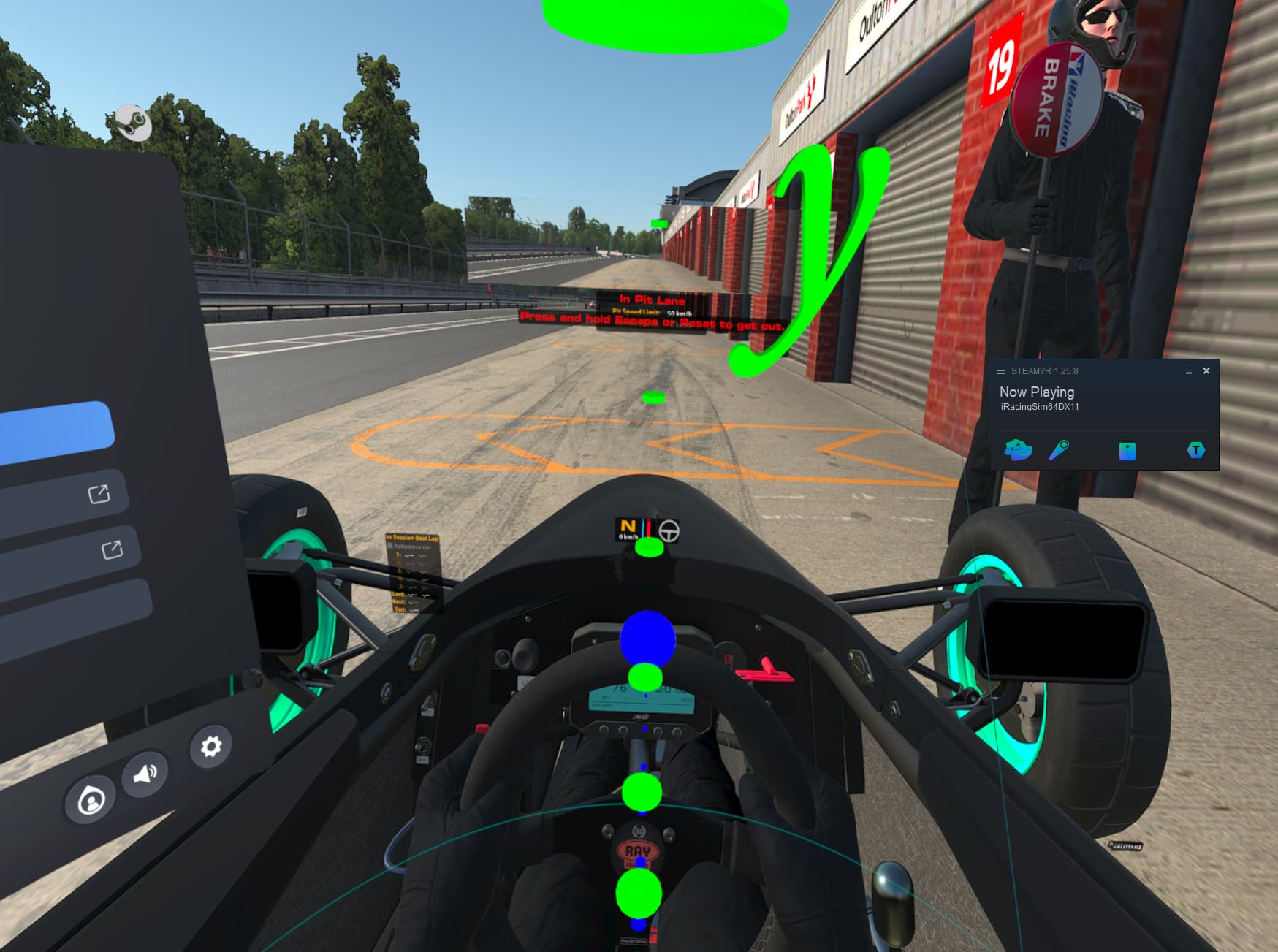

Im halfway to where I want to be. Only missing thing is locking reset HMD to direction of green line. otherwise I can calibrate near perfect with this.
