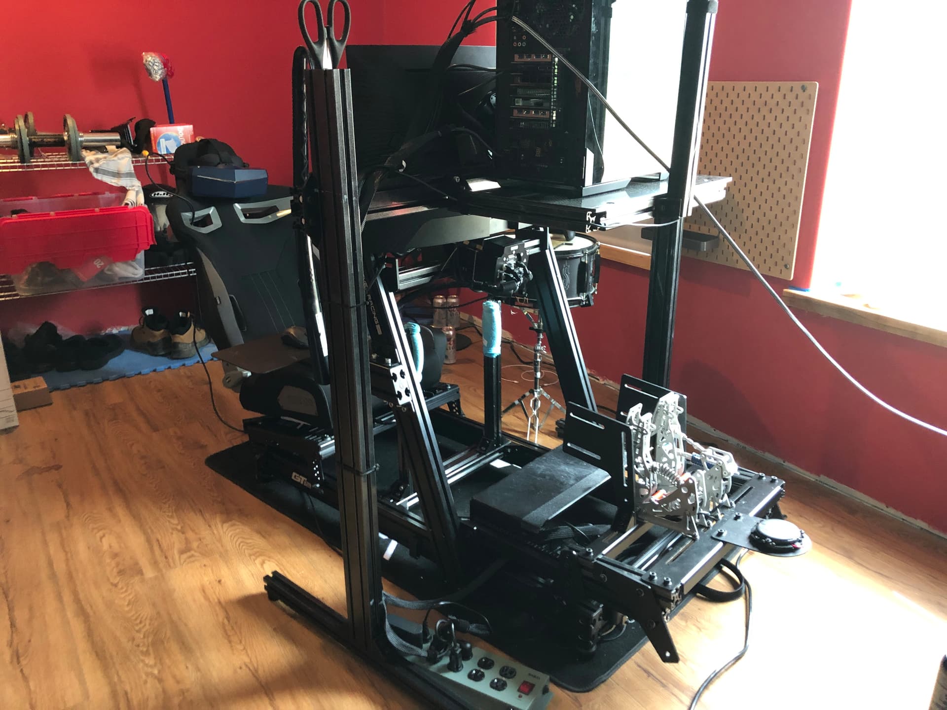

So basically I place this thing somewhere on my rig, calibrate it, and my center will always be fixed depending on the calibration of this witmotion device? BTW my rig isn’t motion. My singluar goal is to just have my car pointed the same way 24/7 so I don’t have to wiggle my head around and try to get it perfect hitting ‘recenter’ 100 times.
I want my car nose in game to always be locked to that base station in front of me (or something else) is all. You’re saying the MC stuff can help me with this then?

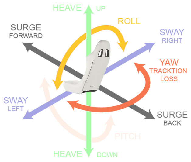

I’m really curious about this too. I also don’t have motion on my rig. But can a Vive Tracker be mounted to my wheel base, which is in front of me, and that be used to lock in the x-axis (forward/backward axis parallel with the floor)?
Dont you mean yaw? Surge being the direction your rig is facing, and the direction you want your car to face in VR. the problem is the yaw of the VR headset determining the surge direction, when surge should be in sync with your physical rigs surge
is that what you meant? describing and reading spatial problems is so hard lol
Is your problem nailing the heave to align your wheel? because mine is a problem with getting the perfect yaw so my car points in the perfect direction in sync with my rig, not a small degree off of the yaw
