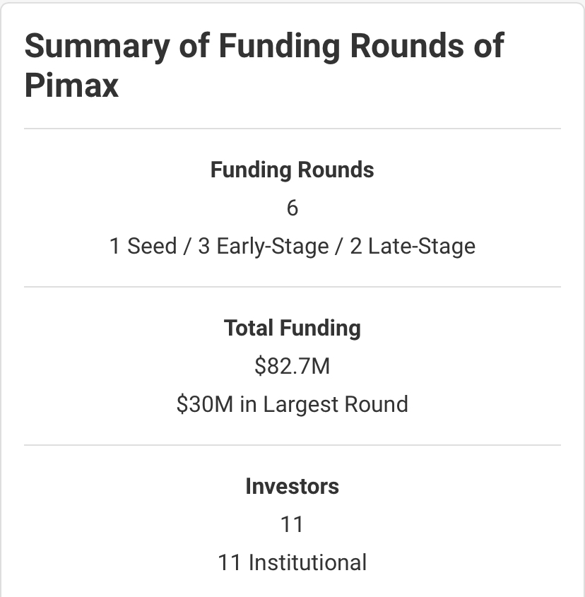

Pimax are still a non profit organisation which seeks bailouts on a regular almost clockwork cycle. The last round being 2 months ago for $14 million.
In 10 years Pimax have raised $82.7 million that’s a whopping $9million a year!
