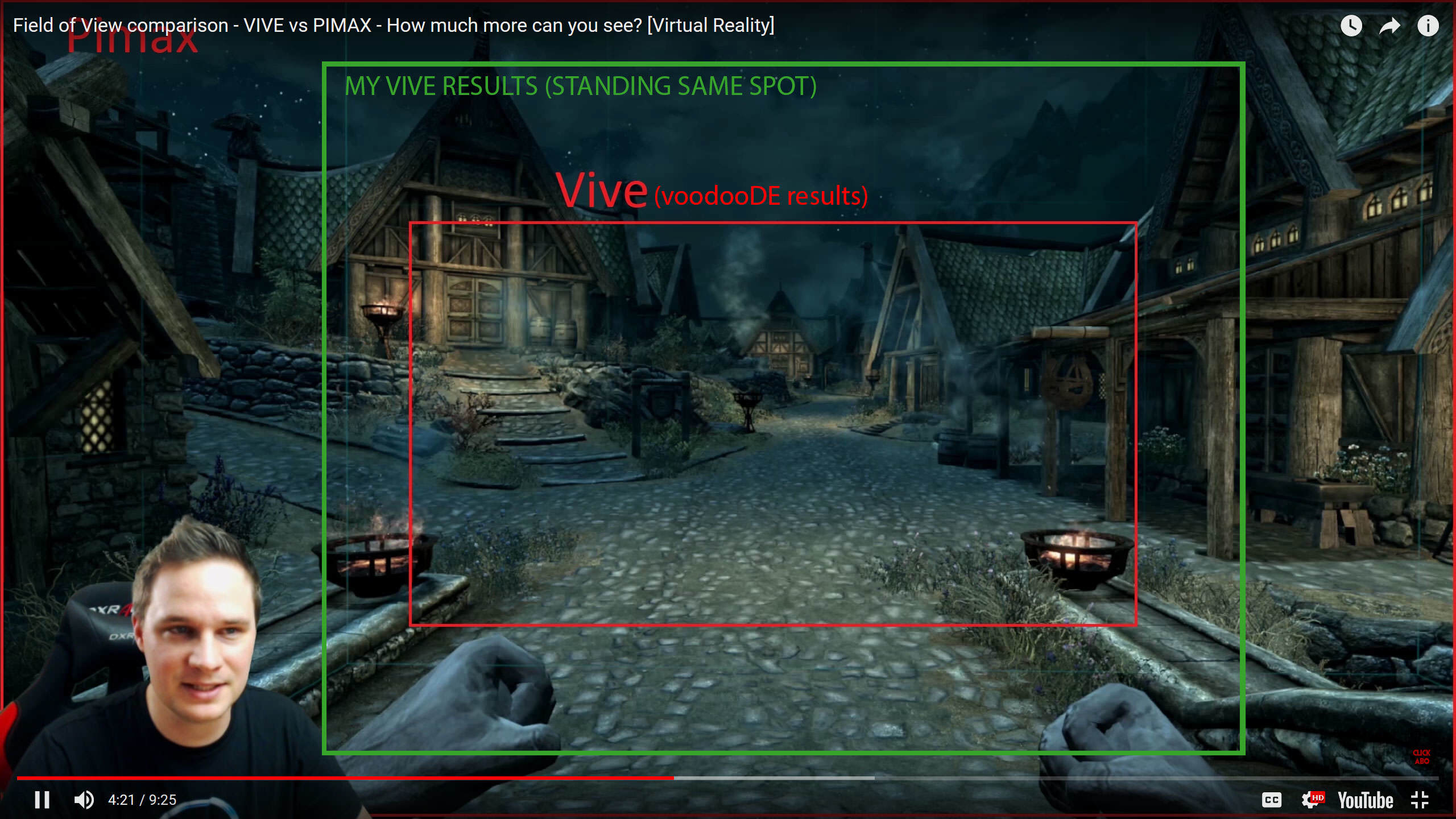

literally everywhere. The first time i’m reading 140 is from you today. They even did tests to verify and it was indeed 150. go to 1:04:22 where your mortal enemy says “150 which is the middle option for the field of view” and he measured it using the real o virtual tool.
Hmm I’ve heard 140, but it might actually be 144.5 if you do the math like I’ve just did. But it doesn’t change the fact that this video is wrong. The only pic that looks about right, (at least horizontally, about 40-50% bigger), is the Onward pic
lol…sure you have. 170 large, 150 normal, 120 small…the same as we all have been told. You included.
Well that’s mathematically impossible, since these are 200 and 170 diagonally. If 200 diagonally is 170 horizontally, then 170 diagonally is 144.5 horizontally.
I’m guessing the 140-150 then depends if you’re rounding 144.5 up or down.
But even if it was 150, then the video is still completely wrong (apart from the Onward pic). You must see that too, right?
Also look at the reactions under the video, this guy says it exactly right: “Those red lines are joke. They have everytime different position. Are you trying to say that every game has diferrent FOV and center of view in every headset? Nonsense
The Onward photo looks about right, at least horizontally. The other ones simply very very wrong. The Skyrim pic is even plain hilarious, with the Pimax at normal mode showing twice the horizontal FoV as the Vive? LOL. If you put up video’s like this, man, sorry, not sure how to say it nicely but I’ll just better say nothing then :slight_smile:

Well that ‘rough idea’ is VERY wrong. What good is this video going to do? It’s so very wrong. What would you guys say if he’d put up a video that would show the Vive having exactly the same FoV as the Pimax in normal mode, so no improvement at all? That’s exactly the same thing as what’s happening here, just the other way around. Would you then also say "Ah never mind, that’s ok, he’s just trying to give a rough idea’?
I mean come on if you want to inform people then don’t put up video’s like this. What was he thinking?

And then voodoo replies “It DOES make sense, because everybody sees it different! As I wrote under the video, it depends on the head shape, the IPD and even the face cushion you use.
:slight_smile:
I know he’s not a professional reviewer but man, come on … With arguments like the above you could draw ANY comparison box you’d want, “hey that’s just how I see it, might be because of the big face cushion or that I was sleepy and my eyes ware half closed, but still, that’s how I see it, so there’s nothing wrong here”.
