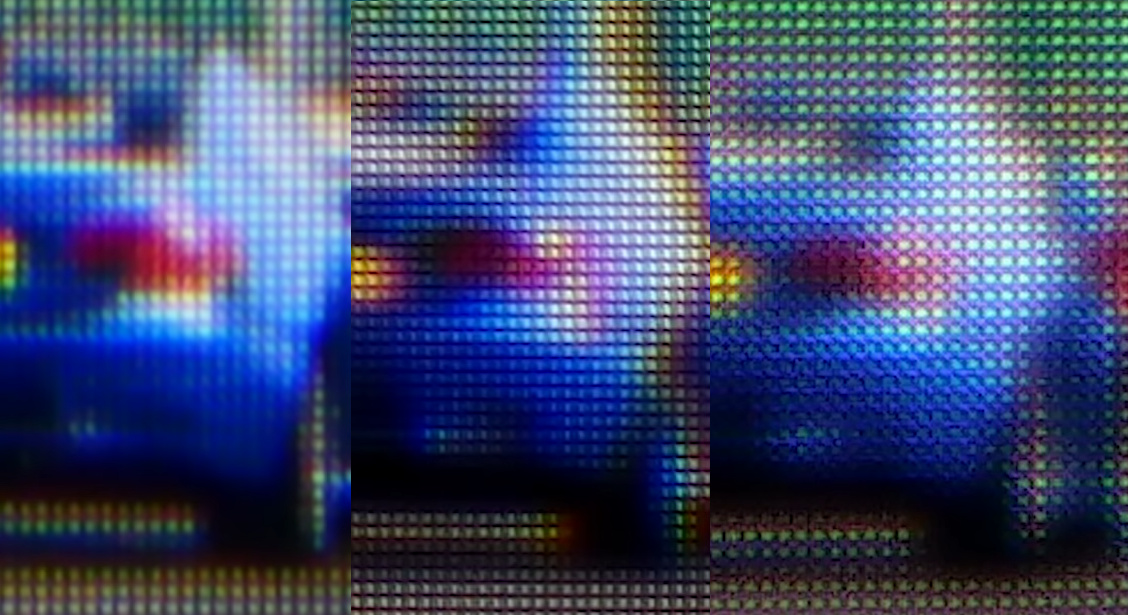

Left to right: 8KX, Reverb and 8K+, from the first video.
Can it be that the SDE lines of 8K+ (and more in the case of 8KX) get lightened by the light of the adjacent pixels or by the camera?
The SDE appears to be fading in the lighter areas.
I see slightly inconsistent results regarding this exact effect, most showing slightly better from the 8kX, a few showing slightly better from the Reverb. If I had an HP Reverb, I would be able to make a solid determination, but I think this is due to the limitations of through-the-lens photos.
My thinking thus far has been that the larger FOV and probably much better lenses of the Pimax Vision 8kX, makes it a much better choice, except for the minority of users who have an unusual IPD and such.
I am amazed Marcin could take such sharp and consistent macro images at all – some softness here and there, beyond what is inherent to to HMD, is more than forgiveable, I think. :7

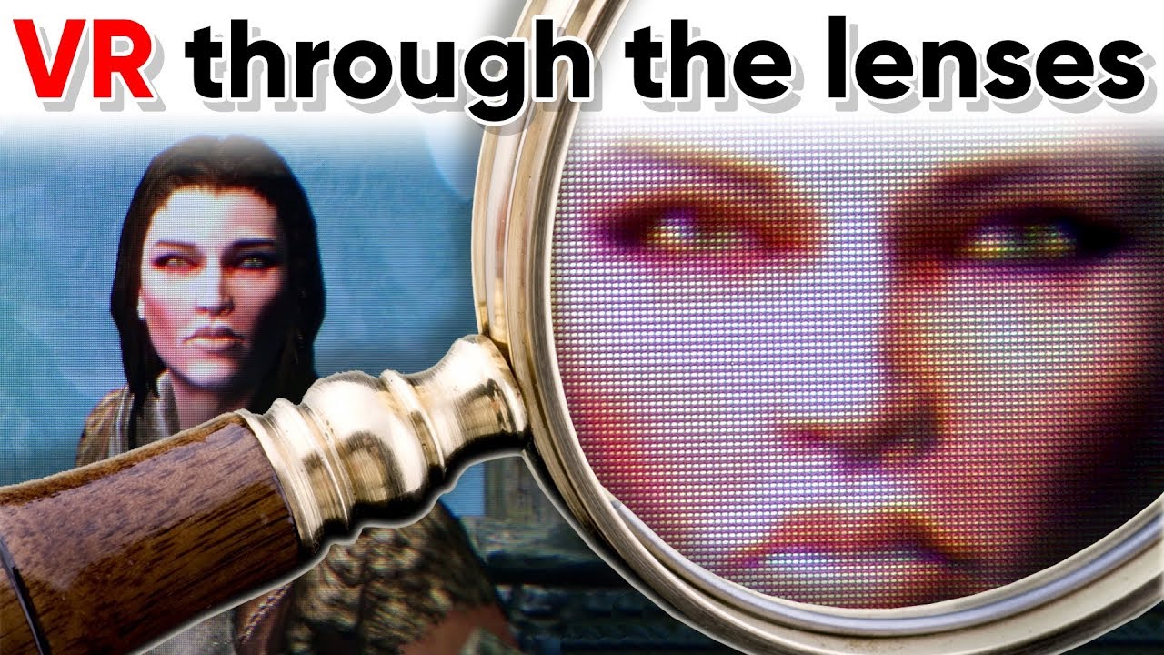

As was established when he first shared these pictures, though, they are to be taken to give an idea of the characteristics and rough dimensions of the pixel structure, and not as an indication of image quality: The closeup on the face of Skyrim’s Lydia-the-housecarl, in particular, shows extremely clearly that something is wrong with how things were rendered to the Reverb, when the pictures were shot, showcasing 2x2 pixel blocks, rather than making use of the resolution of the displays.
Going just by screen bitmap size to FOV ratio, without thinking too much about magnification levels, and screen utilisation, the Reverb should have a slight edge in resolution over the 8kX, which actually seems consistent with the pictures, although it can’t be easy to get the camera in there with the exact same zoom levels etc, and although I haven’t actually sat down and counted pixels in the pictures. :7
