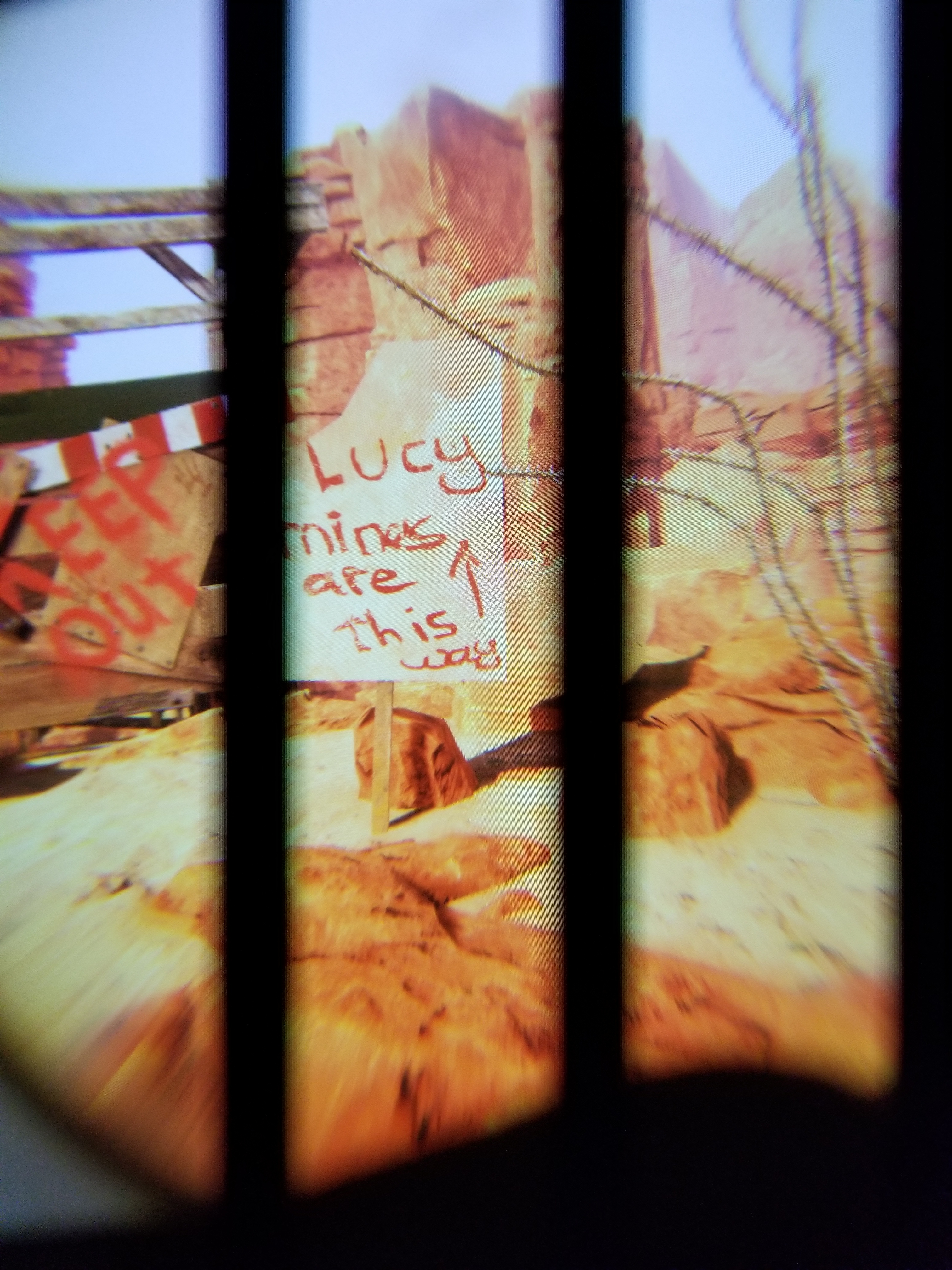

I’m not sure what your seeing but your colors should look like this, which in my opinion look fantastic in the hmd.
this is just a rough picture I snapped with my phone from arizona sunshine and beat saber. if your colors don’t look similar I would open a support ticket.
Although the LCD is not going to compete with OLED, your description of “white wash” makes me think there’s more than just disappointment of non-OLED standards.
Any chance you can take through the lens pics whilst in the Pimax default logo image?
