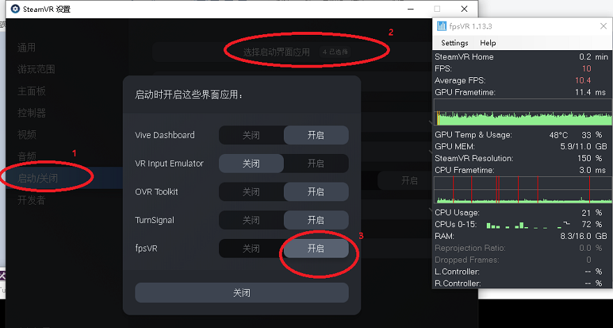

- Download from the steam store and set it to launch with the game. Turn your wrist to display the FPS data in the game
- Right click on the icon steamvr at the bottom right corner of the desktop, click “set” to see the following image, and click 123 in the order

- Download from the steam store and set it to launch with the game. The specific setting method is the same as in FPSVR

2, can also be set with the computer startup, the specific use method, need to enter the vr game, and then click the handle window key, can be found in the set desktop size, the specific setting method to explore, it is very simple, divided into helmet, left hand side, right hand handle three options

1,steam商店下载,并设置随游戏启动,在游戏中翻手腕就能显示fps数据
2,先右键单机桌面右下角steamvr图标,点设置,出现下图,再按顺序123点击即可

1,steam商店下载,并设置随游戏启动,具体设置方法和fpsvr里面一样

2,也可设置随电脑启动,具体使用方法,需进入vr游戏,再点击手柄窗口键,在设置桌面大小旁可找到,具体设置方法自己摸索,很简单,分头盔、左手边、右手柄3个选项
