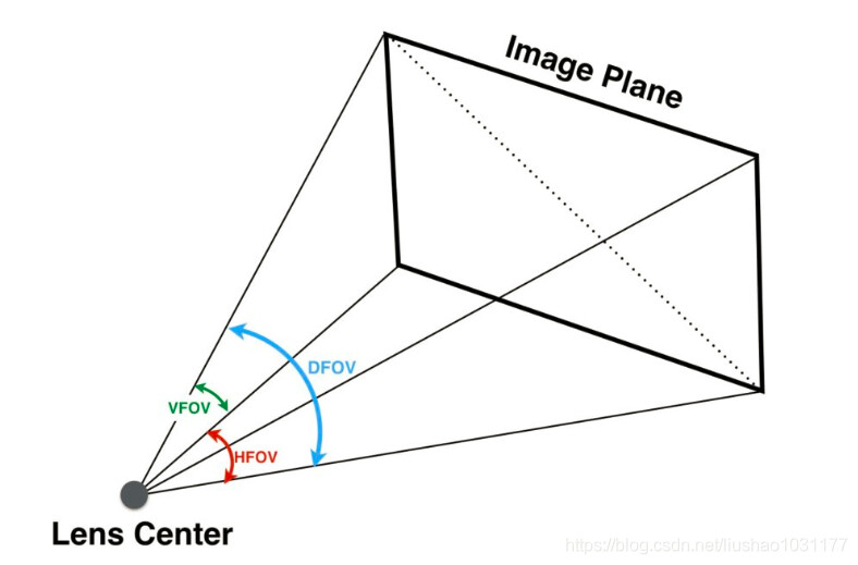

FOV is divided into HFOV (horizontal), VFOV (vertical), and DFOV (diagonal). At Pimax, when we talk about FOV, we use DFOV as a measurement. So this is 200° for the Pimax 8KX and 140° with the Pimax Crystal (when using 35PPD lenses).
  • – HFOV: Horizontal FOV
  • – VFOV: Vertical FOV
  • – DFOV: Diagonal FOV
In terms of theoretical pure mathematics, it can be seen from the figure that HFOV is determined by Focal Length and sensor width (W), and VFOV is determined by Focal Length and sensor height (H). DFOV is jointly determined by Focal Length, W, H.

You may want to look at my take on the topic (VR headset rendered FOV calculation | VR Docs), kind of idea precursor to HMDGDB, where I was trying to explain the same things you are trying here (or on your blog). You could notice there that I defined the HFOV and VFOV across the FOV centerline (frustum axis) as is common in any technical literature and not along the borderlines as you do on your picture.
Apart from that “detail” however there is not much subjective about it (the rendered FOV) as I explained further down in my doc and it can be easily “measured”, which is what led to HMDGDB.
