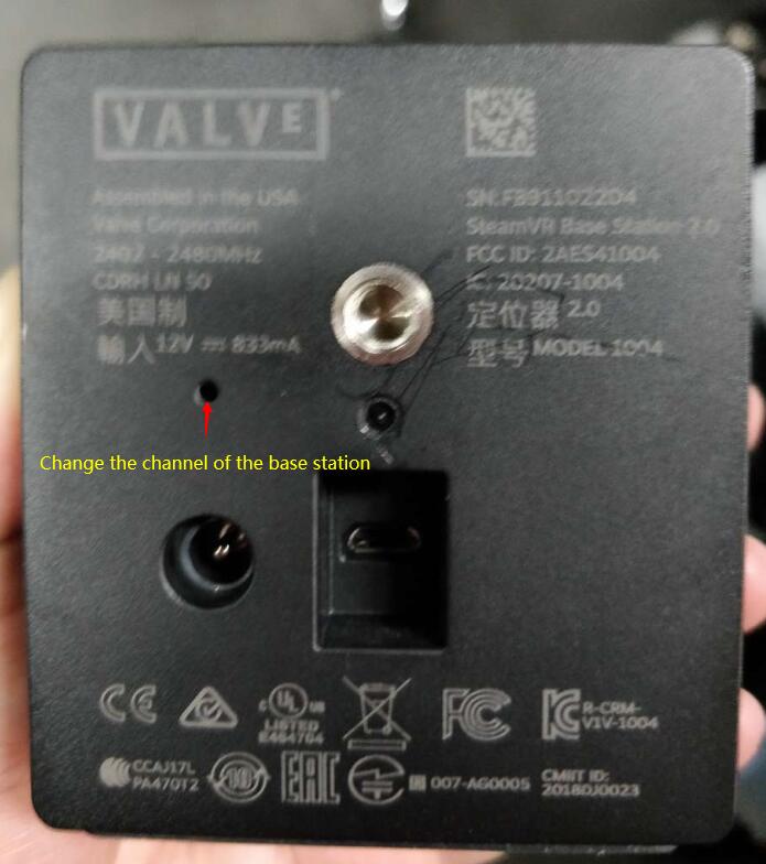

You should be able to switch the channels manually by using a pin in the hole ;-). Make sure the basestations are on separate channels first. I would also recommend using only headset and the bases until you get it working. Then try adding the controllers. You may also try to check for the firmware update by connecting the bases via USB to the PC and running SteamVR check.

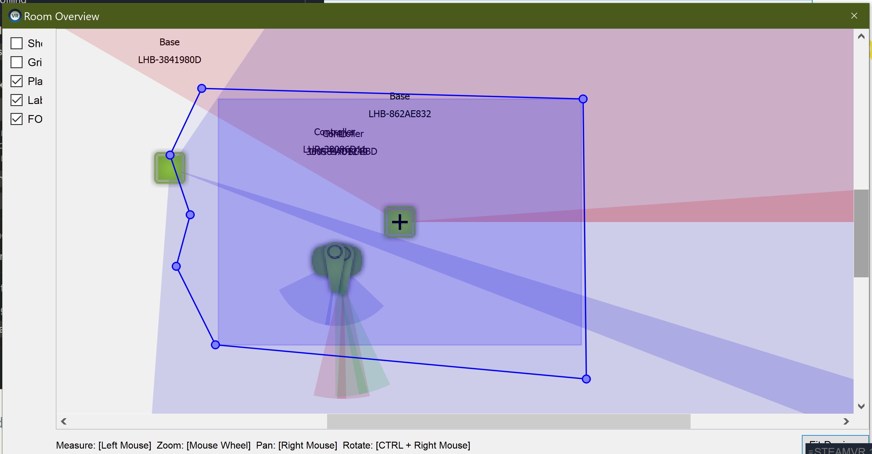

I made a screenshot of my Room overview in SteamVR. It looks like it can’t find where the lighthouse is positioned. In room overview it just shows it in the middle of the play space when it should actually be showing in the opposite corner of the room. I guess that is a clue.

If my understanding of how v2.0 LH works is correct, the fact that the both LHs are recognized means the sensors on the headset are receiving them. Since there is no longer the IR array on v2, the sensors should be reading the laser sweeps.
The red LH is positioned wrong, even its “targeting beam” is off to one side.

  1. Both channel of the base station overlapping can cause one of the base station cannot be track. You have to change the channel of one of the “faulty” base station.
  2. There are defect on the base station itself. Please kindly check it’s working fine.
