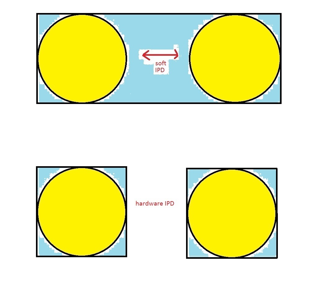

Oh and what matters somewhat too is the amount of used pixels. For example, the Pimax uses soft IPD, so they move two circles around the display, according to the IPD: the higher the IPD, the more space between the two circles (one circle for each eye being displayed). Only those 2 circles get picked up by the lenses though ! So there are relatively a lot of pixels that are NOT used for the final resulting image. So effectively this lowers the resolution.
Now imagine you have a square 2k*2k panel like Kopin made. Put two of them in a HMD, one for each eye and use hardware IPD to move them: this doesnt cause any lost pixels. So this will also be better for the SDE and picture fidelity.
Of course there are still lost pixels though, since the screen is square and the lenses are round, so you still effectively have lower real resolution than the panel resolution.
But the loss is smaller when you have hardware IPD.
Or in a picture:
Only the yellow pixels will be used and the blue pixes are wasted ! So hardware IPD is a lot better for the SDE and image fidelity than soft IPD, but only of course if square display’s are being used !

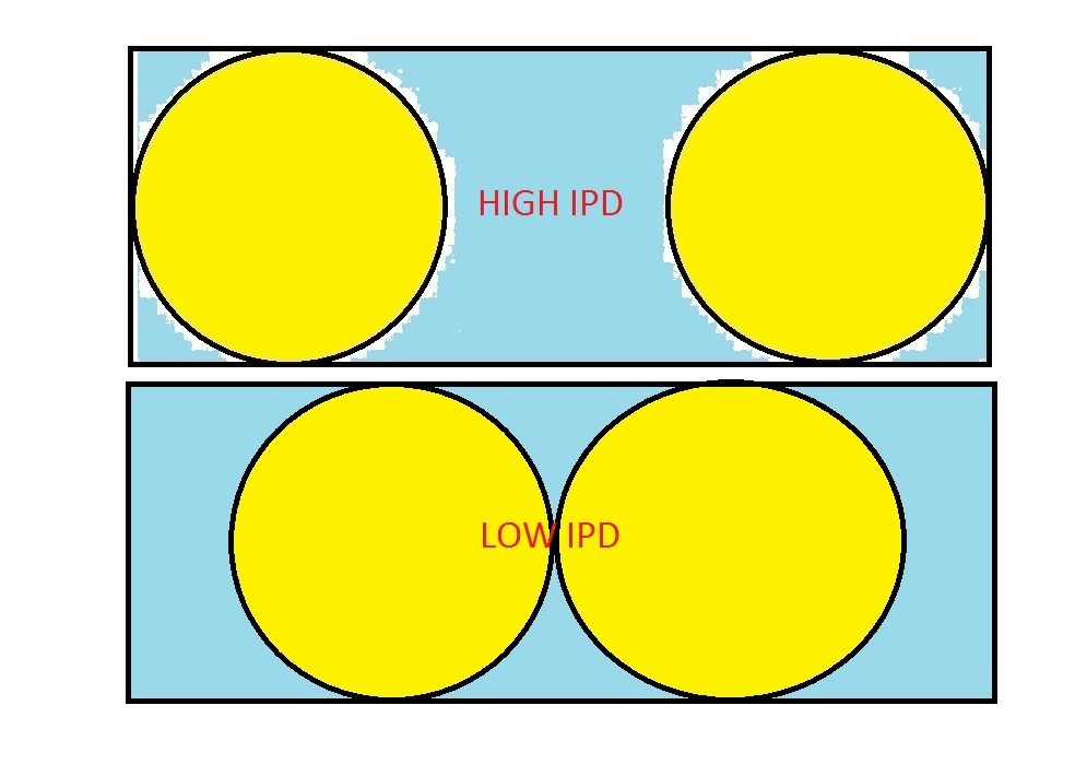

Actually this raises the question: which form factor will the Pimax 8k panels have ? Because if they’re regular panel size, the ‘waste’ is enormous. In fact, you’ll get this:
So the resulting SDE will be a LOT higher on the Pimax 8k than on the Pimax 4k if the panels are not square, due to huge unused panel parts. UNLESS somehow special lenses can be used. Maybe the fresnel lenses overcome this problem and make more oval than circle projected parts ? Hmmm thinking of this, it almost must be that with special lenses they create oval images. Because if not, it would be useless to use 2 panels (because the size of the circles doesnt increase). So I’m guessing the Pimax 8k lenses work like this:

Please take a look again at the pictures above. In the very first picture there’s a lot of blue area between the 2 lenses, which are “wasted” pixels, They’re just being used a ‘IPD adjustment zone’ and not for display: if the user selects lower IPD, the displayed area’s (the yellow circles) move to the center and vice versa. So the actual pixels that are left to create the HMD image (the pixels inside the yellow lenses) are actually way lower. So that’s why soft IPD causes more SDE than hardware IPD (IF of course the panel size conforms to the lense size). Just compare the blue area in the first 2 picture’s, that’s my whole point.
I think you’re using an online translator right ? I think a part of my explanation got lost in translation. A last picture then to explain:
this is what happens when you adjust the IPD parameter, it just moves the circles around the display. But a lot of display pixels are unused for the HMD picture = worse SDE.
