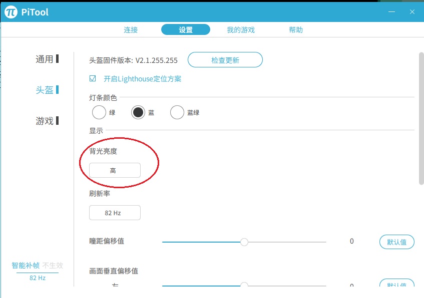

One, improve the backlight brightness, the overall effect can increase by 15%
I use the old version pitool: 1.0.1.197 _R244, this version comes with a backlight brightness adjustment, the latest version pitool, remove the backlight adjustment is, but when I pull the backlight brightness to the highest picture feeling brighter, more comfortable, but the white fog, gauze is basic didn’t increase, and low when backlit, clearly darkened, no high when backlit screen is satisfied, the new version pitool should be restored for xr this feature
