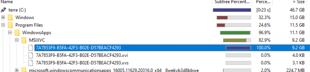

Afaik there’s no “executable” when using Xbox Game Pass for PC - this thing uses game images, like isos, which it mounts on game start. So that approach may not work (unless I’m missing smth).

Not all Microsoft Store apps use this, but apps installed from Xbox Game Pass for PC tend to use this (or maybe even all of them). Some googling on MSIXVC says it’s their new UMP distribution format. Then when you start a game, a virtual disk appears in Device Manager, called “Xvd”, and game data is accessed via this virtual disk which is mounted from or mounts into itself images in MSIXVC folder.

Believe it or not, the running process’s (NMS.exe) location (“open file location”) or “properties” are not accessible via Task Manager, and I’m pretty sure this is specific to Xbox Game Pass games / UMP games. Nothing happens when I click these menus. This means that most likely the location of the file is permission-restricted such that neither user (nor administrator) has access - most likely only some Windows service(s) have access, which are used to start this up. Additionally as the game is via a mounted image, the mount is highly likely RO, making changes to permissions impossible during runtime, so I see no practical way of doing what you described (adding the exe to PiTool) without hacking this thing real hard.
