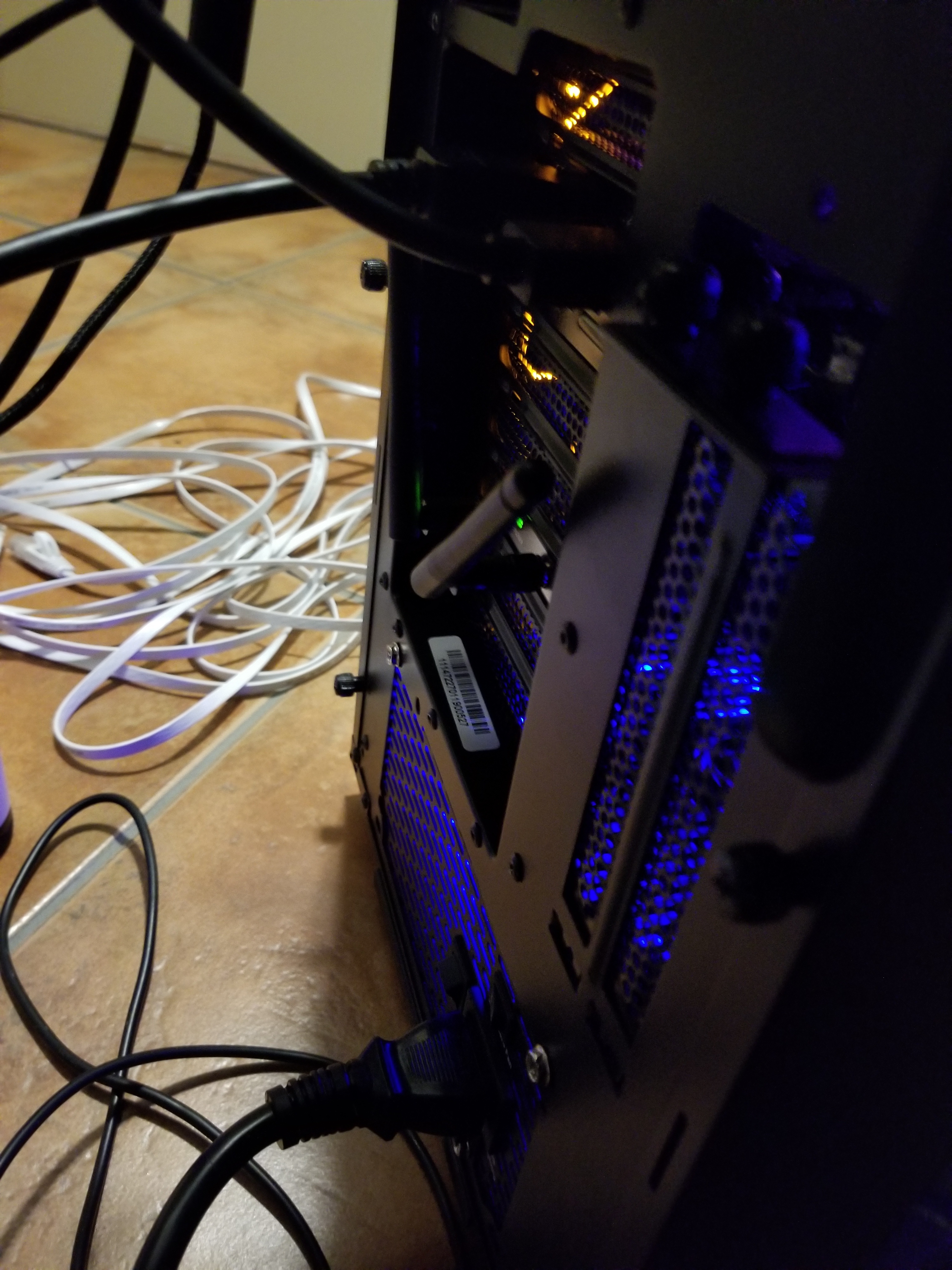

So about 5 days ago, I dusted my PC components using this electric duster:
https://www.amazon.ca/gp/product/B01BI4UQK0/ref=ppx_yo_dt_b_asin_title_o00_s00?ie=UTF8&psc=1
Yes I know it’s not as powerful as an air can but I wanted to see if it would at least reduce the smell. The smell has not gone away. Sometimes it more noticeable, sometimes less, but I can smell it the closer I am to my desk. I worry the smell might be harmful for my health. It feels a bit intoxicating.
Here are some pics of my PC. It’s on the floor underneath my desk
My Index, monitor, PC, and lamp are all connected to a power strip I’ve owned for many years. Is it safe to use power strips?
Anyways, at this point I’m seriously considering just buying a brand new 2080 Ti gaming PC that has liquid cooling and sell my current smelly PC lol. Does anyone know any good companies that sell ready made gaming PCs?

Does the smell get stronger/worse when the PC is under full load, rather than idle? If not, it could be an electrolytic capacitor went bad and vented.
Would not worry about the smell causing health problems. And to support my work in a 3D printing business, I have gone through such things as the academic studies on pyrolysis of kilograms of plastic. Long before enough material vaporized to be hazardous after spreading around the room, the PC would almost certainly be non-functional. Especially with RoHS these days, it is hard to imagine anything in a PC that can vaporize in hazardous quantities.
At this point, I am beginning to suspect whatever is in your household dust includes some sort of adhesive, and maybe that is vaporizing now. A proper air can is a must have for any gaming PC.
Plug strips are definitely ok generally. Keep in mind though, gaming PCs these days are high wattage, so any electrical cabling to them needs to be high-quality. Replace if anything is suspicious, or the plug is rotary type. If mounted to a rotating chair, use a zip tie appropriately for strain relief. Also, if there is a built-in surge protector, it can catch fire, so keep it away from carpets, curtains, etc.

Looks like your PS is a the bottom and you said fan is blowing upward and above it your gpu is blowing down. If that is the case the airflow isn’t optimum especially with what appears to be a cluttered case. can’t tell fro sure from the pics. The noise grinding noise might have been a bent fan blade (possibly on the PS) that slowed the motor enough to (almost) burn it out causing burnt wiring in the motor. That smell could last for quite some time. Even months.
Just a guess, but would explain a lot of what you have said. You could try pulling the PS and giving it the smell test in another room while airing out the rest of the rig.
Yes, I’ll try to do a smell test of all my components again this time using an empty paper towel roll on my nose. I read it helps isolate smell.
You might just replace the PSU outright. If it’s not the PSU, then it’s probably dust in the PSU, and either way, if the old PSU turns out to be fine, you can sell it on eBay.
The reason i suggested pulling the PS is the “possible” burnt smell may have impregnated the case long enough is it could be hard the isolate it as the source while it’s in the case. Also why I suggested airing out the case at the same time.
Hmm, that could be a possibility. I’ll probably replace the PSU with the exact same kind but brand new. That way I don’t have to change the cables. For some reason the previous owner put a thin velcro strap around the PSU to hold it down?
I’ve read a horror story of a guy who bought a new but different type of PSU from the same brand and didn’t bother using the new cables because they looked identical to the old ones. It created a plume of smoke and destroyed his whole PC.
This can happen. I have done it. As long as the PSU is exactly the same model, it should be ok. However, as an extra precaution, backup your data and unplug your disks before attempting to power on for the first time. That way at least your data will be absolutely safe.
I have a Thermaltake Smart RGBPro 750W 80+ Bronze PSU and I can’t seem to find it available anywhere. Since I’m replacing it, I might as well upgrade to a better one.
Do any of you guys know a good reliable 750W PSU that has an 80+ Gold or Platinum rating? I’m willing to switch out the cables with new ones.
Oh by the way, some of the cables from my PSU are connected to a metal panel that’s screwed to the side of the PC case. I don’t know what’s on there.
