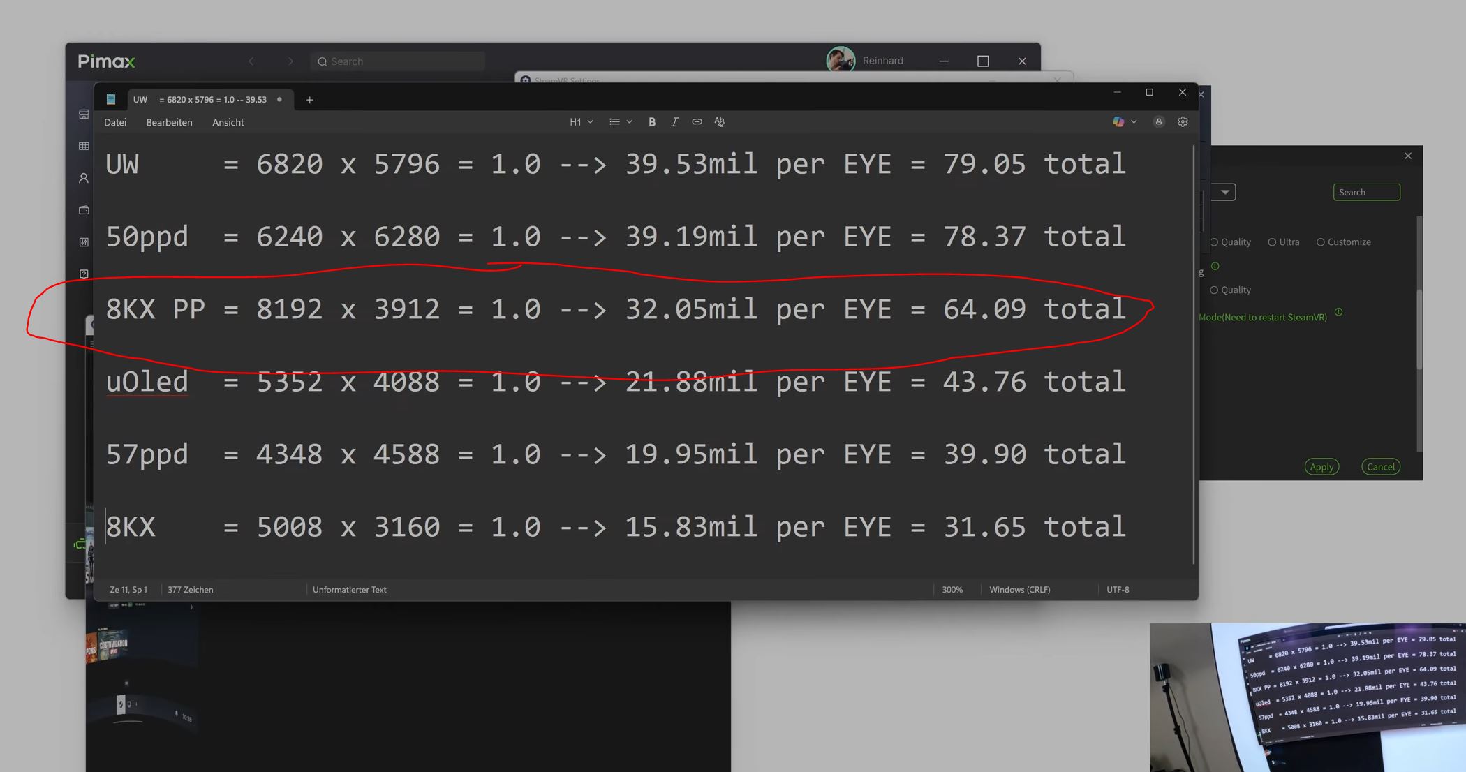

No, only legacy now for the 8KX and maybe others with heavily canted lenses. The new designs plus improved software has eliminated the need for workarounds. I think it’s effectively on by default with new headsets, but doesn’t need that huge corrective hit.
The fact that the M-OLED / Dream Air pushes the resolution that it does, has 53 PPD, needs far less distortion correction, and still only needs to push 43.76 million pixels is an impressive improvement.

Oh. Are you saying that the newer headsets take a performance hit too (the more canted they are), but since the angle is smaller, the performance hit is smaller as well? But non-zero compared to fully parallel headsets like Meganex? In all games?
Others can explain the technicalities much better than I can, will do my best. Also better locations than this thread but I hope this helps.
All headsets by their design of lenses and displays take a performance hit, the GPU has to render internally a higher quality image and this is sent to the headset to have a distortion profile applied to suit those particular lenses, so you see the clearest possible image (considering all the factors of clarity, FOV, distortion, aberrations etc). Canted lenses need more aggressive profiles for this with more pixels, angle is likely a factor. This requires more performance.
In this context there’s no such thing as a fully parallel headset and therefore zero hit, all lenses need to bend the light to present the image at a specific distance to the user, that’s physics hehe. So work must be done on all headsets, canted at some angle or not, it’s about efficiency.
On that pixel comparison image above, you can see how much extra the 8KX in PP mode pushes compared to without PP, or compared to current gen headsets. It has huge asymmetric Fresnel lenses. To compare, the efficiency of the M-OLED optical stack with its new pancake lenses, needs far less distortion correction, and requires way less pixels, despite its higher screen resolution. Less FOV to deal with but also increases PPD to 53 (8KX 20-23, with ~35 in centre apparently, much lower clarity). Martin’s video above covers the M-OLED stack.
Pimax have also improved the software so it is more efficient, and there is also no specific need for the old heavy PP mode workaround for newer headsets to my knowledge, unlike the 8KX which is an extreme example now - and why some games don’t cater for it by default, they’re not picking up all the API geometry values needed - SC does, but needs further investigation to solve. The Valve Index also has canted lenses and doesn’t require any heavy workaround, but ofc some hit is being taken nonetheless.
