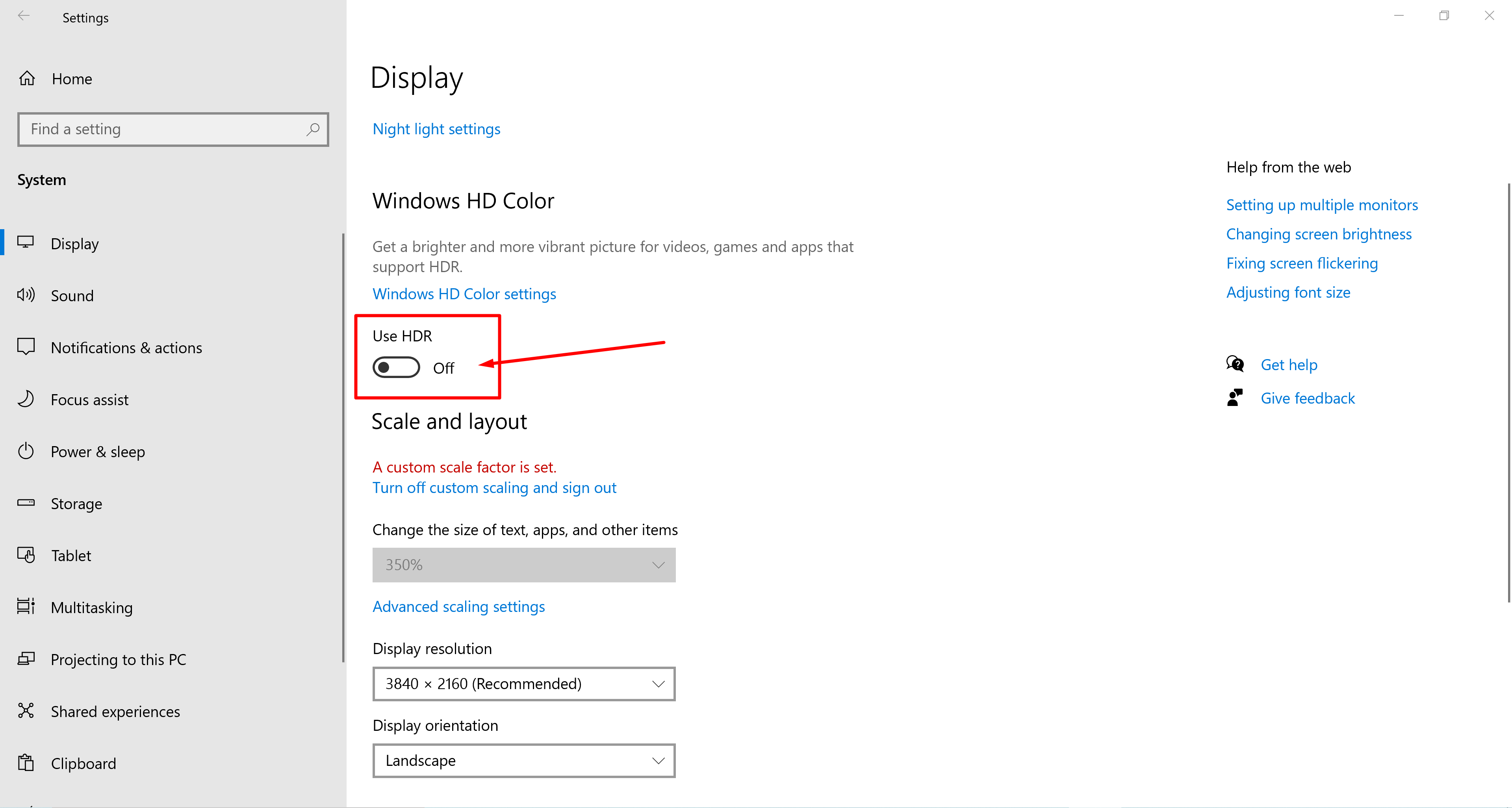

Okay I understand why it’s happened, It’s an HDR feature of windows, I just turn it off and everything in Pimax 8KX gets very crisp and clear, shocking very much clearer than before but as I remember this HDR was on for a long time but now all of a sudden the 8KX not liking it much.
That setting is turned on and points to my projector so it seems to be a monitor setting. Not sure why it would affect a headset unless it’s an 8Kx thing but it doesn’t affect my 5K+
