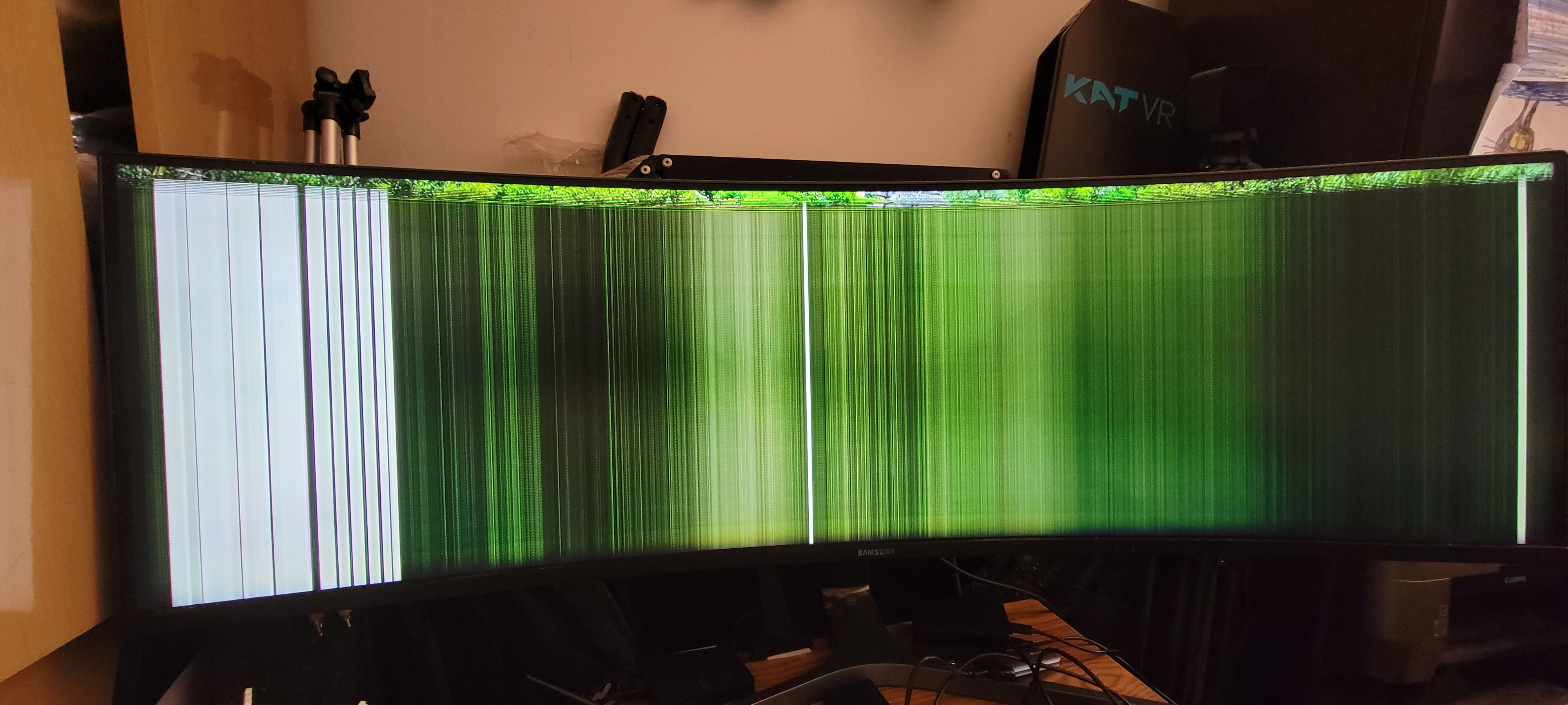

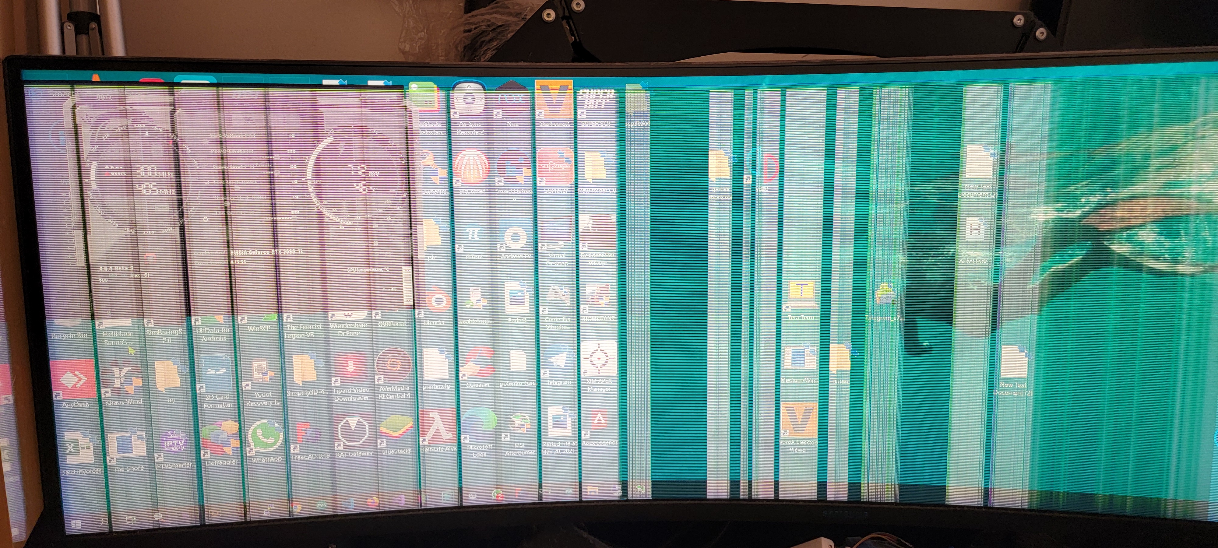

Does anyone know what is causing on my pc the screen to become this way?
It happens when I turn on my monitor but it does not always happens.
Even when i remote access my pc using a program like splashtop, on my phone the screen appear like in the attached picture.
Is this cause by my monitor or by my videocard or by the OS?
I have an nvridia 2080ti and a curved samsung game monitor 49" CHG90 QLED Gaming Monitor
Any help please?
Reseat the monitor cable at both ends
It does look very much like a VRAM issue. You need to borrow another video card and test it out. Changing cable or reseat the video card won’t help.
Thank you everyone for your reply!
What is weird is that when I remove the cable from the video card, on the monitor I can still see the latest messy images I was seeing on the monitor when the monitor was connected to the pc.
Is that normal that depsite the monitor is not connected to the pc, the monitor does not go completely black?
Sounds to me like something is wrong with the electronics inside the monitor.

Hi guys! Thank you so much for replying! I have done a 1st step of changing the display port cable from the monitor to the pc and it seems it fixed (for now at least) the issue.
I hope it is not a faulty video card otherwise I have no idea where to find a new video card to buy.
Are video cards out of stock everywhere?
I was thinking to upgrade the video card , but I guess at the moment is impossible
Wanted to give a feedback. I returned the samsung 49" CHG90 QLED Gaming Monitor and I was reimbursed of the whole price.
The monitor has definetly manufacturers defects.
