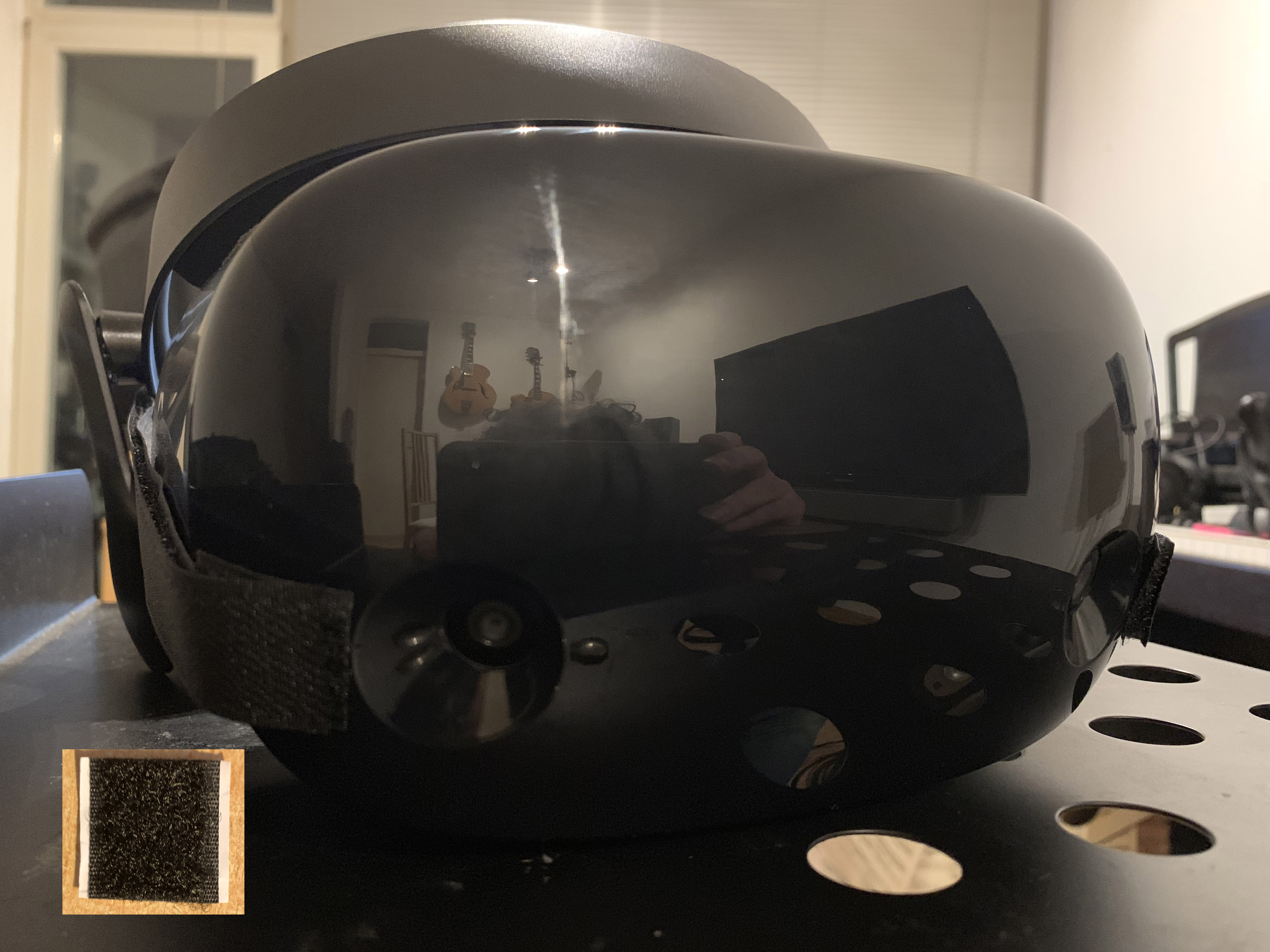

I freaking love the idea of the velcro mod, so I did one for me as well. I “pimped” it with some fleecy tape inside of the strap in order not to scratch the device with the rough velcro material and not get my hair pulled :slight_smile:

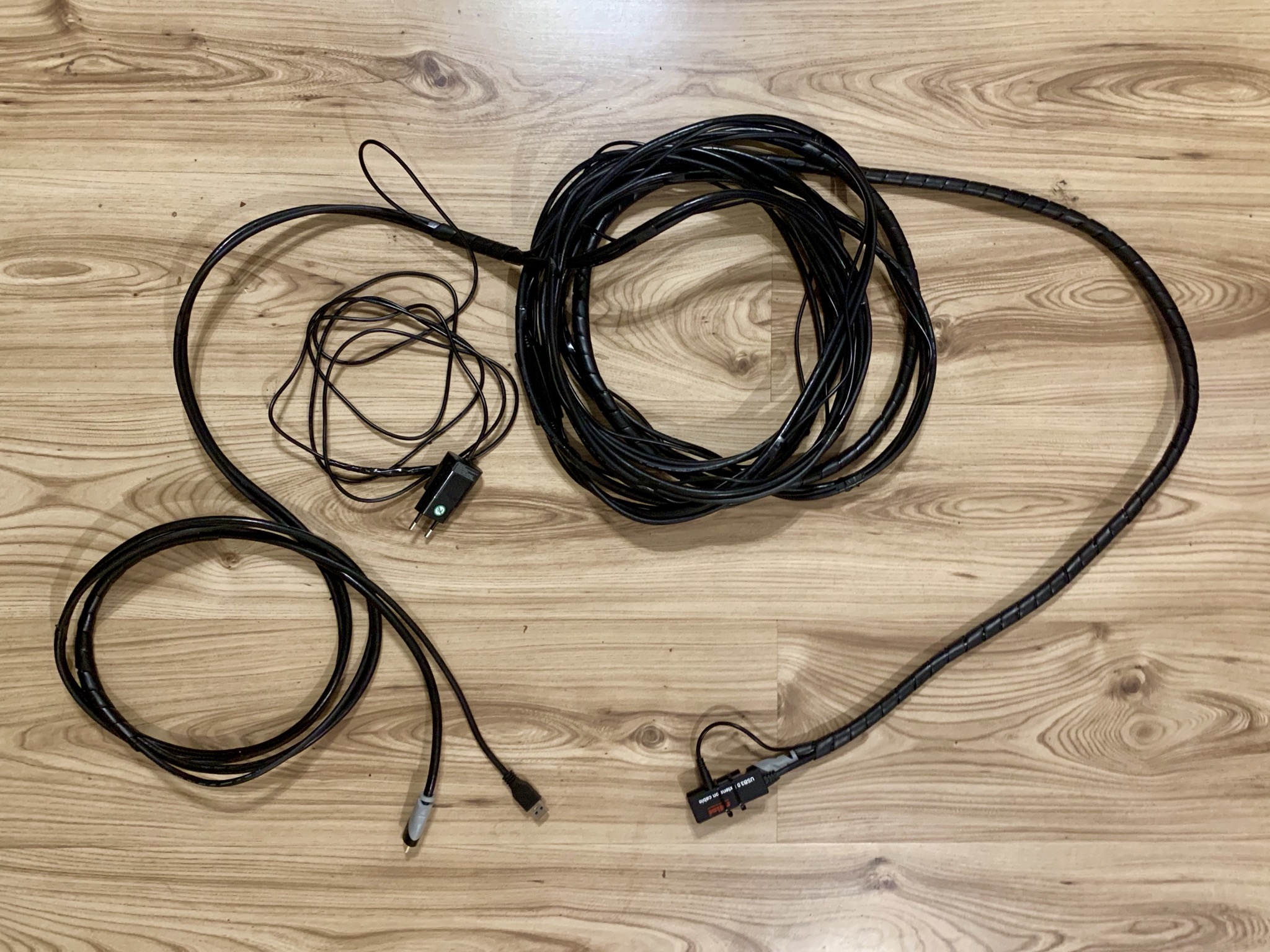

AND HURRAY…after many hit and miss components giving me a hard time I finaly got my 10m extension project done successfuly :slight_smile:
  1. PCIe card USB 3.1 for enough juice to start with.
  2. 5v powered (mid/end) active USB3 10m cable.
    Extended the dc cable to 10m as well in order to plug it conveniantly at PC side
  3. 10m HDMI cable + HDMI repeater
