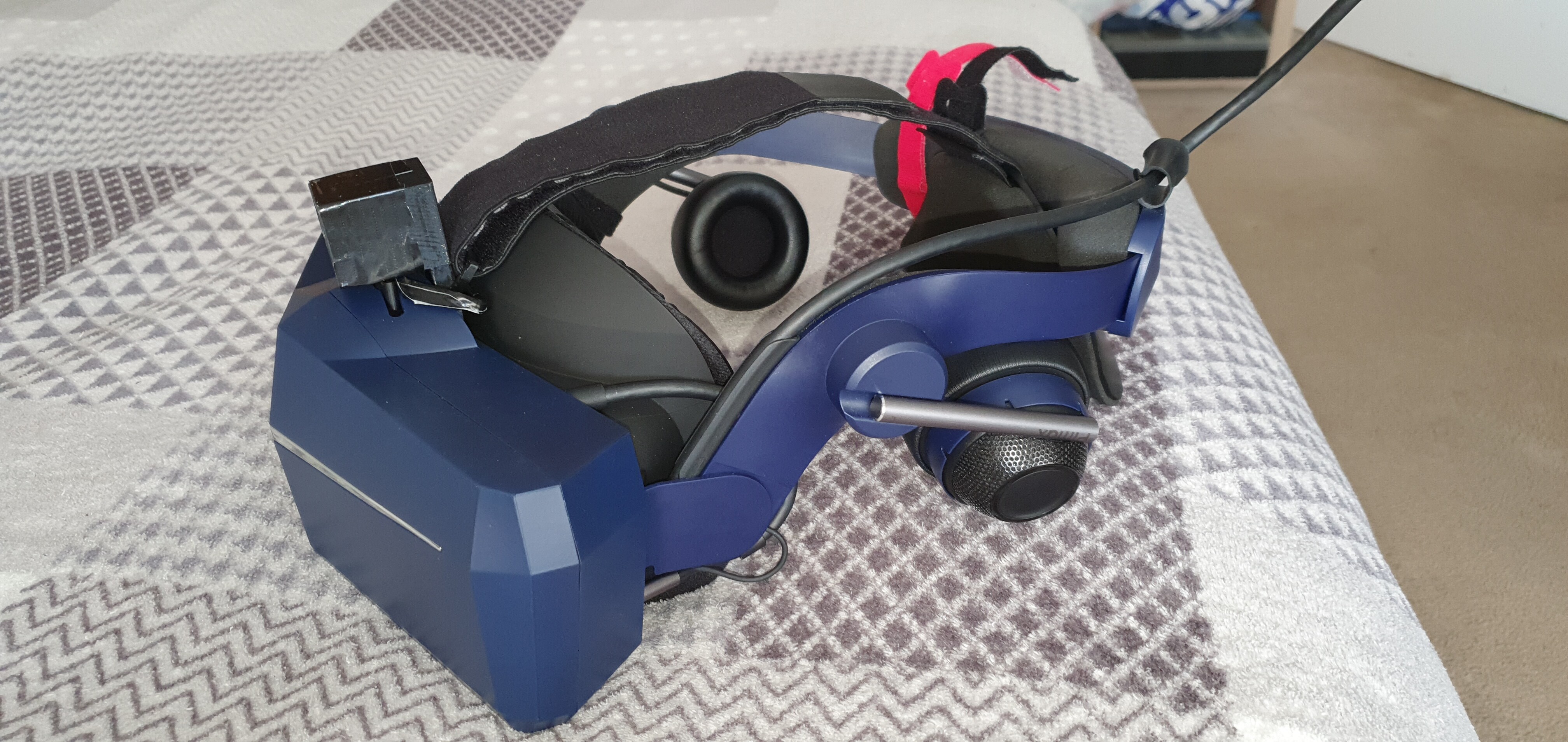

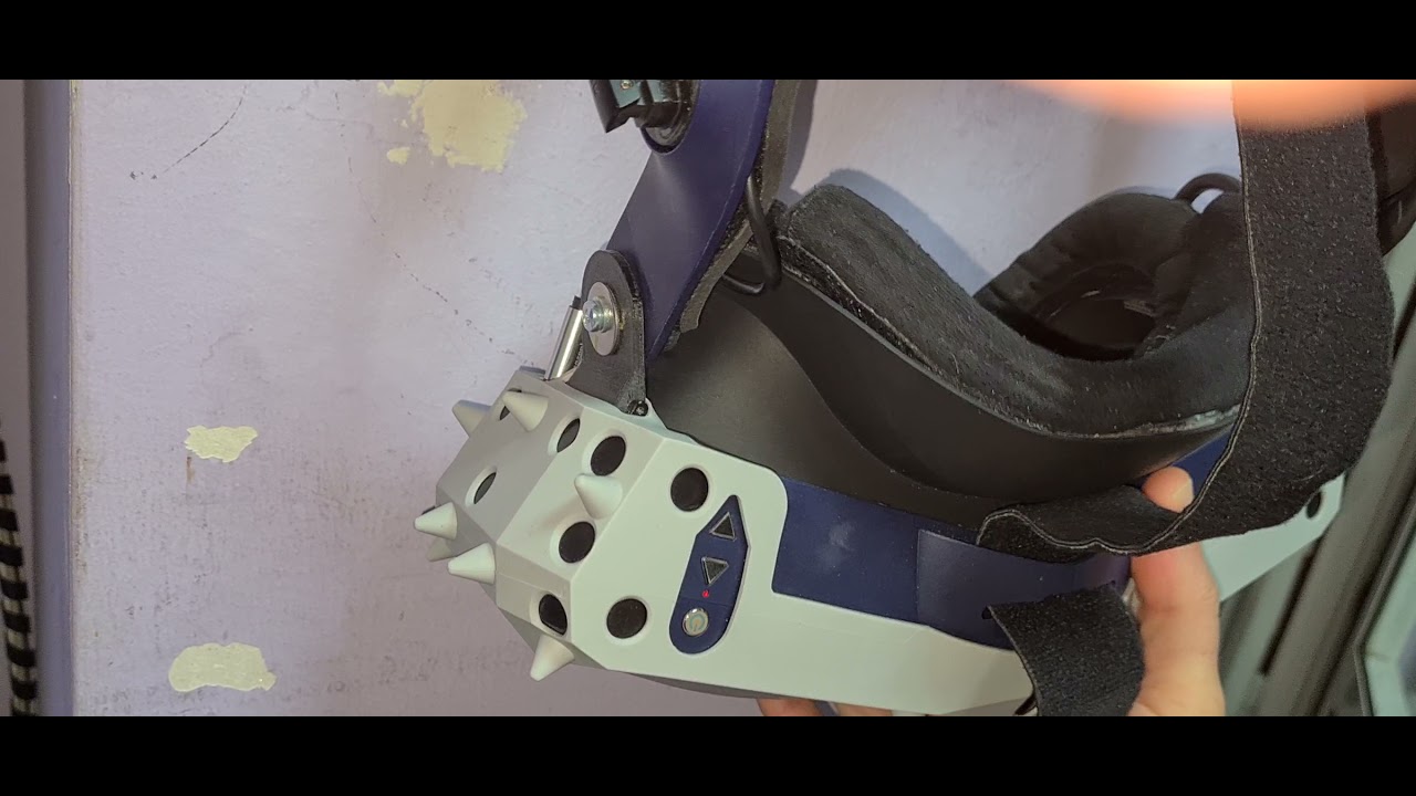

I have designed rigid hinges that prevent wobbling when moving the head quickly and allow any angle of the MAS to lower everything you need, they are symmetrical so they can be mounted on both sides. They give a very firm hold of the HMD to the MAS and to the head, largely avoiding the problem of wobbling when moving the head quickly:
Nice work, isnit difficult to remove the pin from the HMD like that?
You mean the metal pin? It is very easy, with a small screwdriver it unscrews and comes out instantly. Easier than I thought, in fact mine was already weak without knowing it.

I do not quite understand your idea, mine is that the hinge is as rigid as possible so that it gives the feeling that it is part of the HMD housing and that it already has the right angle so that both hinges are parallel.

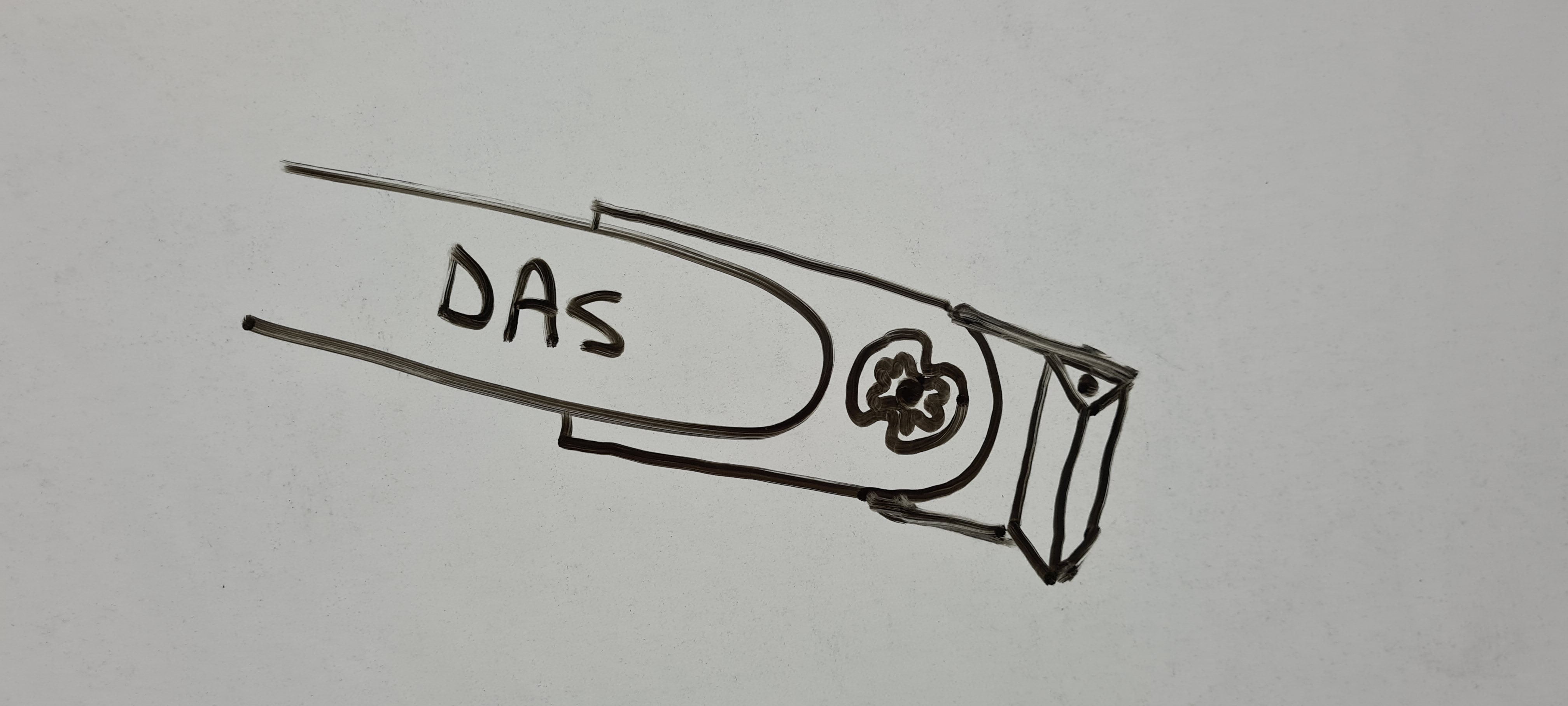

Its something i’d like for the DAS too but since they have these click in hinges you would need to cover them and make a new insert which they can sit in like this Vive DAS Adapter for Oculus Quest 2 (Improved) - FrankenQuest by sekazi - Thingiverse
Then you would add a small gear that so you can change the angle of the strap and keep it there.
Now I understand what you say, you want to fix the vive DAS without the possibility of using its rotation point and that all that block rotates on the rigid hinge but with several positions and not with free movement. Let’s go what I have done with the MAS of Pimax but with the DAS.
Your idea would be something like this, inspired by your link:
The issue is that I don’t have a vive DAS so if I design something it would be theoretical, without the possibility of testing if everything really fits and works well, it also adds a lot of volume to the sides. Although I can assure you that if I had a live DAS I would believe it since it seems like a very good idea. I do not rule it out, maybe I will start doing it and whoever is interested will print it and share experiences and optimizations.

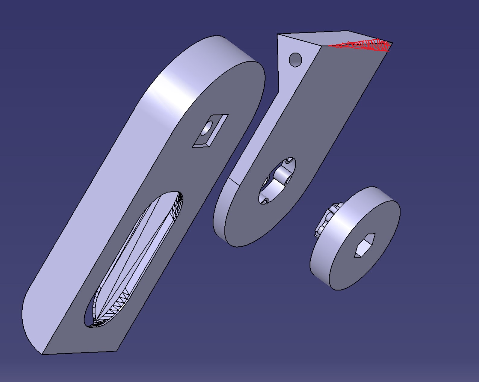

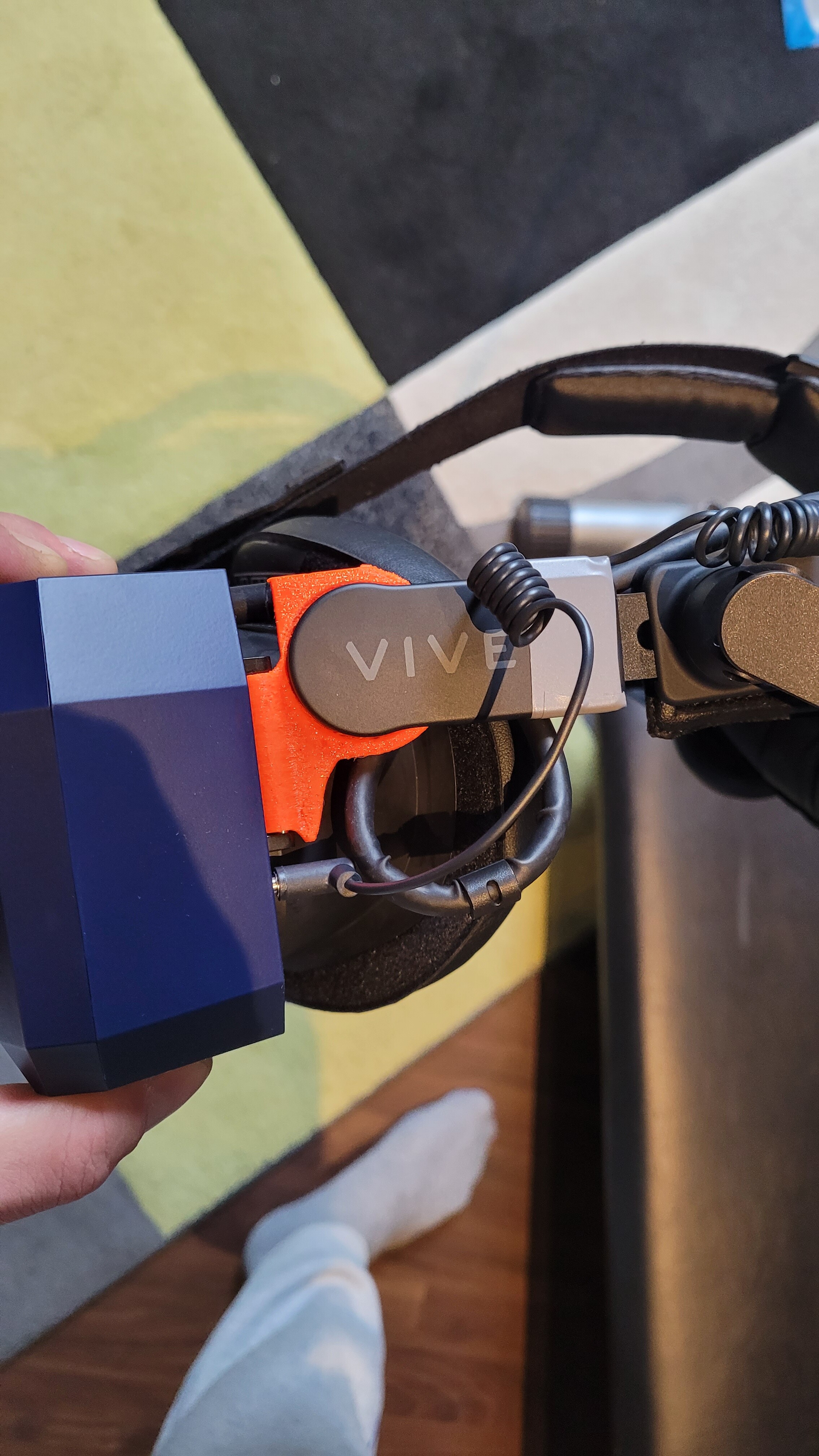

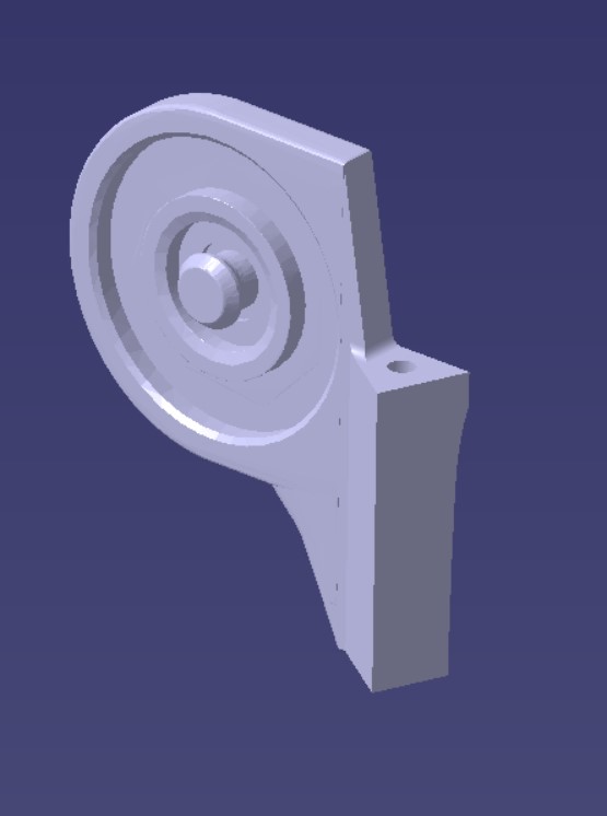

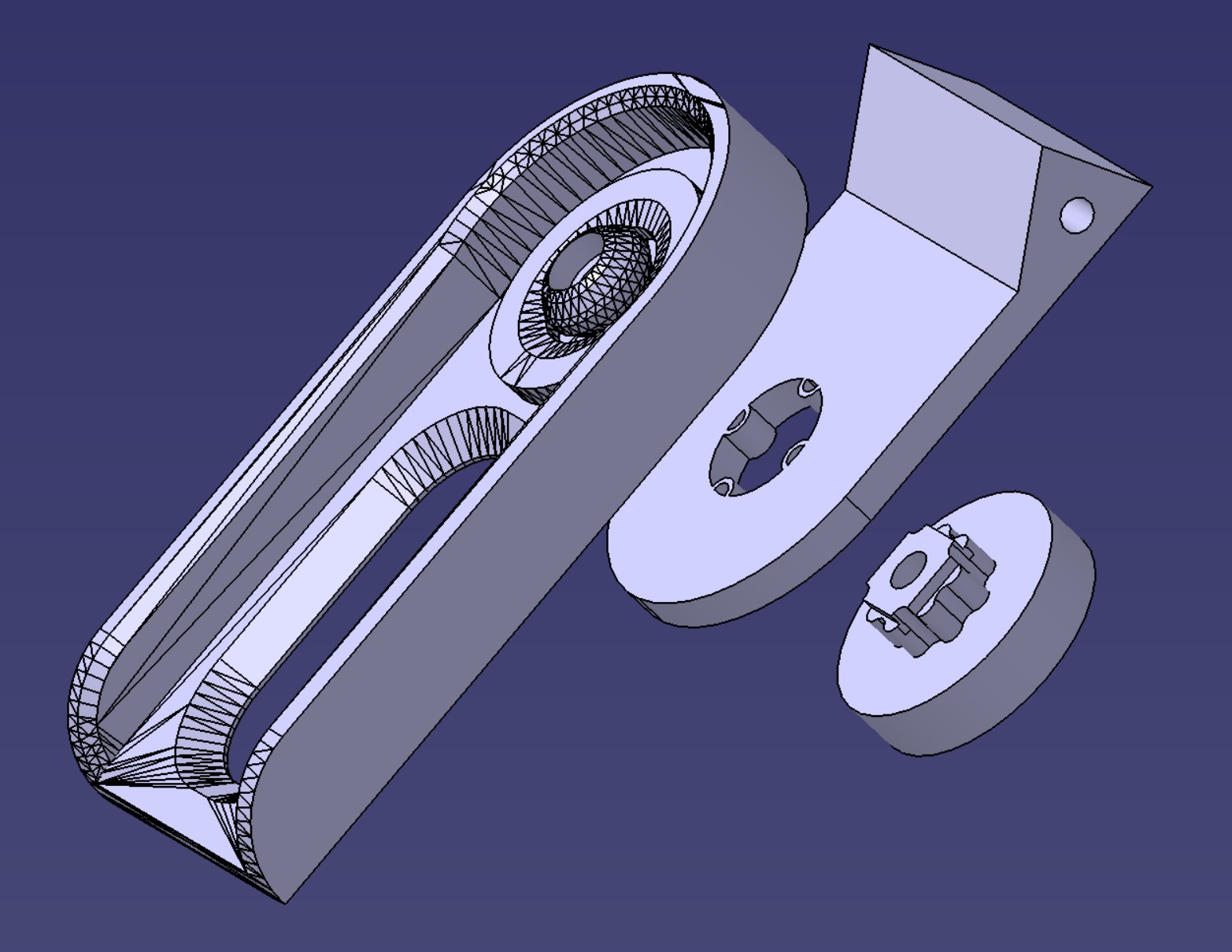

@EruKaze @Trigen @Lucivr . Finally I have gotten involved and I have created the 3D in .STL for your vive DAS. It is a totally theoretical design, the one that he wants to try will tell me how it fits and works. It is for the right side, but mirroring before printing the hinge and vive DAS adapter will work for the left side. Everything has to be assembled with an M3 bolt and nut.
Some photos and the compressed file with the 3 necessary files.
This last photo is a section of the part of the gear that will give the fixed positions of the vertical movement, do not hold it, it will have that mechanism, you will tell me.
An observation, surely you have to create by filing this part that I mark in red, it interferes with the conford kit a bit. I thought the modification was made in 3D but it is not. It is almost better to do it later so you adjust it to your liking and it would also not be necessary to print it with a mirror for the left side, in this way it is totally symmetrical.

Metric Screws and Nuts (M4)
The pin is removed with a philips tip screwdriver, it unscrews counterclockwise like any other screw. Mine were loose so I didn’t have to make any effort to loosen them.

So they are the first ones that I designed for the Pimax MAS, and they are the ones that I am using:
So they are the first ones that I designed for the Pimax MAS, and they are the ones that I am using in the first post. Everything is attached with M4 bolts and nuts.
