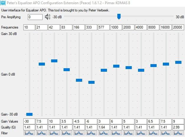

I used the free open source Equalizer APO to perform EQ. Peace is the open source GUI front end interface for Equalizer APO. Here are the exact settings:
KDMAS EQ (using splitter)
Pre Amplifying=0
1 Peakfilter Freq=10 Gain=-30 Q=1.41
2 Peakfilter Freq=21 Gain=7.5 Q=1.41
3 Peakfilter Freq=42 Gain=10 Q=1.41
4 Peakfilter Freq=83 Gain=3.5 Q=1.41
5 Peakfilter Freq=166 Gain=-4.5 Q=1.41
6 Peakfilter Freq=333 Gain=-6 Q=1.41
7 Peakfilter Freq=577 Gain=3 Q=1.64
8 Peakfilter Freq=1000 Gain=6 Q=1.41
9 Peakfilter Freq=2000 Gain=5 Q=1.41
10 Peakfilter Freq=4000 Gain=3 Q=1.41
11 Peakfilter Freq=8000 Gain=6.5 Q=1.41
12 Peakfilter Freq=16000 Gain=7.5 Q=1.41
13 Peakfilter Freq=20000 Gain=9 Q=2.99
