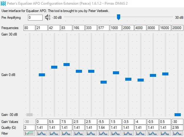

I used the free open source Equalizer APO to perform EQ. Peace is the open source GUI front end interface for Equalizer APO. Here are my exact settings for the DMAS:
DMAS EQ (no splitter)
Pre Amplifying=0
1 High pass filter Freq=80 Q=2
2 Peakfilter Freq=21 Gain=0 Q=1.41
3 Peakfilter Freq=42 Gain=5.5 Q=1.41
4 Peakfilter Freq=83 Gain=7.5 Q=1.41
5 Peakfilter Freq=166 Gain=2.5 Q=1.41
6 Peakfilter Freq=333 Gain=2.5 Q=1.41
7 Peakfilter Freq=577 Gain=-5.5 Q=1.64
8 Peakfilter Freq=1000 Gain=1.5 Q=1.41
9 Peakfilter Freq=2000 Gain=-3.5 Q=1.41
10 Peakfilter Freq=4000 Gain=-4 Q=1.41
11 Peakfilter Freq=8000 Gain=-0.5 Q=1.41
12 Peakfilter Freq=16000 Gain=0.5 Q=1.41
13 Peakfilter Freq=20000 Gain=-30 Q=2.99
Note the different filter type for slot 1.
With these EQ settings, the audio is slightly overdriven and can clip a little in some loud scenarios. The DMAS struggles to have enough volume, and this was the last bit it needed to get there. Not ideal, but it seemed the best compromise.
