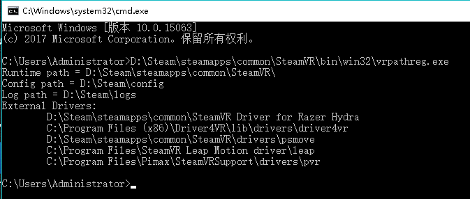

Edit: @Enopho Just now I did copy “pvr file” (C:\Program Files\Pimax\SteamVRSupport\drivers\pvr) to overwrite pvr file (E:\Steam\steamapps\common\SteamVR\drivers). But this issue only exist in old Piplays and New Piplay should not occur it in theory.
When you drag “vrpathreg.exe” (E:\Steam\steamapps\common\SteamVR\bin\win32\vrpathreg.exe) to CMD window and enter, it will show this info:
Usually SteamVR may work normally when it either detects C:\Program Files\Pimax\SteamVRSupport\drivers\pvr or detects “config”. New Piplay that have already wrote in this Config should not occur it other than old Piplay.
So please contact me if other users met the same issue, one of our engineers will join us to double-check.

thanks for the update. so the pvr file you copied in, is that something the community can access without the need to contact your engineers? the fix seems easy otherwise.
Yes, users with this issue may use this way. But our engineer need to double confirm it, so one more Teamviewer work will help us to sort it out :slight_smile:
