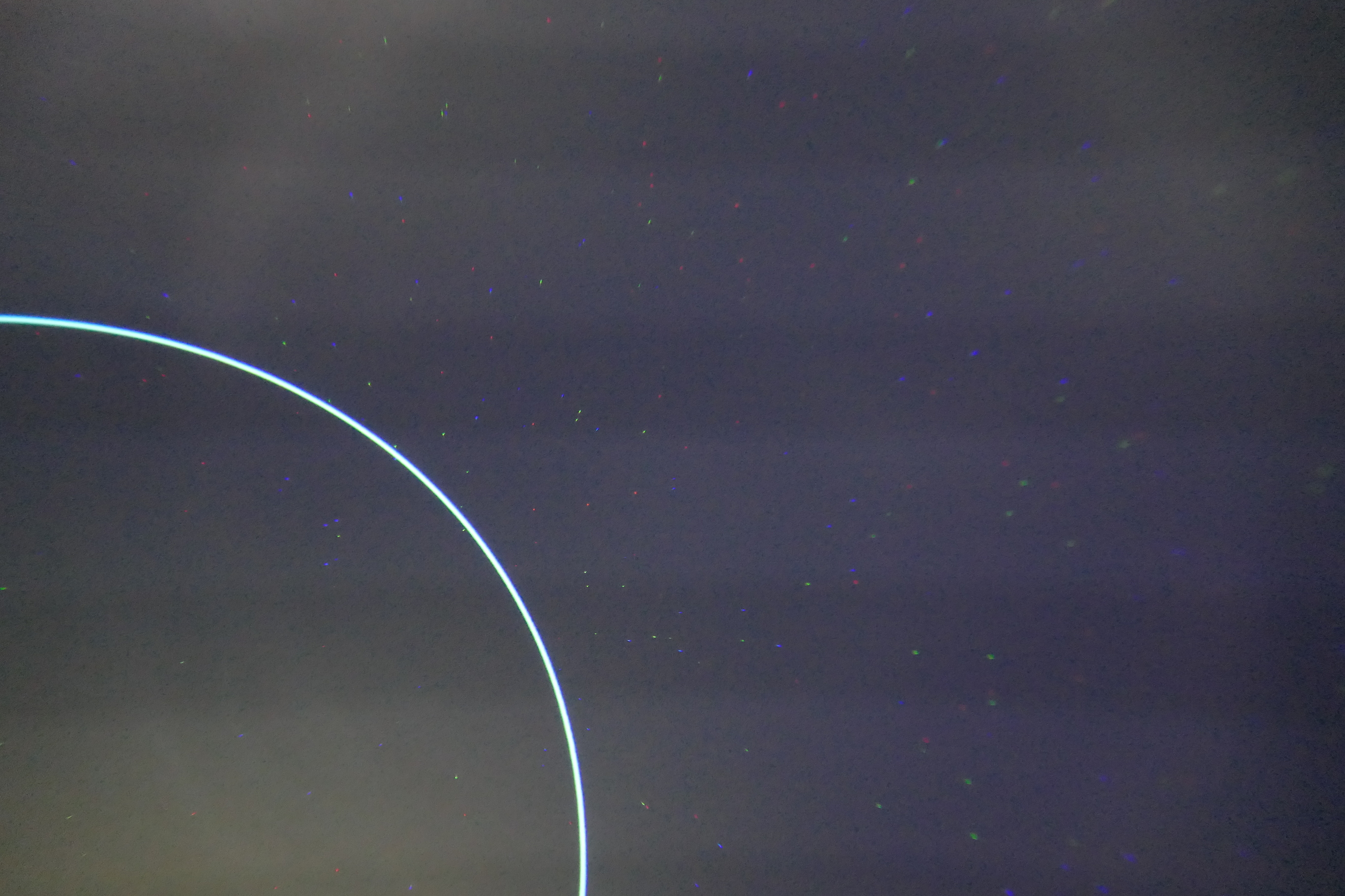

Hello
I got my Pimax yesterday but the screen pixels are randomly flashing all over.
Specially visible in dark background this is really disturbing.
See attached pictures.

I seen this exact thing today at a vr arcade on a vive. It was a faulty power cord on the headset from being twisted to often. It was connected to a treadmill. You might want to look there first.
Check if the cable is correctly seated in the headset too.

Well second cable didn’t work and now the second headset didn’t work too. It’s either an environmental issue maybe EMC or I am not lucky or the whole batch is defective…
I tried to wrap the cable with tin foil but nothing, also tried the headset in different room still those damn dot everywhere.
It starts almost ok but it get more and more random dots over time…maybe over heating of some components?

so it may be the graphic card or the computer. Have you tried it on a different PC ?
Agreed try a different DP & if available another of pc.
No second PC with VR capability.
I tried all DP already on both Headset.
I have the same problem 5k+
I have the same issue on my replacement 5k+ as well. For me the issue is there about half of the time when I turn the headset on and the other half of the time it works perfectly with no flashing pixels. If it is there I just switch to a different DP port on my GPU and restart the headset and the problem will be gone.

Would the problem possibly be because the power line is generating interfearance to the hdmi line ?
I am running a pimax on a i9 9900k on Asus maximus XI Extreme air cooled with noctua. 32gb of ram G.SKILL TridentZ RGB Series 32GB (4 x 8GB) 288-Pin DDR4 SDRAM DDR4 4133 (PC4 33000) F4-4133C17Q-32GTZR
Msi 2080 ti trio as video card
Quite possible @park bought one or 2 of these. Follow the thread ashe postedwhere to order. Some display cables come with these pre-installed. They help to filter out emi/rf interference. Park also ugraded his wall plug.
