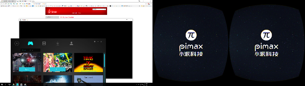

The pimax shows the logo and flashes between my desktop background and stays there. Then when I start any pimax game there is a black window but there is nothing happening. The Pimax shows the logo but nothing is going on. While my mouse and desktop lose focus. (I need to alt+tab out of it)
