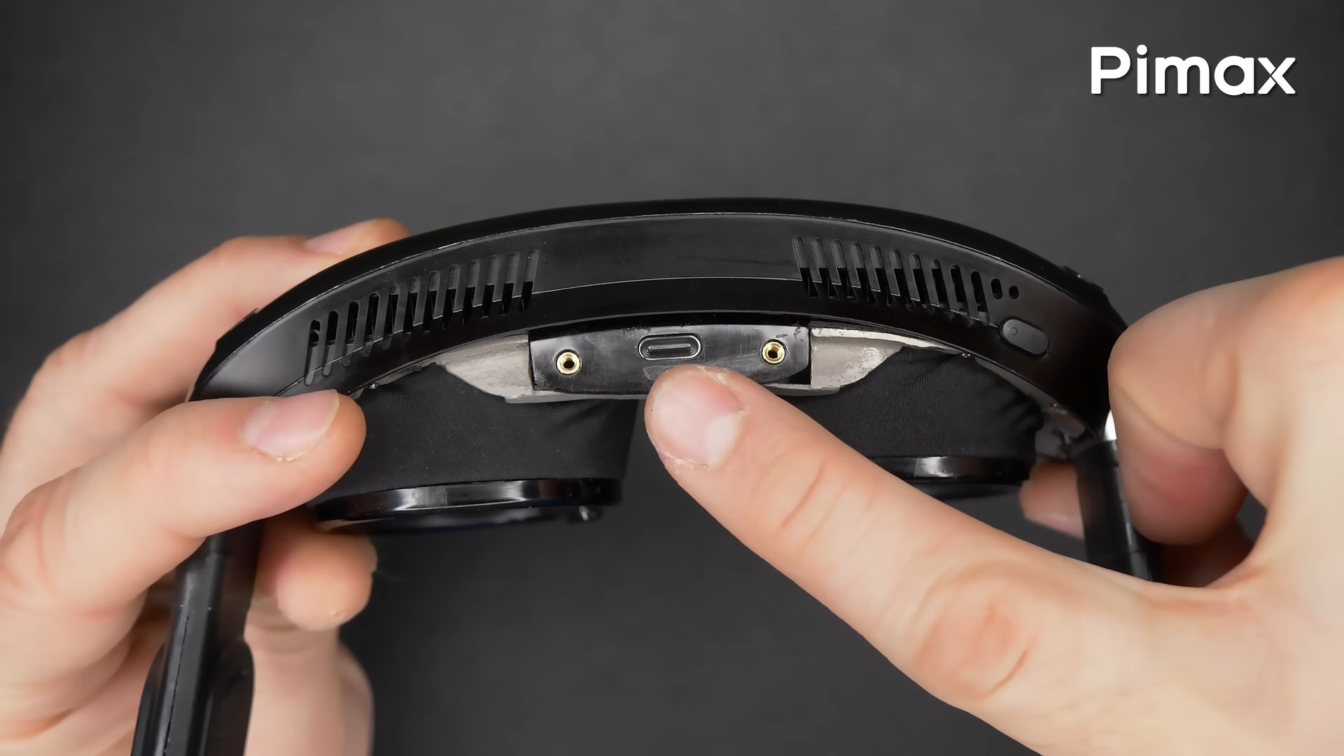

I’m considering buying the Pimax Dream Air, but there are some questions that concern me.
What are the specifications of the USB-C port on the top of the VR headset?
  1. What is its bandwidth (speed)?
  2. Can it be used to connect color cameras?
  3. How much power does it provide in watts?
  4. Does it accept power input?
  5. Does it use the USB Power Delivery protocol?
  6. Since this is a wired VR headset, does that mean this port is simply passed through “as is” to the computer, with the headset acting just as a USB hub? E.g., if I connect a USB flash drive, would I be able to access its files on the computer?
@PimaxQuorra @SweViver @jaapgrolleman cc
  1. USB 3.0
  2. TBD
  3. ≤5W (5V, 1A)
  4. No.
  5. No.
  6. Yes.
