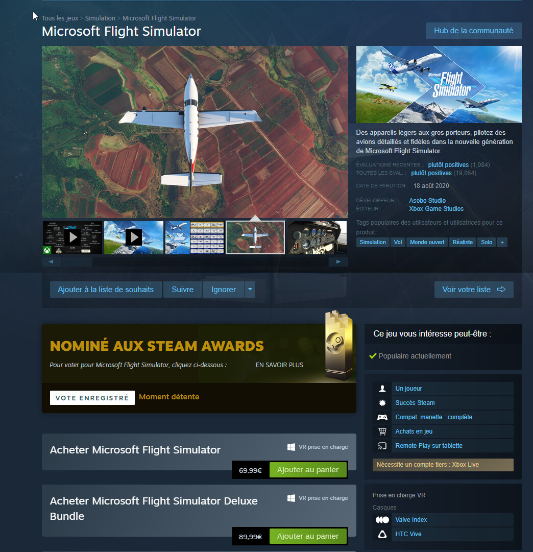

U talk of this flight simulator :
i don’t have it

i m french so i used the french version of this version u got :
i can’t found a VR headset support
i think this version don"'t have the support for headset VR, u have to use VorpX for that
or bought the Steam vr version, i supose not sure
