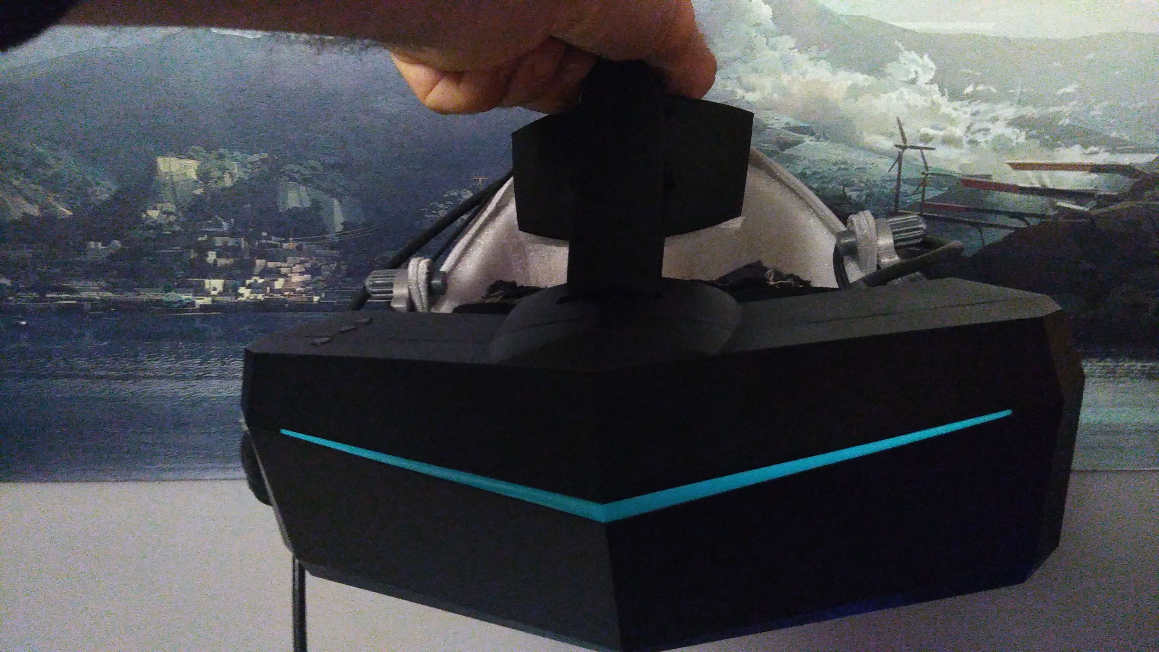

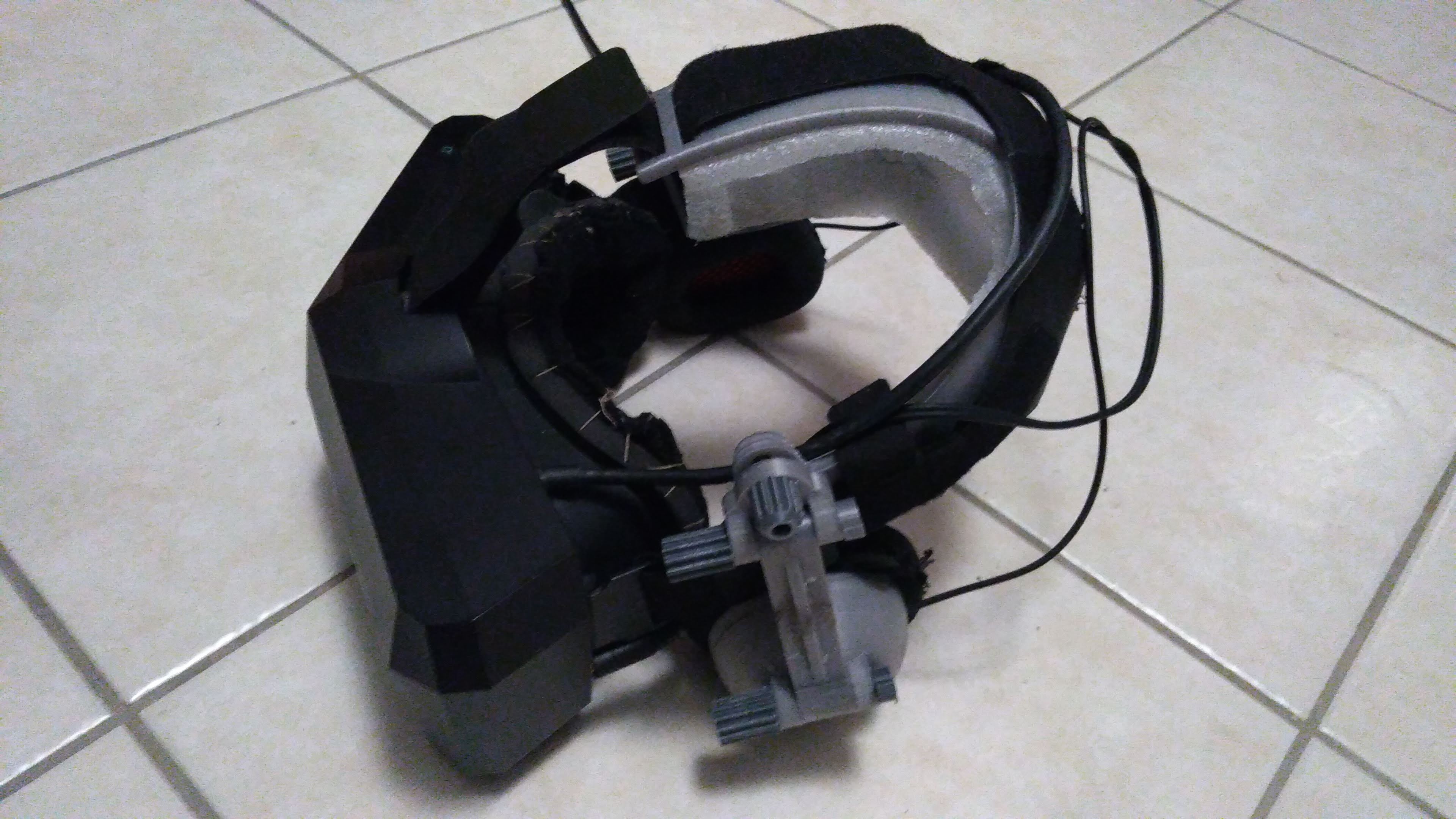

My printed upgrade for the original Pimax 8k/5k+ headstrap.
As you can see on the pictures I am running out of foam but even with some pieces its already much better, of course it have to be foam everywhere for optimal comfort.
Original straps just pass thru it.
Easily adjustable and dont even need to release to remove headset, while holding the printed part we can slightly strech it to put it off.
And bonus so easy to put on now.

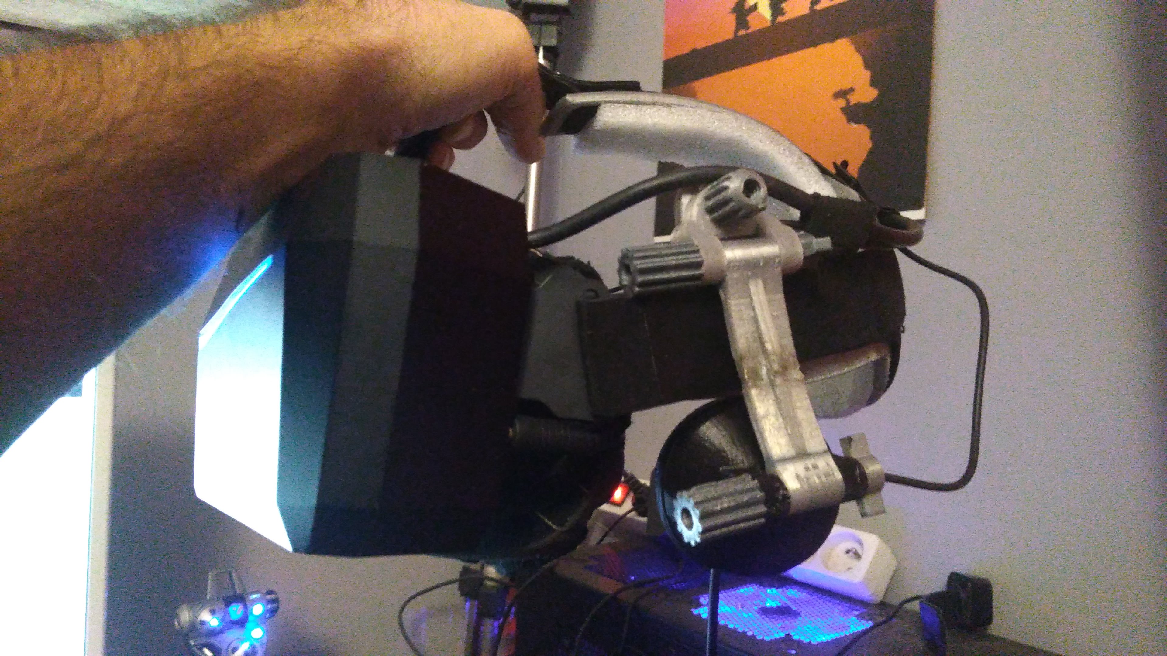

HEADPHONE UPDATE:
Ok lets call it V1 since everything can be enhanced but it does the job pretty well actually ![]()
Some printing instructions and where to download are here → Pimax 8k/5K+ headstrap with headphones upgrade by adonfff - Thingiverse
I will try to see if I can make something to get rid of the rubber bands so its easier to put on.

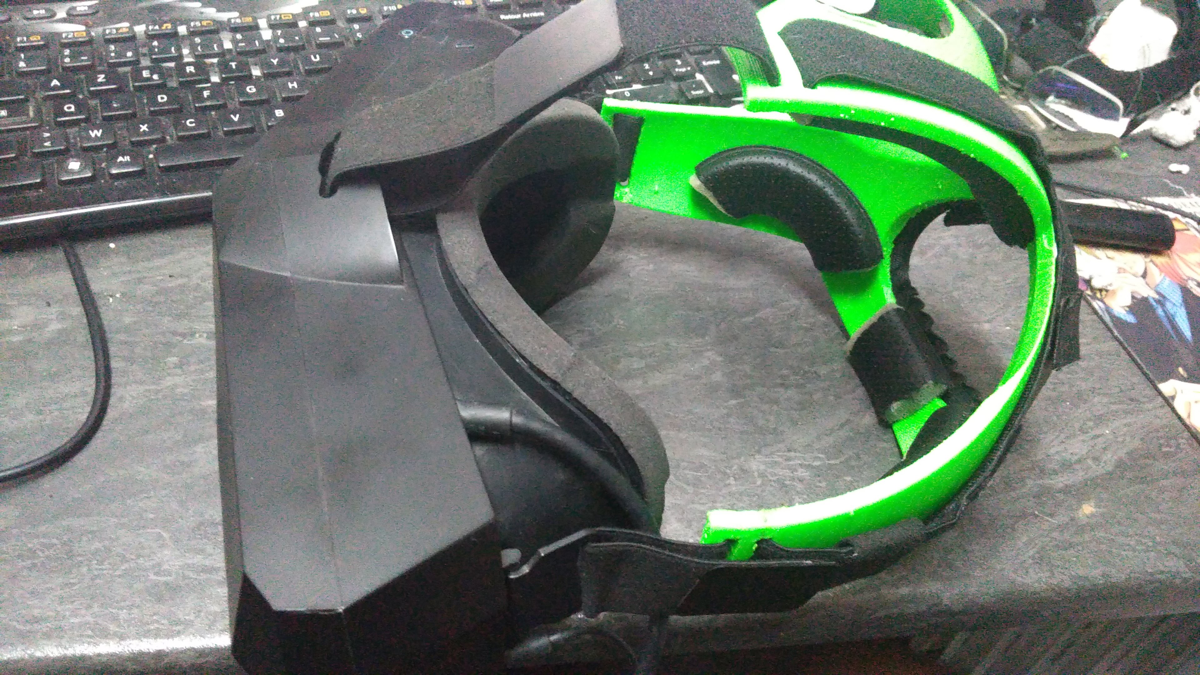

UPDATE 2 :
New link is Pimax 8k/5K+ headstrap with headphones upgrade 2 by adonfff - Thingiverse for lastest version
UPDATE 3:
Added 60, 45/50 and 45/50 tilted headphones foam cushion size.
Best is 45/50 Tilted, with → https://fr.aliexpress.com/item/32969877364.html?spm=a2g0s.9042311.0.0.27426c37HtBbrd
Download link → Pimax 8k/5K+ headstrap with headphones upgrade 2 by adonfff - Thingiverse
