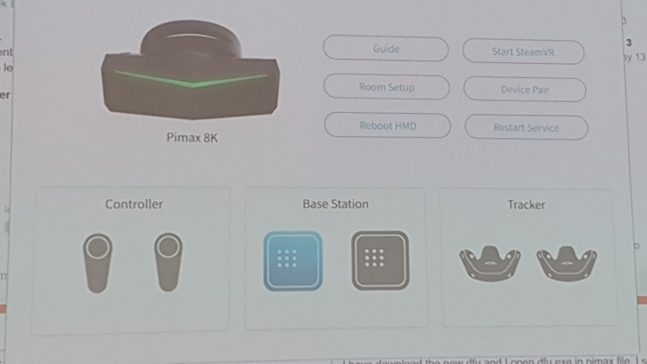

Edit: I also try the Sweviver method (youtube video) and all the installation went well but in pitools the refresh rate is 80 72 64 hz just like an 8K (and in the status page on pitools is an 8K).
Wouldn´t have you sent me an 8K instead of 8k+,no?

For some reason Firmware Tool is showing the HMD as Pimax P2 5k Formal, with 200 SN. I did replace a 5k+ that was connected to this machine.
Ok. Re-flashed to the rollback FW, and the HMD shows the correct info in the Firmware Tool. Re-flashing the Alpha puts it back to 8k refresh rates and changes the SN in FW Tool.
