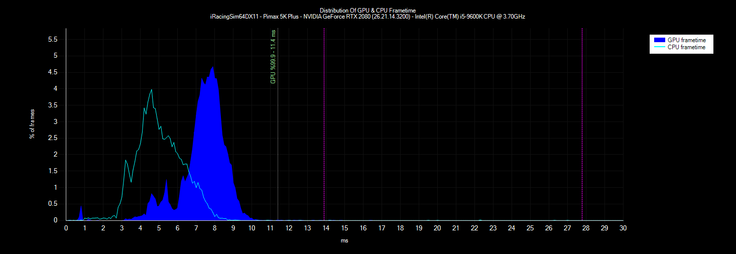

As JoCool said, low GPU utilisation, judder when the world rotates around my view point, stutter in higher load situations. I ran a 2 lap replay file in .144 and the latest .258 Alyx pitool and with .144 no rotational stutter or judder and 40 - 50% GPU utilisation. With .258 i get rotational stutter and decreased GPU usage. FPS stays consistant in both version, here are the outputs from FpsVR,
.144
fpsVR Report:
App: iRacingSim64DX11 HMD: Pimax 5K Plus (71.999 Hz, IPD 63.0)
GPU: NVIDIA GeForce RTX 2080 (26.21.14.3200) CPU: Intel® Core™ i5-9600K CPU @ 3.70GHz
Delivered fps: 70.57 Duration: 4.7min.
GPU Frametimes:
Median: 7.6 ms
99th percentile: 9.5 ms
99.9th percentile: 11.4 ms
frametime <13.9ms(vsync): 100%
CPU frametime:
Median: 4.9 ms
99th percentile: 8.2 ms
99.9th percentile: >30 ms
frametime <13.9ms(vsync): 99.4%
Max. SteamVR SS: 66%
Render resolution per eye: 3464x2140(by SteamVR settings, Max.) (HMD driver recommended: 4264x2634)
.258
fpsVR Report:
Delivered fps: 71.87 Duration: 4.4min.
GPU Frametimes:
Median: 6.1 ms
99th percentile: 8.1 ms
99.9th percentile: 9.5 ms
CPU frametime:
Median: 7.2 ms
99th percentile: 10.6 ms
99.9th percentile: 11.7 ms
Render resolution per eye: 2772x1708(by SteamVR settings, Max.) (HMD driver recommended: 3412x2102)
