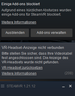

  • SteamVR failure:
    grafik
I already did a cold boot, no change.
I’ll give a SteamVR reinstall a try now - but at least, this certainly isn’t what is supposed to happen…
EDIT:
Okay, seems to work again:
I did a clean re-install of PiTool .277 including deleting manually the four Pimax/Pitool folders in AppData and reboot.
At first, it did not work yet - it took me a moment to realize that there is a new feature in SteamVR which locks the Pimax PlugIn - so I had to unlock this PlugIn.
Now, I have image again.
Apart from this, as mentioned above already, the headset is recognized at once again :+1:
