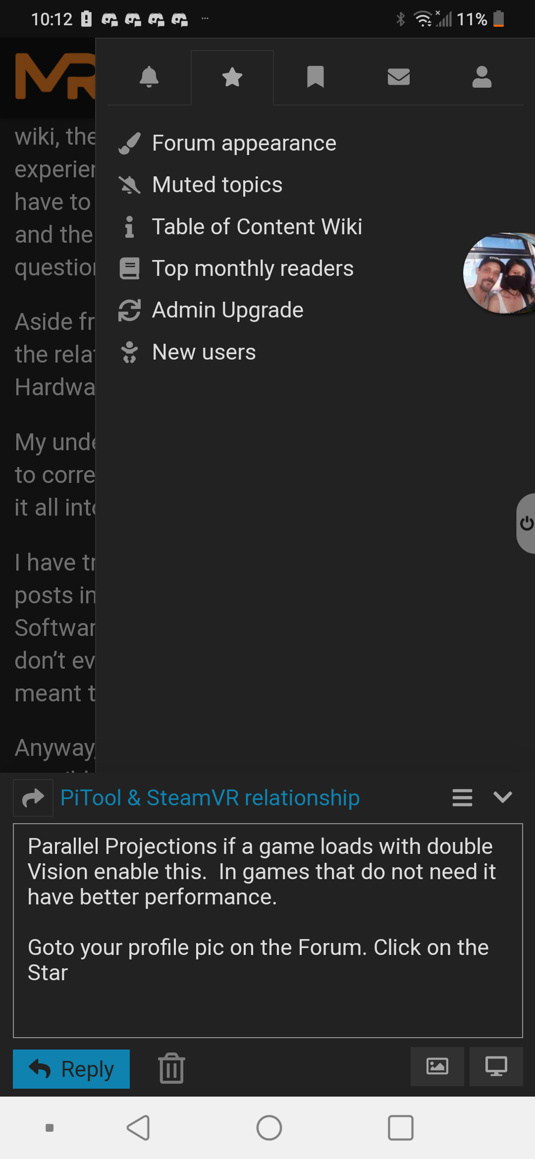

Parallel Projections if a game loads with double Vision enable this. In games that do not need it have better performance.
Goto your profile pic on the Forum. Click on the Star
Table of Content Wiki has a collection of links to helpful info on Pimax Hmd and links to the new Guide Category(Table currently has more links)
