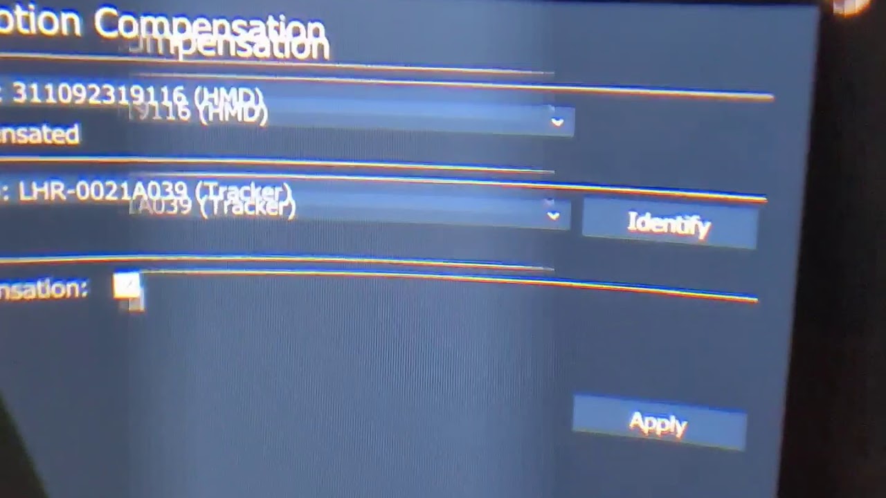

No luck for me, I allways end up with this, when I move the tracker/controller this is what hapens ;

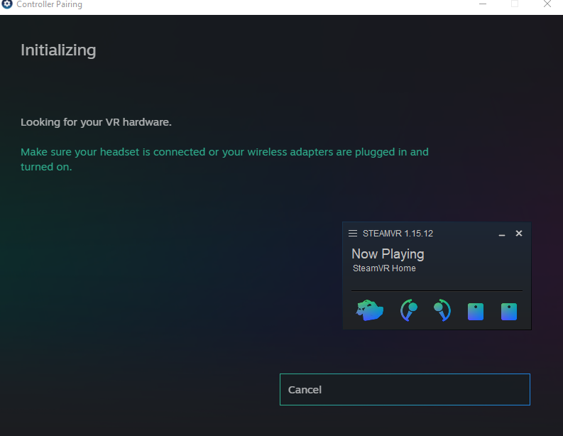

I’ve it paired with the dongle as well, but in Pitool, if I try to pair it via SteamVR I got the message; looking for VR hardware and nothing happens, it only works with the Index connected.
So with Pimax connected you select Pair new device in SteamVR and you pair the tracker there?
Hmm probably that’s what I have manage to do.
And the tracker appears on Pitool as well or only in SteamVR?
Yes, that is correct.
No matter what I do, if I have Pimax conected and try to pair new device from steam i got this message;
I have the Pimax headset and the dongle connected.
If I have the index connected I can pair all the devices I want, any idea?
It seems the bluetooth in SteamVR is only available when Index hmd is connected
Pairing the controller / trackers to the headset / dongle, does not use BT. BT is only needed for “other” management (i.e. lighthouse power and channel management).
Yes I’ve read it, so a new tracker only can be paired to the headset via Pitool, not SteamVR
Then I don’t know why I’m getting this weird effect with OVRMC, maybe it’s not compatible, but it seems to work with others, any idea of suggestion?
This is the filter for Motion Compensation, it reduces all the vibrations inside the HMD;
LPF value, and DEMA sample
@Alex.liu @SweViver @PimaxVR
