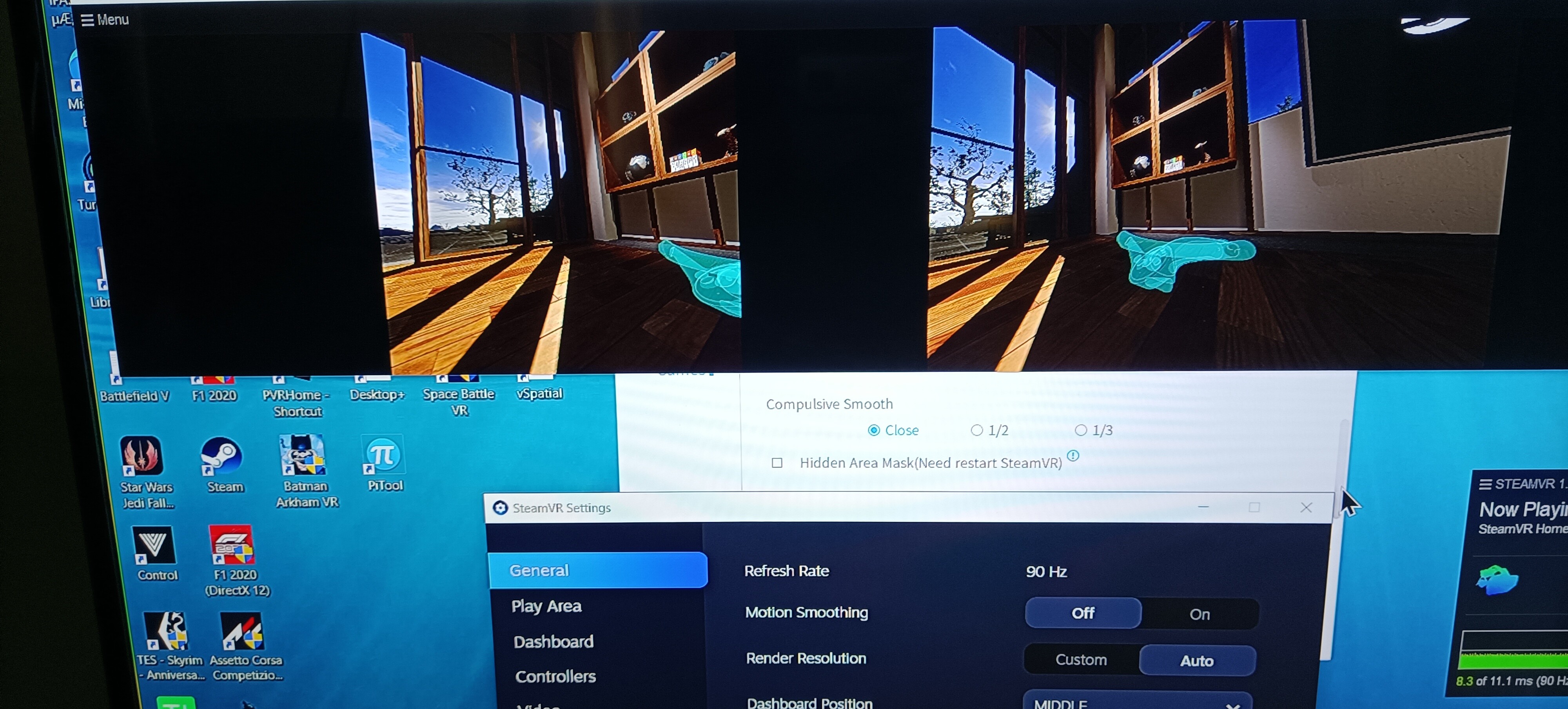

I do not have a complete left eye.
in small I have what looks like too right eyes.
Here one pic mask OFF.
Mask ON small FOV
ON Large FOV
Mask ON Normal FOV
Mask ON Potato FOV
They all look wrong. The right eye looks ok, the left looks wrong.

at steam home i can see curves cornes when its on an square cornes when is off
is there another thing to see o feel?
What I did was uninstall PT/ delete any folder related to it, restart your PC, and reinstall PT again.
That is the correct description. Thanks for confirming.
However, if you look at my photos above, there is more to it that just the corners. I think there is something wrong, and that i why i am asking?

That was the wrong video anyway, but what you are experiencing was the same issue, which was corrected when I uninstall PT and reinstall it.
