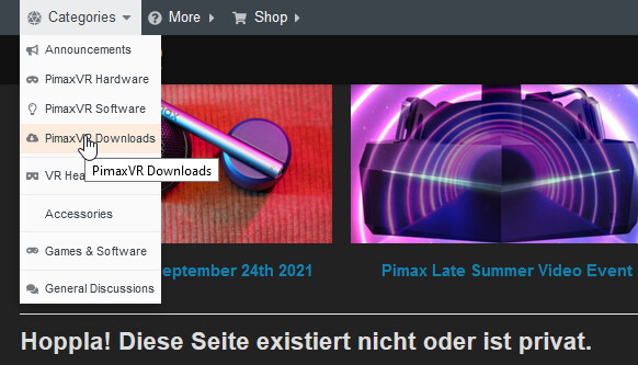

Seperate download links, support and information from Pimax on this side has become quite bad… :confused:
Pimax VR Downloads doesn’t even work… :
grafik
