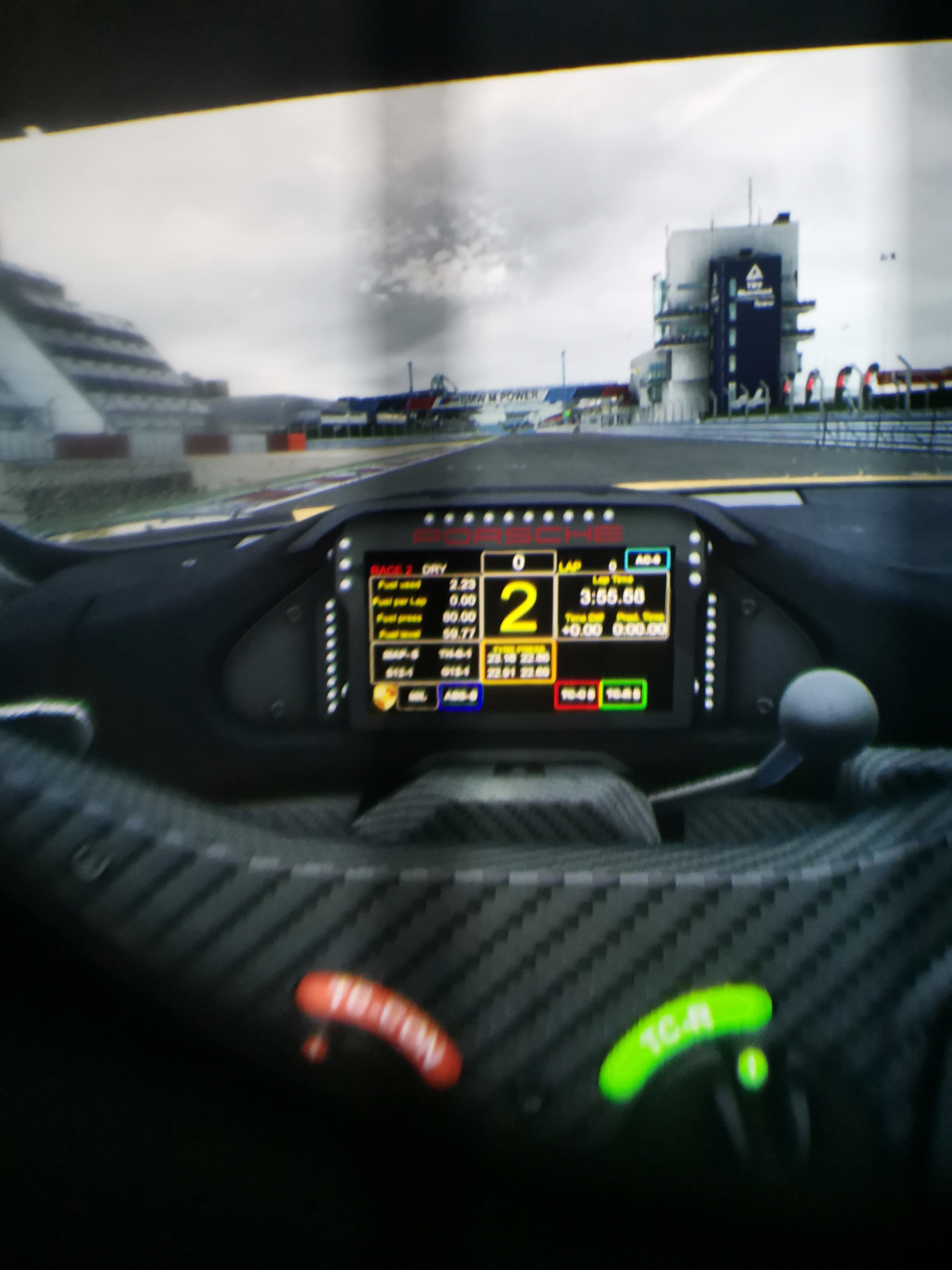

OK, just force updated windows to 2004 and activated the GPU scheduling, new pitool and other updates and tested ACC, damn never had that before, used to be about 54FPS, now hitting 80!!
I do have a running vertikal bar in ACCs menus, but not in game/racing. I guess an ACC bug.
Will check. More games tonight.
Very promising!
(Sorry, phone app/browser got stuck)
Edit: I removed the GPU scheduling again, it caused the menue flickering issues and does not add any benefits as of now for me. All FPS boost is pitool related.
Care to share your spec’s and settings, i’ve been wanting to play ACC since early access but have never been able to get it to run properly without MS, from your screen shot it looks like I would be able to as i run at 72hz?
do you use 2080ti whit GPU scheduling?
My Specs
i9 -9900k, EVGA RTX2080TI, 64GB RAM
I used 1.25x in PITool, Aggressiv FFR, Normal FoV and Steam at 100%.

I had some time with the 262 PiTool yesternight. Mainly it runs very good.
I did have an issue in ACC - vertikal bars (looked like parts of the picture from another position) that flickers through the image - and then strong stutters, especially when moving the head - in all Games (Automobilista was really bad). I could not figure out what it was until I rememberd an issue we had quite a while ago.
I slightly changed the config of my GPU (RAM Mhz) and updated it to the GPU - and like a magic wand, all was fine again.
I remember that @SweViver mentioned somthing a while back, where there was a boost if you did something the same thing.
After that one time, all was almost perfect - performance in ACC and Dirt 2.0 was amazing!!! easily added about 15-20 FPS in those games for me going from 50ish to 70-80FPS!
Only Automobilista keept having issues - it seemd like its due to the Parallel Projection, I have not figure out why.
