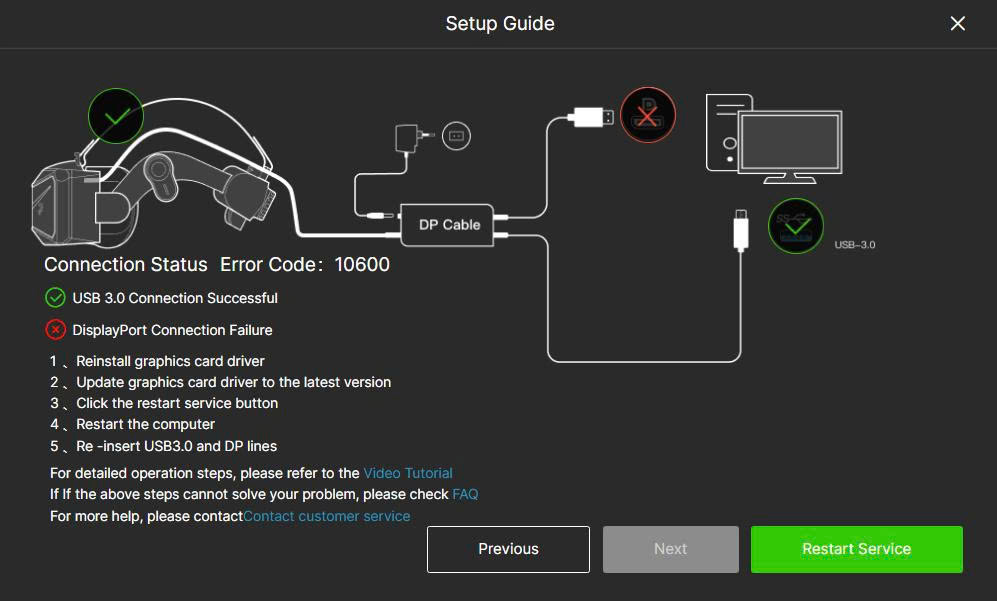

  • PimaxPlay only detect headset once the DP port connected to weaker one.
  • Once try to connect to the main GPU, app can’t detect the headset with following error
