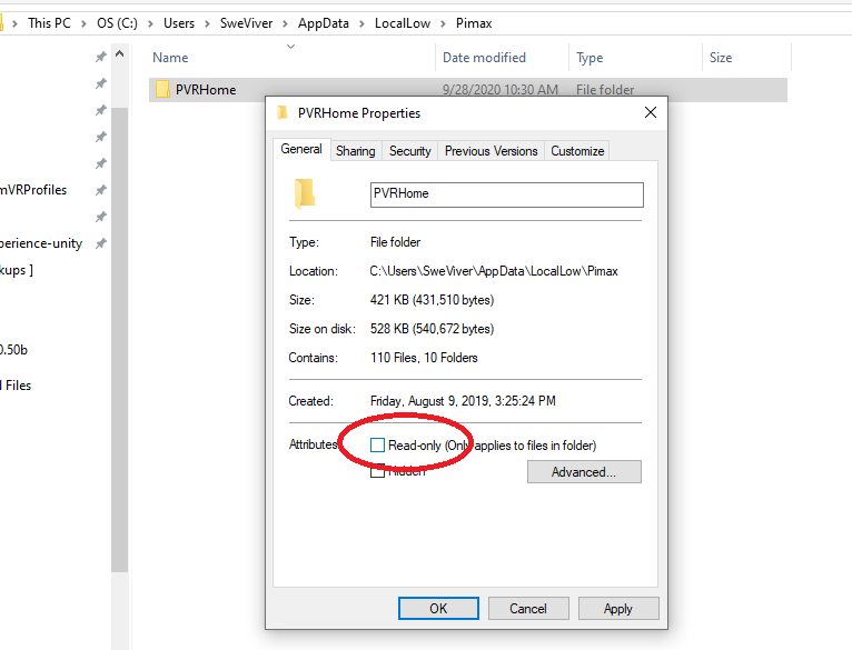

For those of you having issues where userSettingsPVR.json is not created (and you only see an empty background), could you please check so the PVRHome folder in *C:\Users\user\AppData\LocalLow\Pimax\PVRHome* is now read-only?
The only way I can replicate this problem is if I make the entire directory read-only.
So please untick the read-only, and try starting PE again.
We are trying to determinate how and why this happens on some PCs.
Hi @SweViver,
Thank you so much for all the effort you and Armin et al are putting into the creation of PE !
Just tried to find the userSettingsPVR.json file again, making sure that the Read-only in the PVRHome folder was unchecked. Did a new installation of Pitool 1.0.2.084.
But still no luck. No userSettingsPVR.json file to be found in the PVRHome folder.
However when looking at the output.log and Player.log, I found a few things which I do not understand, but may be significant for you. Maybe this could provide a clue as to why I do not et a userSettingsPVR.json file.

I see. We are still working on this, havent found the cause though.
Could you please post the entire log here:
Just paste everything and click ā€œCreate New Pasteā€ and send me the link to the page.
Thanks
