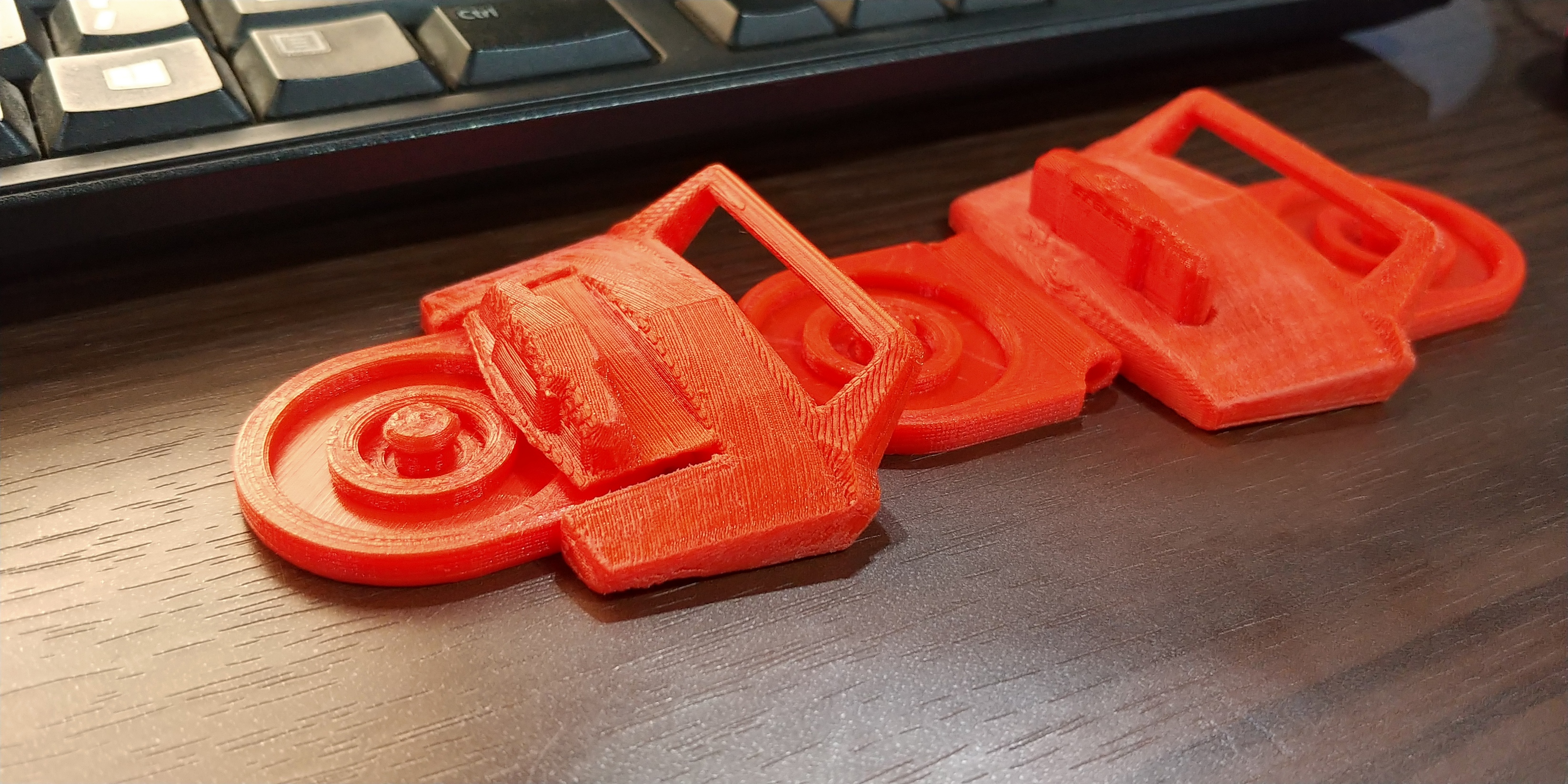

Just finished printing. @Dr.Cube thx.

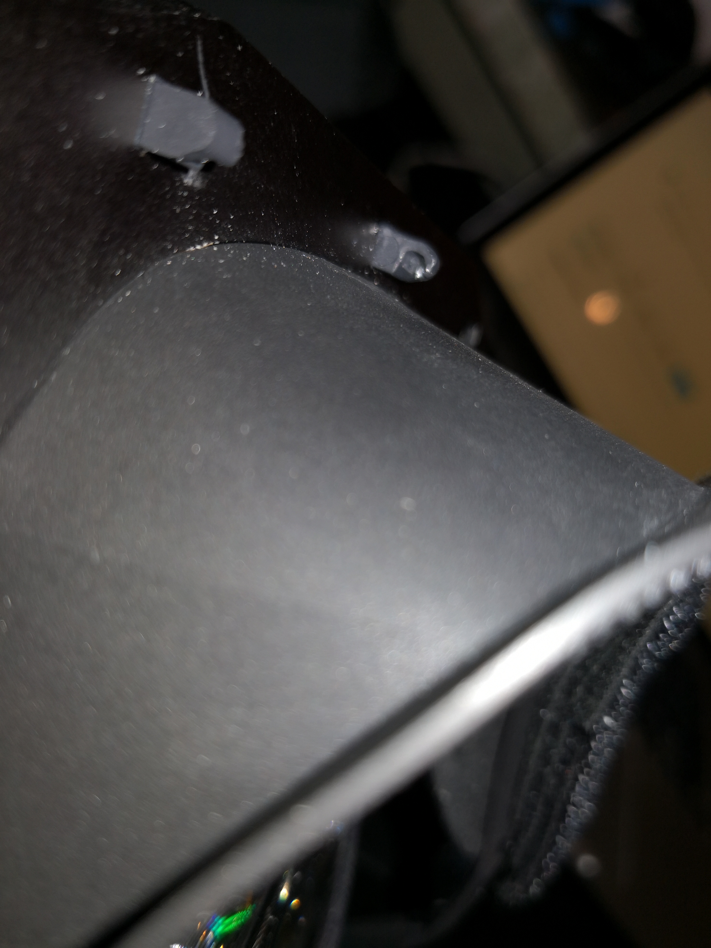

I don’t know if Pimax has made any redesigns to the plastic cover that you’re supposed to pull out from the headset to get at the rods? I’m a pre-order buyer (not a backer) and the plastic just wouldn’t come off - seriously! The amount of force I was putting in was really pushing the limits of totally breaking the entire housing apart. This is how much I managed to get off:
It just wouldn’t come off no matter how hard I pulled, pushed or twisted in all angels and places of the headset. So then I tried to just push the side clips onto the headset rods anyway, like Tyriel Wood does in his instruction video, and that’s when one of the hinges on my headset broke.
@Dr.Cube I really appreciate the work you’ve put in to making and sharing this adapter, but I would strongly recommend you or someone else revising the design of the side clips by switching sides of the hinge opening from inside to outside, so that you can click them into place more easily and safely, in case new owners find themselves in my situation. Like so:
Hopefully I can superglue the headset hinge and rod back into place, but it seems I’m in limbo with mounting the DAS at the moment as I can’t get the plastic cover off the headset, nor push the side clips adapters into place without breaking the headset hinges. I’m open to more specific instructions on how to do it if anyone has any. Otherwise I’ll just have to make a wish that @Dr.Cube or someone else would be kind enough to do the redesign I suggested (as I don’t have the skills for it).

Just finished printing these… Thanks Dr.Cube. Still waiting for g-coded’s design to finish printing…

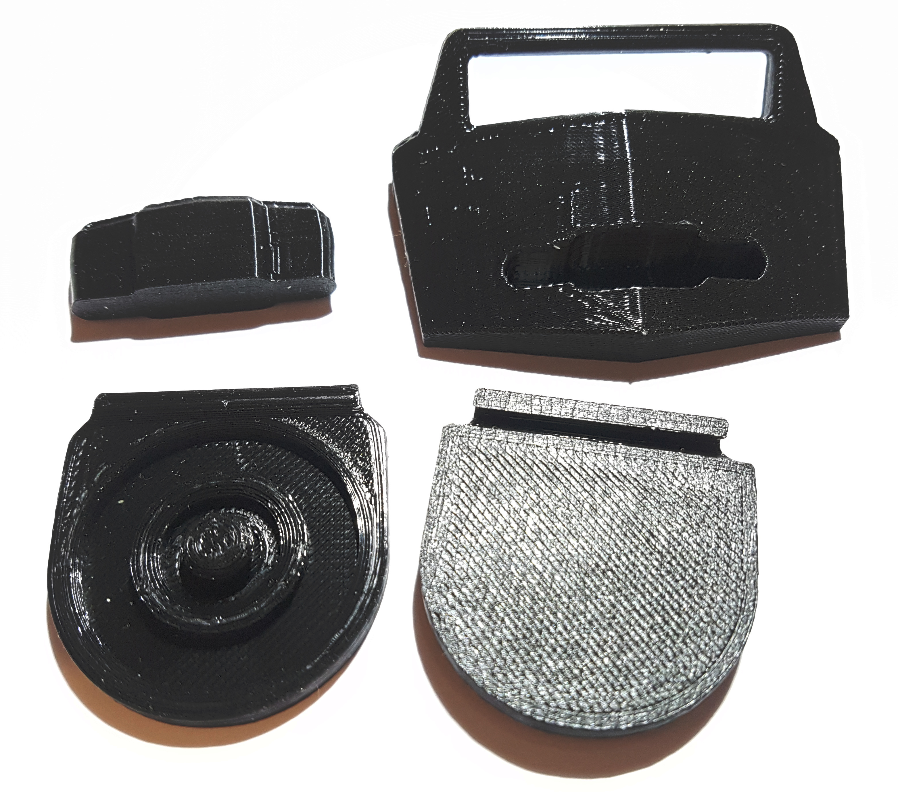

In my case, g-coded’s design looks awesome but like you said, it’s not exact science. I couldn’t get the holes to line up so that the peg can secure them in place. The left bit is slightly better aligned than the right bit. I’m curious to see if the design can be tweaked a bit for better alignment since the idea is very good.
I think each part should be split into two pieces, with the bottom part that sits closer to the Pimax unit having an indentation for the peg on the upper half or outer half but the inner half should have the DAS swivel peg that goes through the outer half and the outer half have the peg that goes through the loop and pegs into the inner half thus the two are connected and held in place by the DAS itself. I wonder if that can be done.
