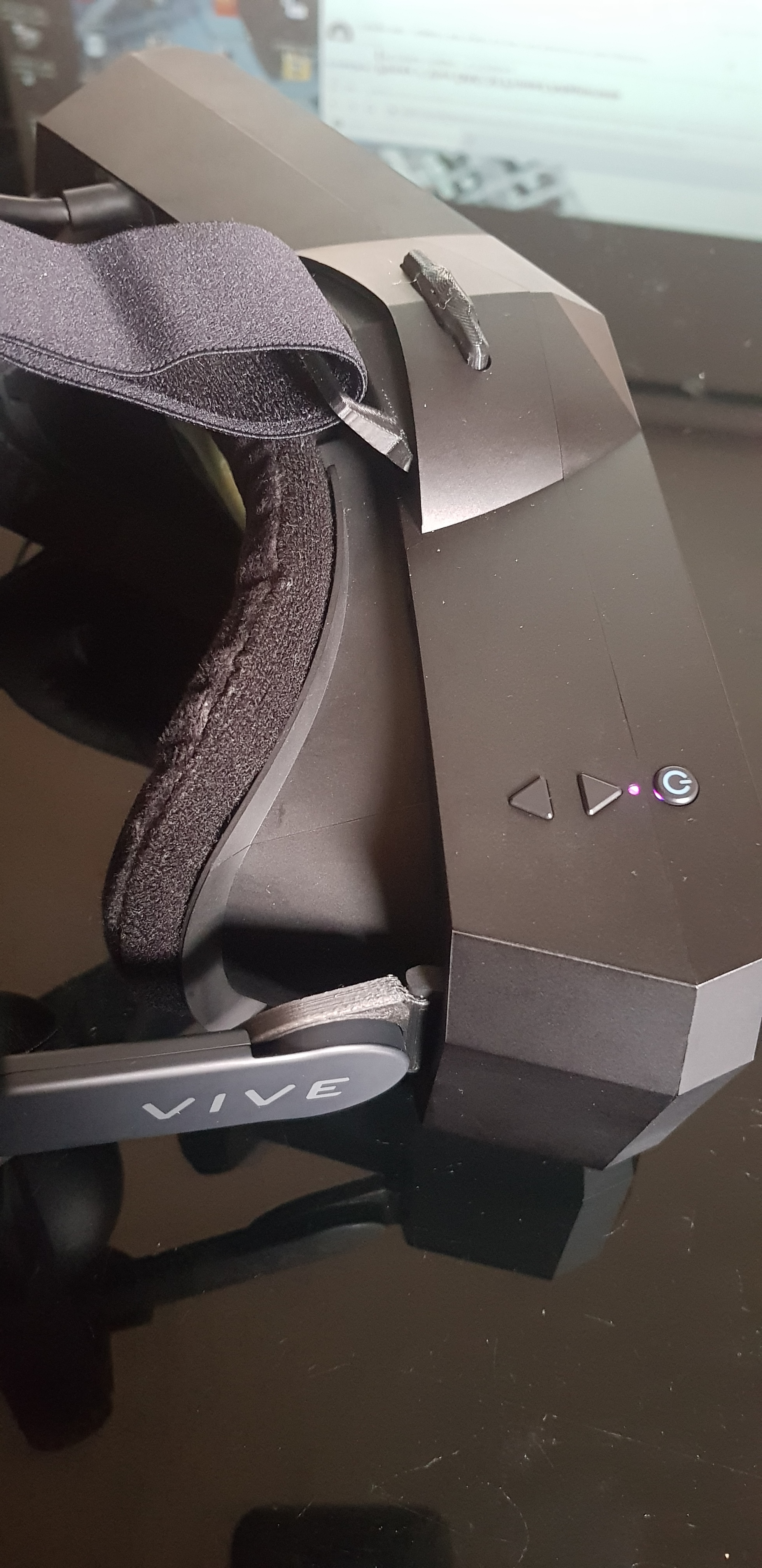

You definitely want the short version even with a large head as the DAS extends out really far, but only goes so tight because it’s not attached to the sides like the original Vive.

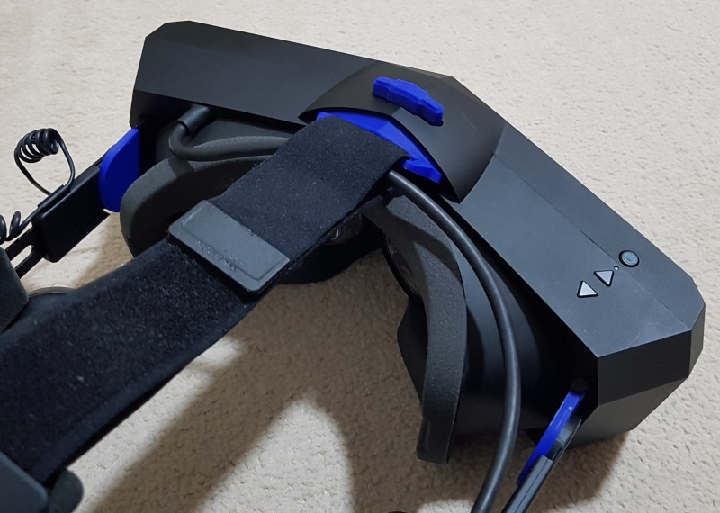

Had to use a bit of sandpaper on the middle pegs as freshly printed they were slightly too big to clip into the DAS, but only took a minute and they rotate smoothly. Also it’s easiest to clip the adapter into the DAS first, then extend the DAS out to max and clip it to the bars.
Putting on the Pimax is now a breeze and it no longer puts pressure on my nose ![]()

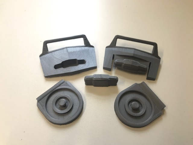

I’ve printed about 8 of these now and the hinges keep breaking on me. Is my PLA material not strong enough or what is going on? I’m scared to even use them while in VR but the top printed piece seems plenty strong.
hmm, make sure you are printing with at least 90% infill. Also are you removing the rubber housing around the lenses when you install them side hinges ? You shouldn’t have to use any force to attach them to the headset.

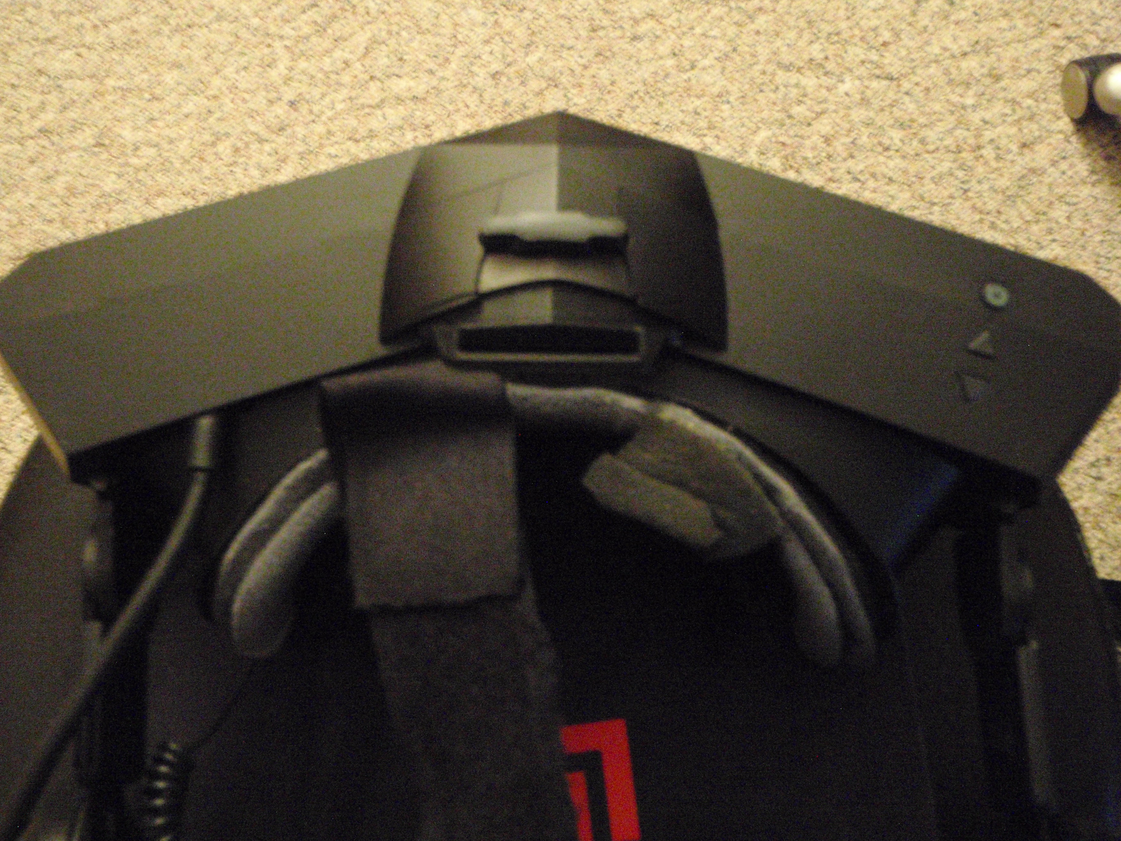

I had the same issue. I just super glued the adapter to the original piece I removed for the strap, and it works perfectly. That piece seems much stronger than the hook on the printed part…
I think this is great of you sharing this with the Pimax community. I just wanted to say thanks for your work and to let you know I recieved my 3d printed parts today from the files you provided. Applied the peg top strap version and side mounts snapped right into place. Printed in black PLA with 100% infill. Little over $20 us including shipping from Print a Thing. Arrived in less than a week. Definitely an improvement over my simple attachment method.
