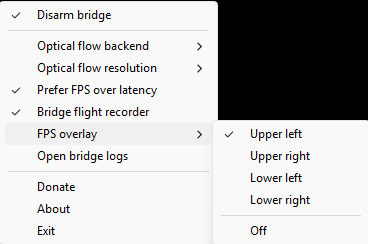

Right now I’m running OFB=Slow, OFR=50% I have the FPS on, but I do not see a counter in game.
How do I know if it is working or not?

I have a 5090 and I would recommend to leave the default, Nvidia medium, 50% optical flow, and keep FPS over latency. If you selected the FPS in the FPS overlay, you should have a green FPS number showing when in VR. The tray icon should be green when OFXR is armed and ready.
If you select bridge recorder before starting the VR session, you should see two squares (green and purple flashing very quickly), if you don’t see them, something is wrong and OFXR is not working.
Then you can go to Open bridge logs and send me the .log files in there so I can have a look.

Thank you for the help. I failed to RTFM and I was running SIMVROptimizer to launch the sim, which caused OFXR bridge not to launch.I got it all sorted out!
