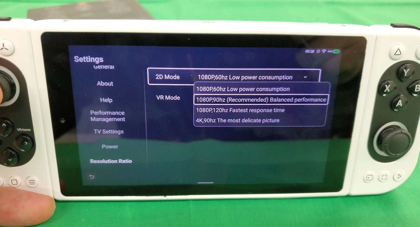

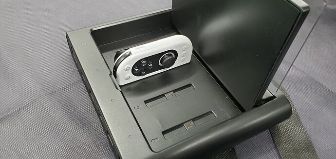

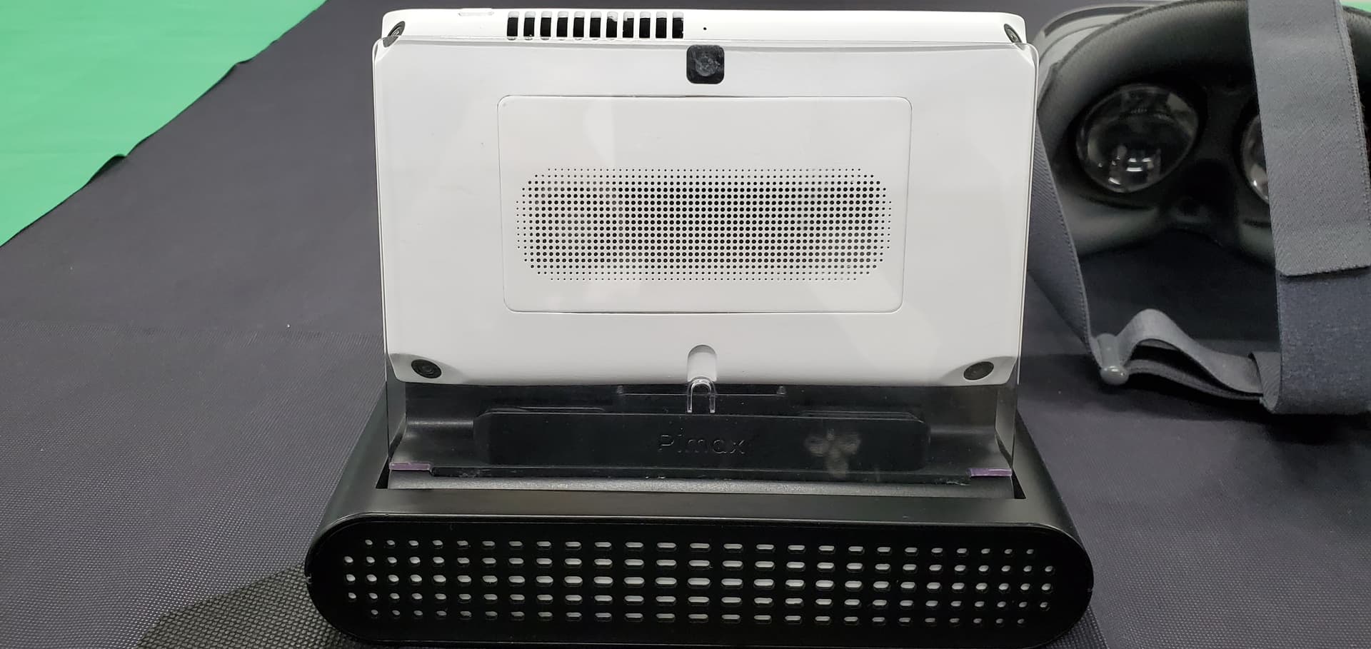

I think the PORTAL may work well in Japan, a country where many use public transportation to go to and from most places. One often sees some handheld device and people of all ages playing some type of game on their commute.
However, since many competing products have already established themselves here, it will be a challenge and an uphill battle for the PORTAL to gain market share in my opinion. A lower price and simplistic yet powerful features will be part of what it will take to battle for a place in the market. PIMAX should prepare for the long haul in my opinion.

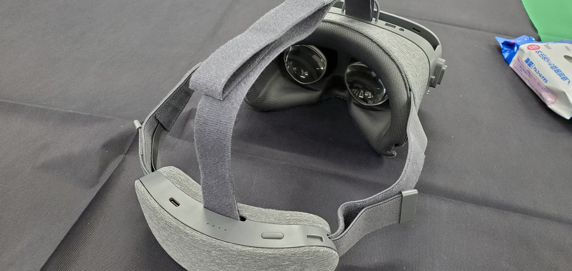

The VR aspect of the PORTAL I felt was borderline gimmicky. I think for some BASIC entry into the VR space and having some minimal VR capability is a nice to have, and if one doesn’t have high expectations of quality, then the price is certainly reasonable. I’m obviously not the target market for this.
The PORTAL itself was great. It ran very smooth, visual was crisp and clear. The controllers also worked pretty well too. I would have liked the screen to have more brightness. It was maxed on my settings, but I still felt it wasn’t bright enough.
Build and quality of the experience of the PORTAL, I felt that it’s like 90%+ ready to go to market from the hardware perspective.

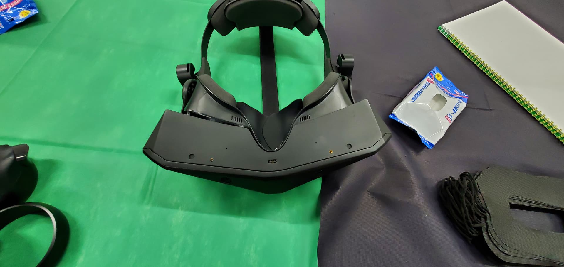

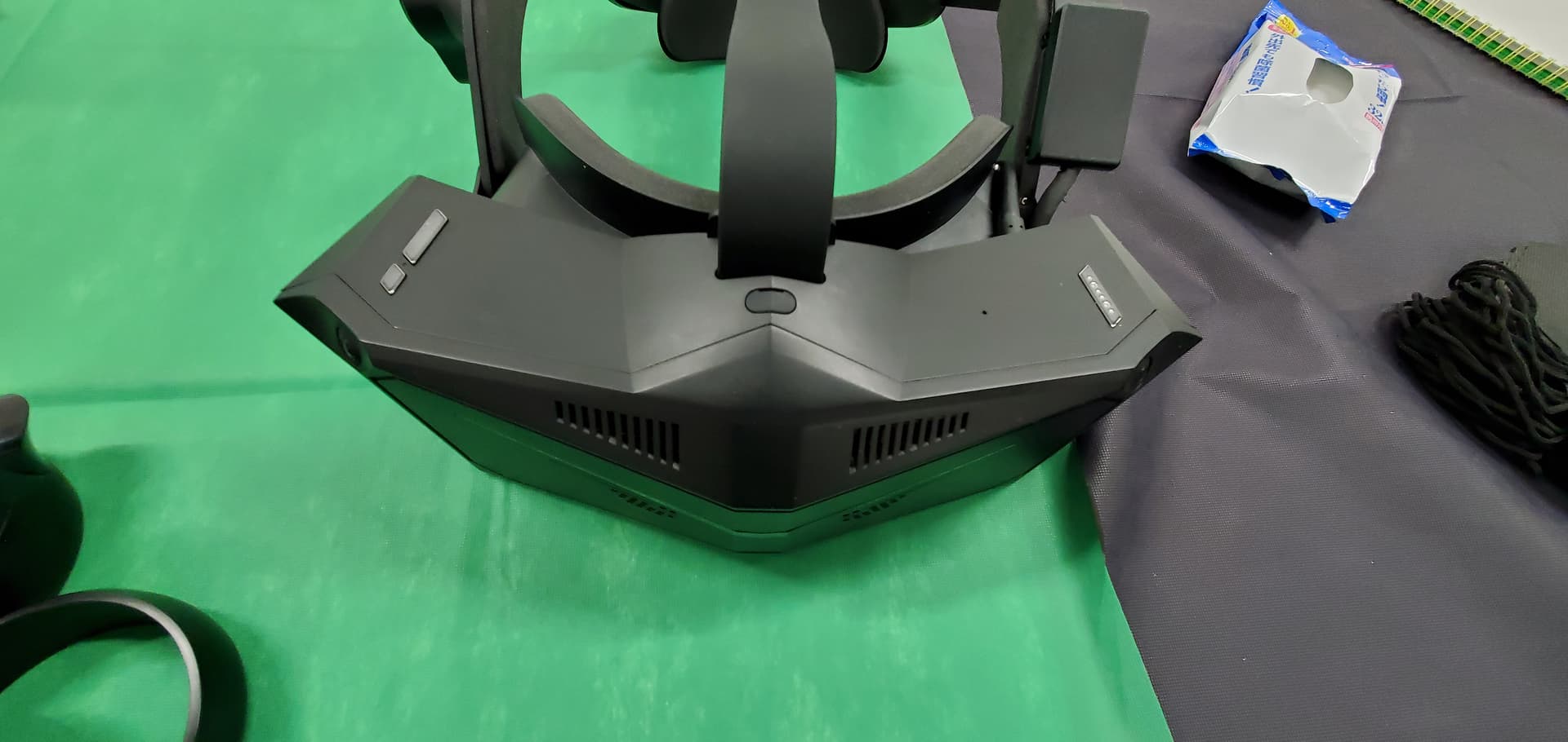

THE CRYSTAL:

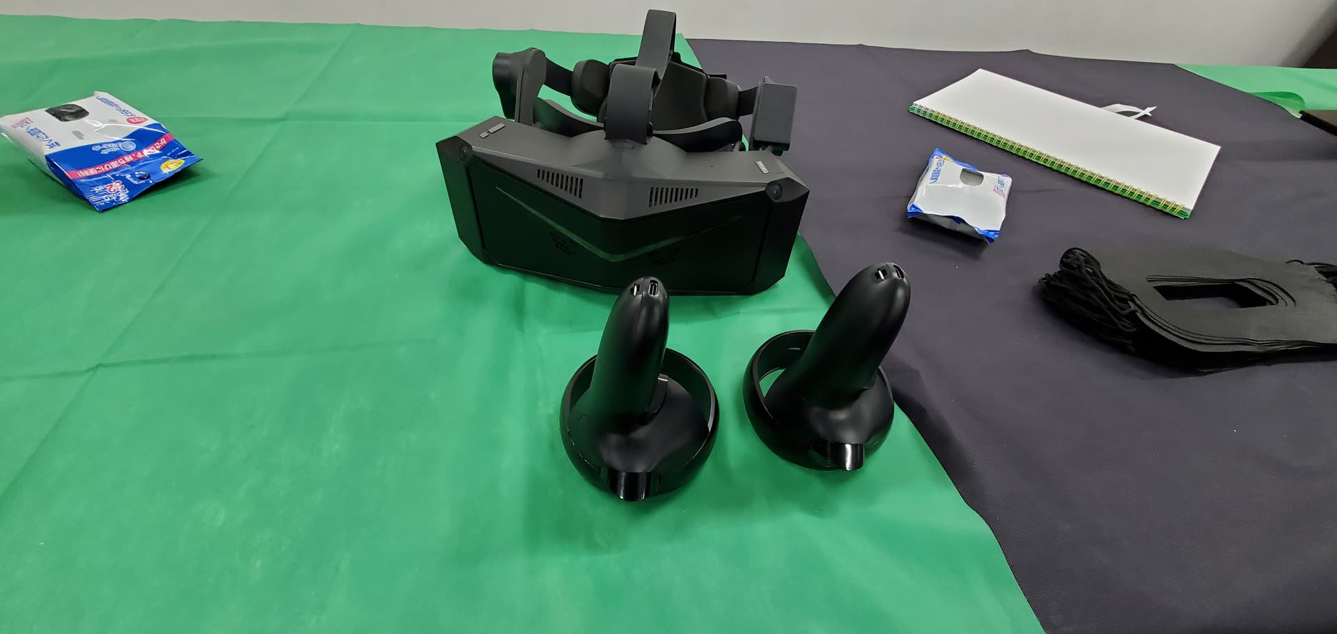

The team were using PCs with RTX 3080s.
Unfortunately there were some issues that impacted us.
  1. DCS was taking forever to load so we wrote that one off.
  2. Elite Dangerous was showing a copy of the same image for both screens, and we didn’t have the time/knowledge to make it work.

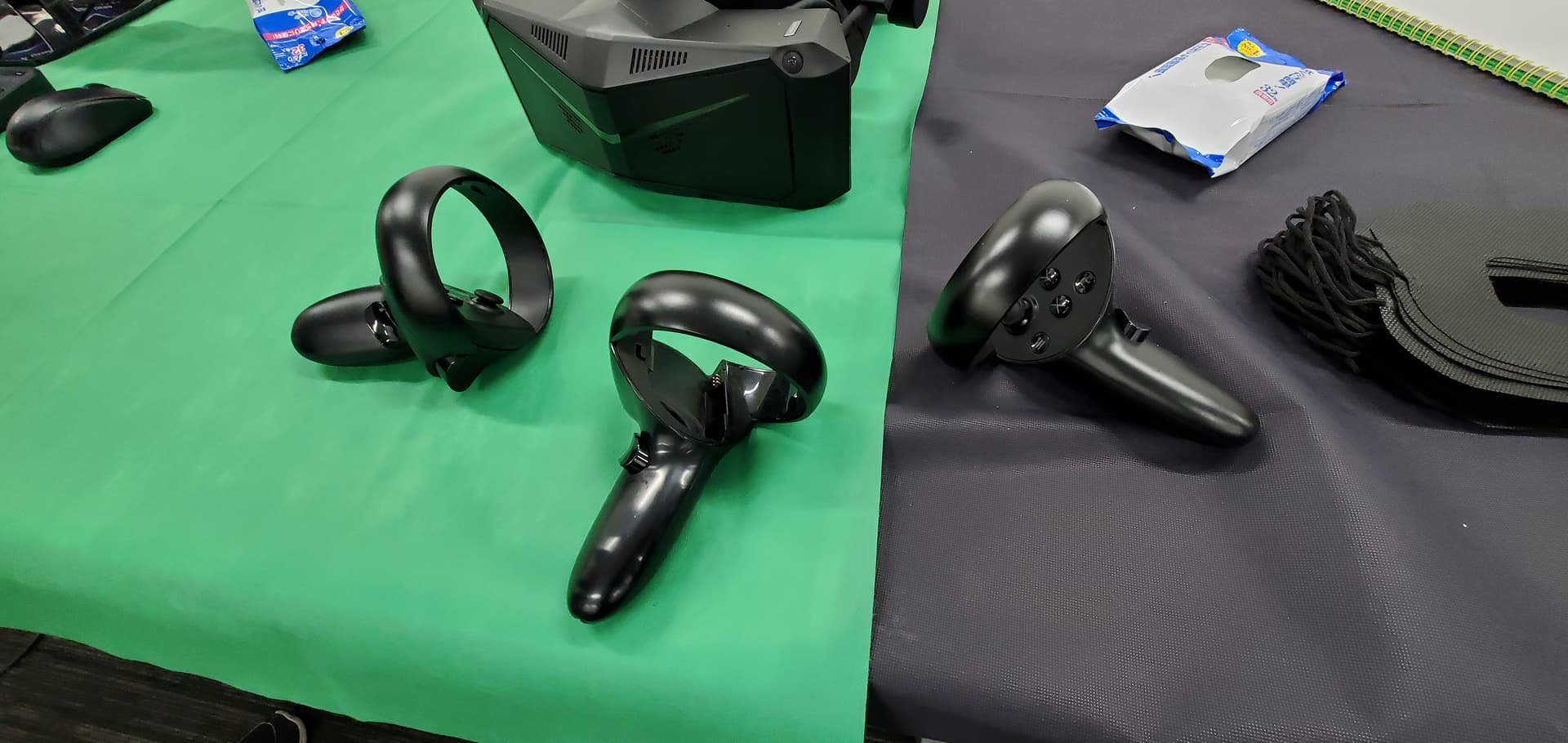

  3. The controllers, when they did work, were quite sporadic and lost tracking often.
  4. Then the controllers themselves just stopped working and even when paired to the PIMAX Software, still didn’t work, and it took the team near 20-30min to get them back to their original state.

Some issues I had:

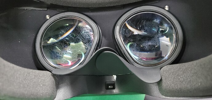

1. LIGHT BLEED INTO THE HEADSET
There was enough light bleed for it to be at times distracting, coming into the headset (between the plastic base that holds the foam molding around the forehead) where the base contacted the plastic surface of the headset itself. Double-checked if everything was in place properly and also on the head. No change.
Recommendation: Create a small recess into the headset where the facial foam component plastic can reside in consistently to avoid this light bleed.

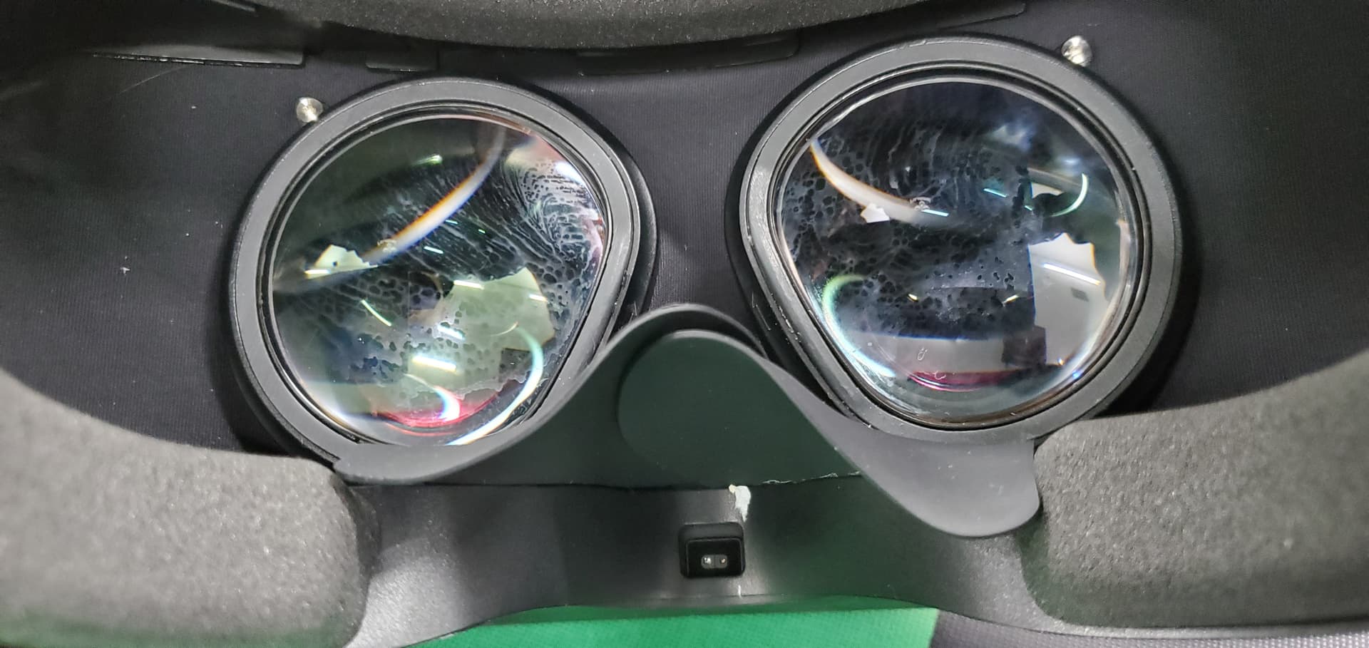

2. DARK SHADOWS TOP/BOTTOM EDGES OF THE LENSES
I could notice in most lighting situations faint darken areas near the edges of the lens top/bottom/left/right. Keep in mind I was on the 35PPD lenses
3. OUT OF FOCUS CLOSE TO CENTER FOCAL POINT
I noticed this mostly in the SteamVR room when looking at titles on the wall, but also in other situations too. When looking straight at the clearest in focal point on the screen, it started to get quickly blurry (Out of focus) the further away from the focal point. This was distracting and I felt like I should have more in my point of view that should have been in focus the same as the focal point.
Perhaps some setting applied where the FFR was very aggressive that caused this (Speculation)

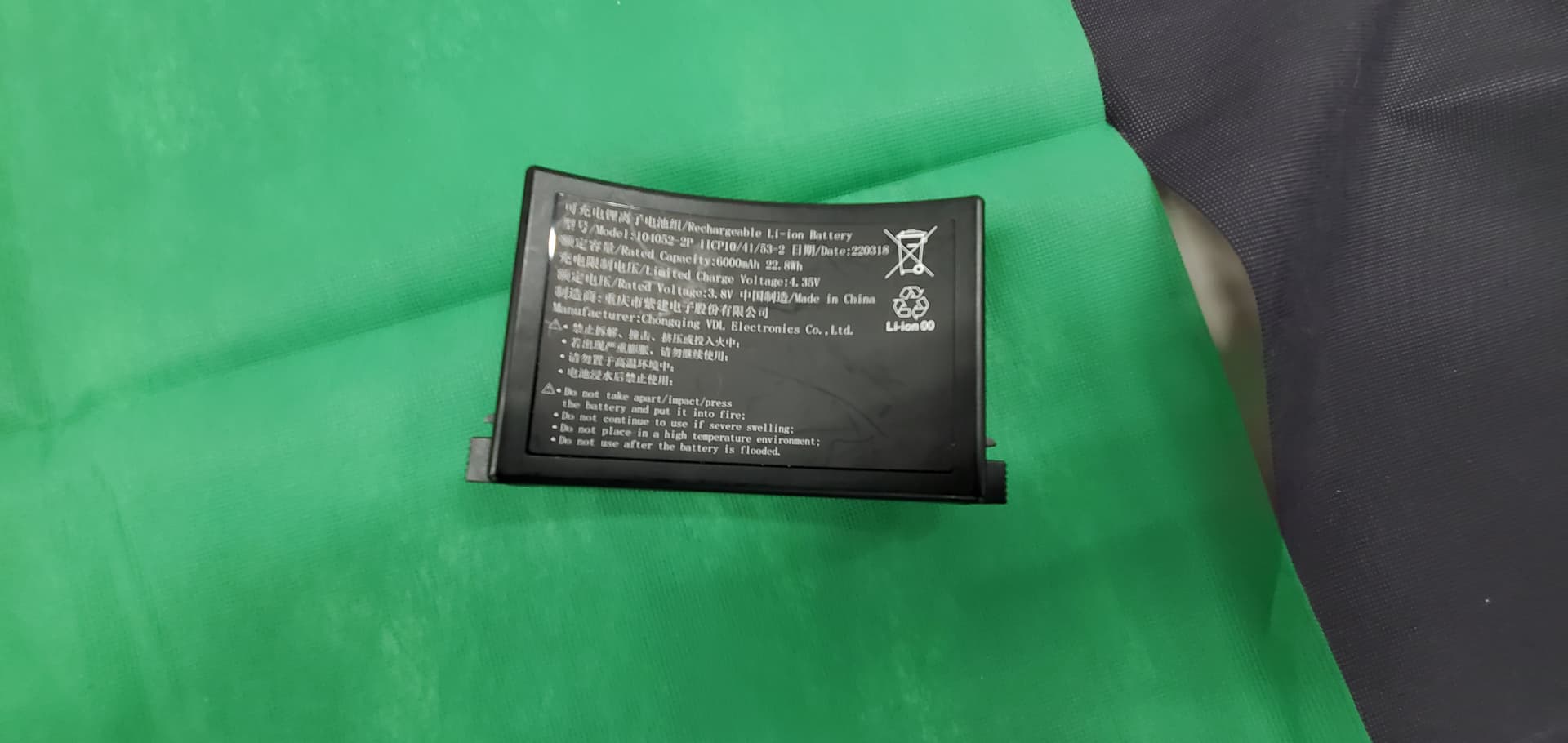

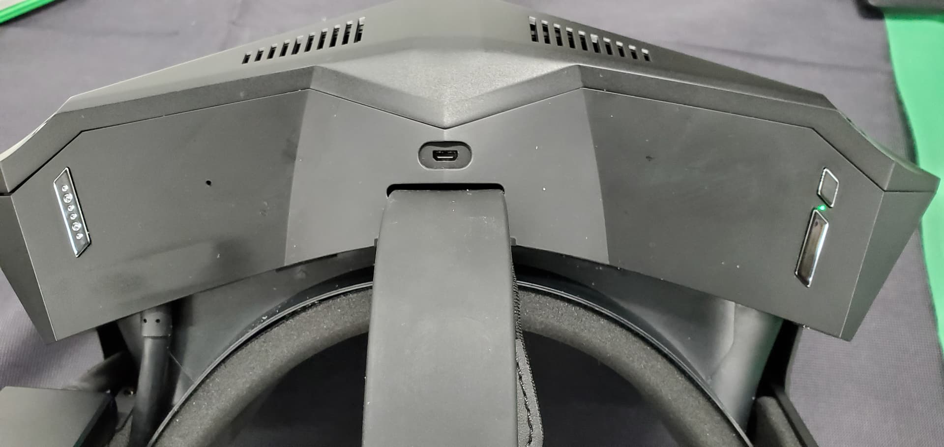

It was further confirmed that there is a small battery in the headset that allows for the function of hot swapping batteries. THIS, I am very happy about and makes total sense. Unfortunately wasn’t able to test it though.

The issue with the controllers not working well (one needed constant plug in to a USB cable) really kinda soured the milk. Since they didn’t have the lighthouse base stations nor faceplate, and after witnessing the tracking issues with the controllers in this current state, simply does not give me confidence that PIMAX’s own tacking solution (QUALCOMM?) is sufficient enough to deliver a necessary quality experience for the user and that the LIGHTHOUSE base stations and face plate will be needed.
What this does is concern me even more, as I am to understand that you couldn’t use the PASSTHRU (special faceplate) with the LIGHTHOUSE controllers at the same time.
If they don’t get the controllers and tracking close to what can be done with the LIGHTHOUSE tech, I fear the user’s likely going to have a frustrating time with the controllers.

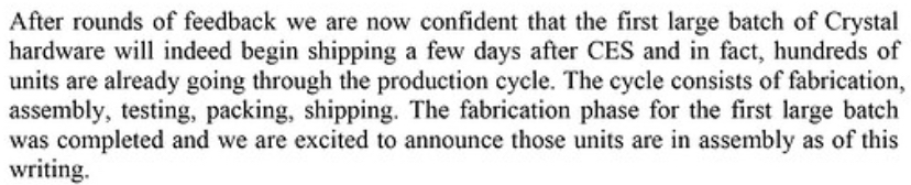

Wait one minute. Pimax have stated -
Why is it if they’re packing finished unit are they still doing roadshows with demo units? Doesn’t this defeat the whole object of showing the thing off?
Pimax are showing features complete.
It’s so strange Pimax confirm features as ready but don’t show them to the public while at the same time packing them for a major release in 3 weeks time.
Why don’t Pimax show at least one Youruber a finished unit? It’s ridiculous.

Also i hope the will get the lighthouse plate very soon so we can use our index controllers with it…
That’s. easy to explain. The Roadshows are in motion and do not have the latest revisions to demo.
So what I’m taking from this is they’re shipping finished products before they’ve shown anyone a finished product. We’ll apart from the units they have at CES.
Not ideal but you could use the OpenVR Space Calibrator tool to use index controllers with the Crystal without the lighthouse cover. Not as reliable but many do it with the Reverb G2 without any major headaches.

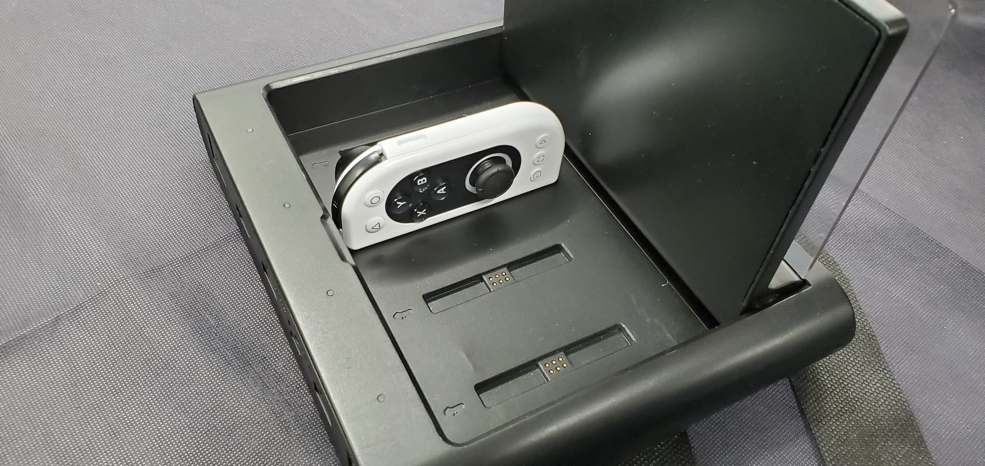

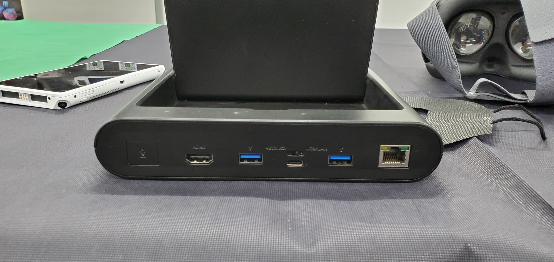

Thanks for the write up and images! Interesting to see the Portal docking station there.

What??? The index controllers dont work with the face plate??? I dont hope so,if thats true i dont want the crystal or 12k anymore…
I hope not because i realy wanted the new pimax headsets…
Also i used open space calibrator wit the hp reverb G2… But thats realy not that realible at all…
So @anon57422158 @PimaxQuorra can we use the index controllers with the crystal or 12k faceplate or not?
But @anon57422158 @PimaxQuorra can we use the index controllers with the crystal or 12k faceplate or not?
Yes you can use the SteamVR controllers with the SteamVR Face Plate.
The Op was referring to he was told you wouldn’t be able to use say Index Controllers with the MR face plate.
