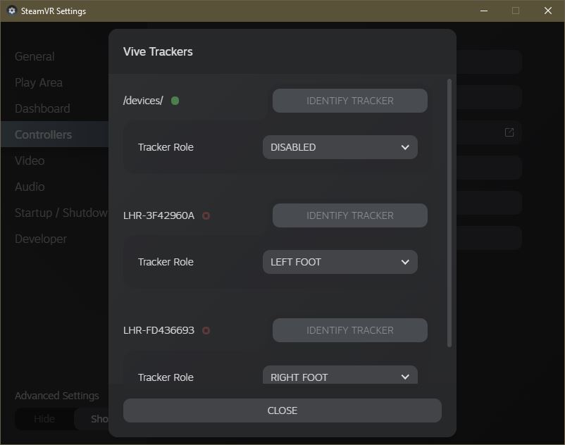

I am unable to individually assign the trackers in SteamVR > Manage Trackers. I’m on 274 and have tried both the Tundra SW5 and HTC dongles, individually paired, in different USB ports, and no matter what I do I cannot assign them individually.
I’ve tried uninstalling and reinstalling both Pitool and SteamVR and both of my Tundra Trackers insist on showing up as a single unassignable entry in SteamVR > Manage Trackers.
The entries below the single entry at the top there pertain to inactive HTC Vive Trackers.

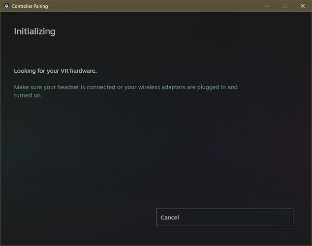

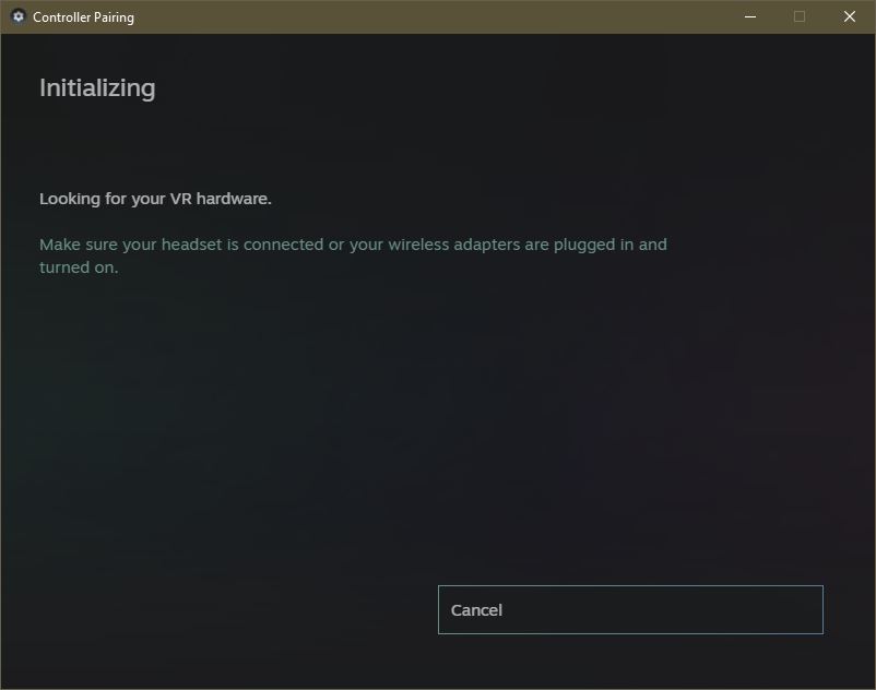

If I attempt to pair the trackers through SteamVR it never goes beyond “Initializing”.
Pulling my Vive Pro 2 out of the closet and reinstalling the respective software and the Tundra Trackers show up correctly with SW5 dongle and can be individually assigned. Unfortunately, hoping that pairing process would persist over to Pimax, when I removed the VP2 hardware and open Pitool it automatically recognizes the trackers and reassigns them as the former single entry, which looks like it does in SteamVR > Manage Trackers only now there are 4 entries beneath it.

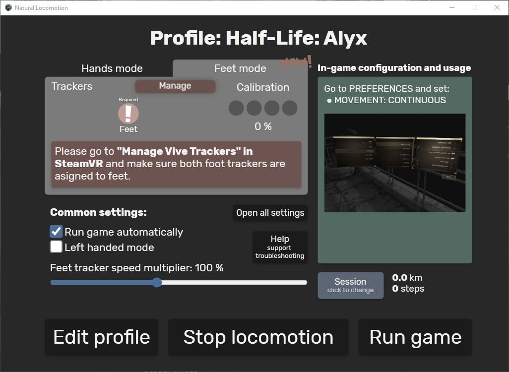

I’m at wits end here, I bought these trackers for Natural Locomotion as this form of movement greatly facilitates immersion in Half Life: Alyx and similar slow paced titles with realistic movement and I found the bulk and weight of the 2018 HTC Trackers uncomfortable.
NaLo cannot work as it needs the trackers individually assigned to feet:
