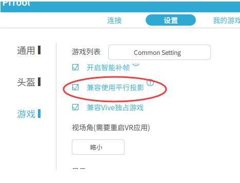

Many feedback pettitte helmet part of the game, the picture overlap, especially some of the domestic game, there are some old version vr games, the games ratio is very low, about 2% of the whole, they try to open “compatible use parallel projection”, found that painting deteriorated a lot of, can’t play, these people tend to use one of the biggest Angle, graphics pressure is great, in this share tips, let the game can be run on image:
First, check “compatible with parallel projection”
Second, adjust the Angle of view for the minimum, the graphics card is good enough, can also be adjusted to ordinary, picture quality or not, adjust the minimum Angle of view
Then, adjust steamvr super sampling to automatic, saving a lot of trouble
Finally, restart the helmet, or restart the service, before entering the game
You will find that the picture quality is very good, although it can only run from a small perspective, it is only a 110 degree perspective. Like HTC, the game compatibility of pettitte’s helmet is now 100%
In addition, I found that after opening parallel, change the normal perspective, some past can not open the game can also play, is to open the second to return the kind of, if still not, you can open a small perspective, at the same time directly in pitool set picture quality, appropriately reduce the picture quality.
In addition, some games can set the picture quality inside, I found that in that game set high picture quality, the result is black screen, set medium picture quality can run normally, if not set low picture quality.
Anyway, several methods in accordance with the use of order, really can not be used together, so far I have not encountered a game can not open, and the overall picture quality is good.
In addition, after setting up, you must restart the helmet, otherwise the setting may fail

很多人反馈小派头盔部分游戏,画面重叠,尤其一些国产游戏,还有一些老版本vr游戏,这类游戏比例很低,整体大约2%左右,他们试着开启“兼容使用平行投影”,结果发现画质变差很多,根本不能玩,这些人往往用的最大视角,显卡压力极大,在此分享小技巧,让这些游戏都能完美画质运行:
首先,打钩“兼容使用平行投影”
其次,调节视角为最小,显卡够好,也可调整为普通,画质还是不行,调最小视角
然后,将steamvr超级采样,调节为自动,省事很多
最后,重启头盔,或者说重启服务,再进入游戏
你会发现画质变得非常好,虽然只能小视角运行,但也只不过是110度视角而已,和htc一样,现在小派头盔游戏兼容性变成100%了
另外,我发现开平行之后,换普通视角,一些过去打不开的游戏也能玩了,就是打开秒退那种,若还是不行,可以开小视角,同时直接在pitool设置画质,适当降低画质即可。
另外,有的游戏内部就能设置画质,我发现在那个游戏里设置高画质,结果黑屏,设置中等画质又能正常运行,若还不行设置低等画质。
反正几种方法依顺序使用,实在不行一起用,就目前我还没遇到一个打不开的game,并且整体画质还不错。
另外,设置好之后,必须重启头盔,否则设置可能失效
