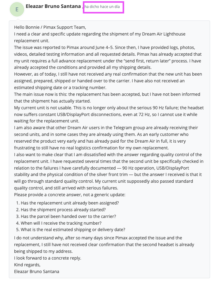

There is also a physical build-quality issue: the silver V-shaped front trim of the headset has started peeling off after very limited use since receiving the unit. I have photos showing this and I also reported it in the official support ticket.
My current interpretation is that since the issue is reproducible with multiple Pimax Play versions and also when using native SteamVR through SBoys3 / Custom Headset, this may point to either a hardware/display issue or a firmware-level issue related to 90 Hz operation.
